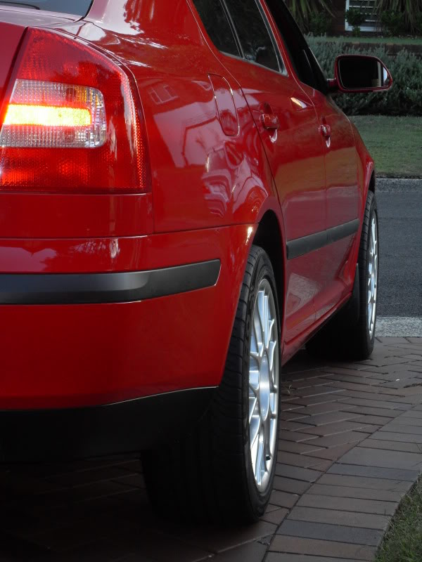

This is 8" ET35.  9.5" ET40 will be 14mm further out.
You will also be 14mm closer to the strut than the OEM 7.5" ET50 wheel.
