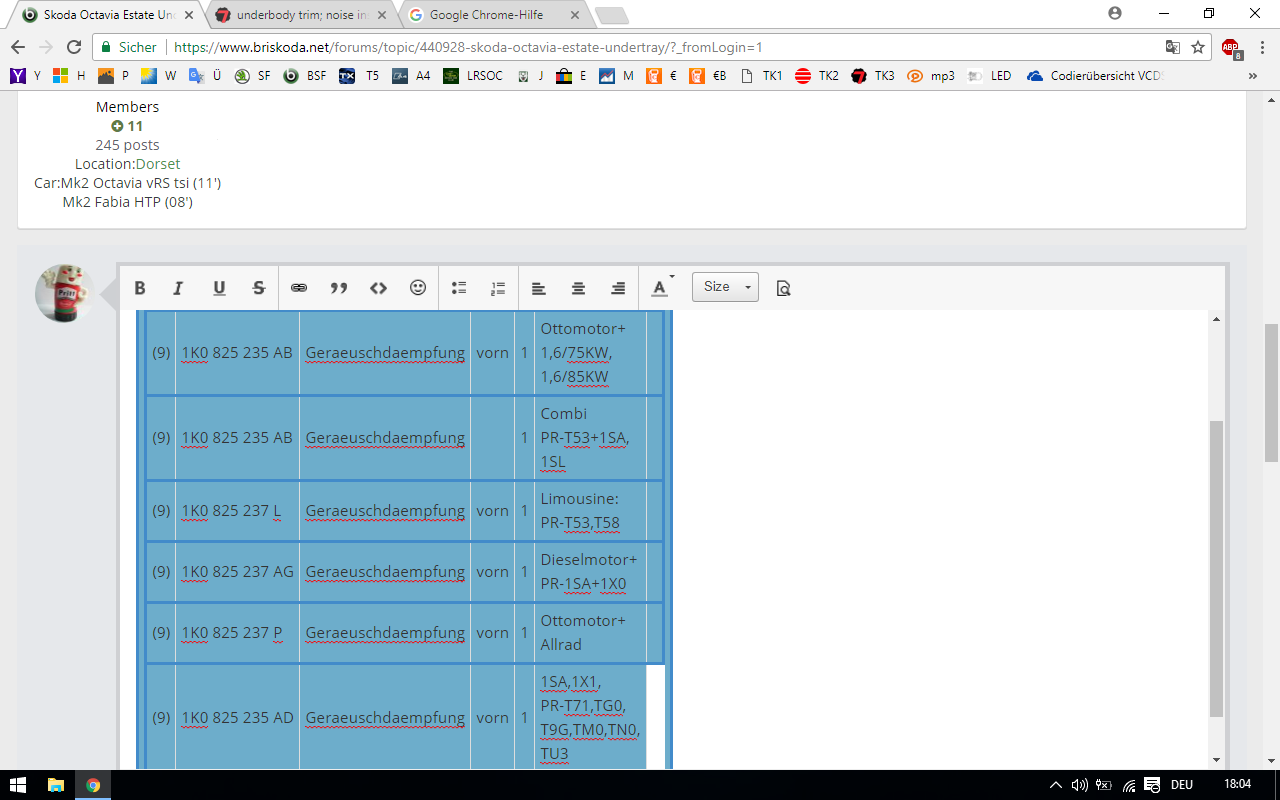

K0 825 237 K noise insulation front 1 T59,TD6
(9) 1K0 825 237 K noise insulation front 1 sedan:
PR-T1Q,T72
T59,TT1,TQ2
(9) 1K0 825 235 AB noise insulation front 1 petrol eng.+
1,6/75KW,
1,6/85KW
(9) 1K0 825 235 AB noise insulation   1 combi
PR-T53+1SA,
1SL
(9) 1K0 825 237 L noise insulation front 1 sedan:
PR-T53,T58
(9) 1K0 825 237 AG noise insulation front 1 diesel eng.+
PR-1SA+1X0
(9) 1K0 825 237 P noise insulation front 1 petrol eng.+
4wd
(9) 1K0 825 235 AD noise insulation front 1 1SA,1X1,
PR-T71,TG0,
T9G,TM0,TN0,
TU3
If you are buying 2nd hand, VW Golf undertrays fit too.  You can get half trays & full trays
