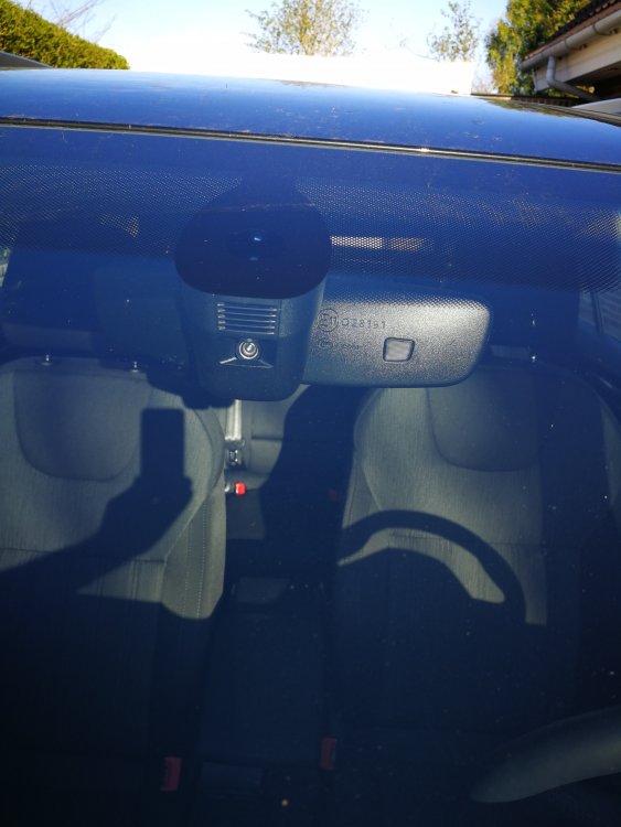

Hi.
I have still not found out if my car can be reprogrammed to have lane assist and Sign reconition.
I have attached picture of my camera.
Can anybody see if this maybe is possible ?
Thanks

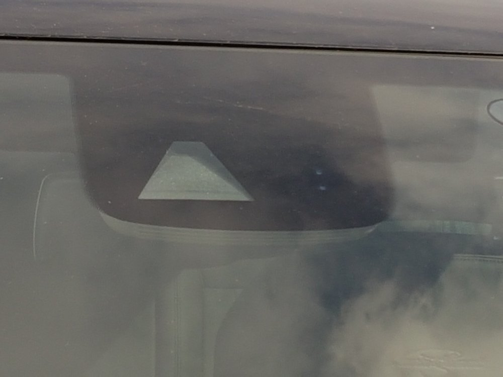

No, that's the smaller camera, you can't get TSR or Lane Assist on this. Generally speaking, you specify lane assist and get the camera, then code other options in. The lane assist camera is huge and lives in a triangle shape housing behind the screen. I'd take a picture of mine, but the car is in a car park a long away from my office. If nobody else does by the tie I get home, I'll do it :)

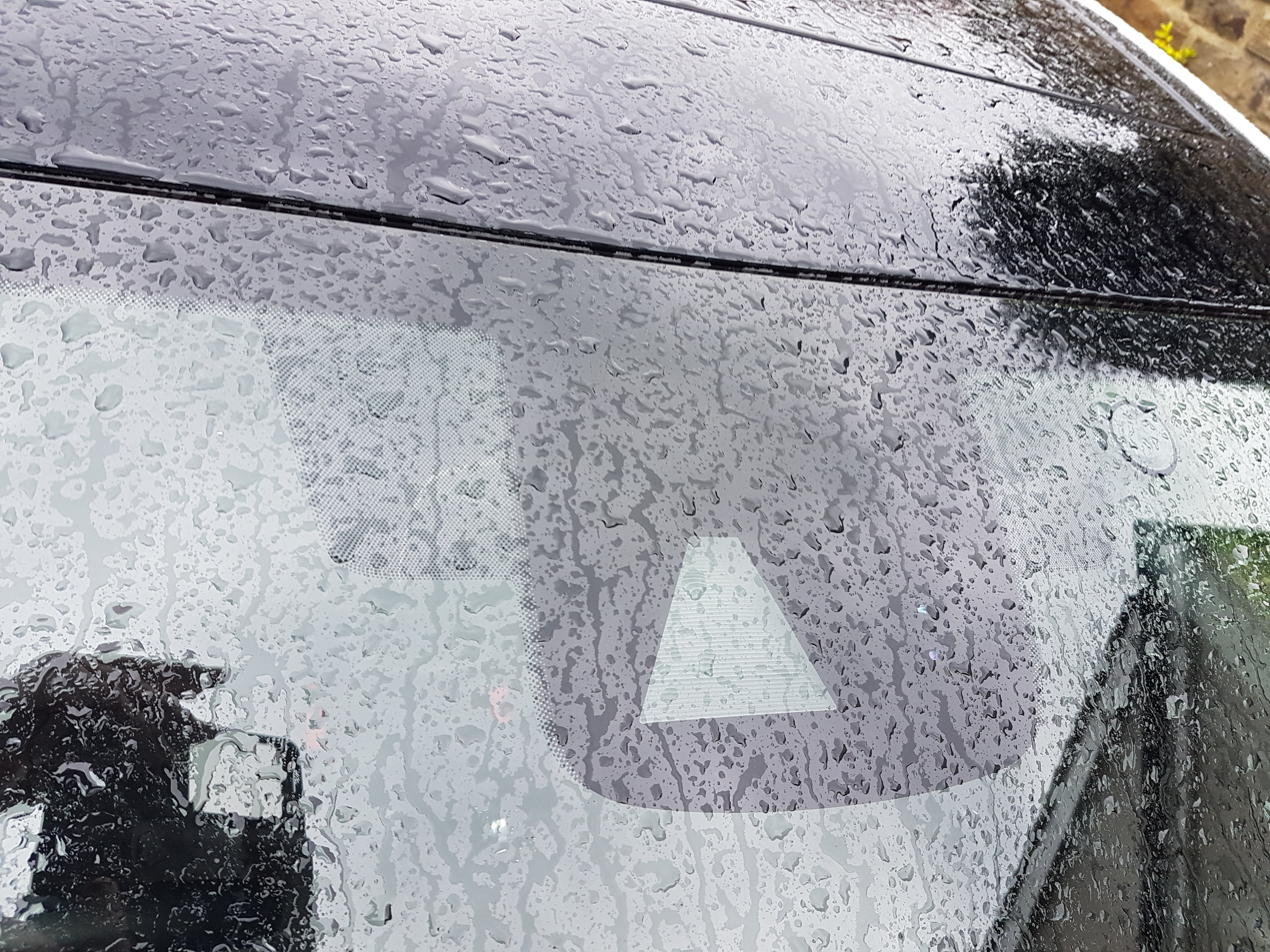

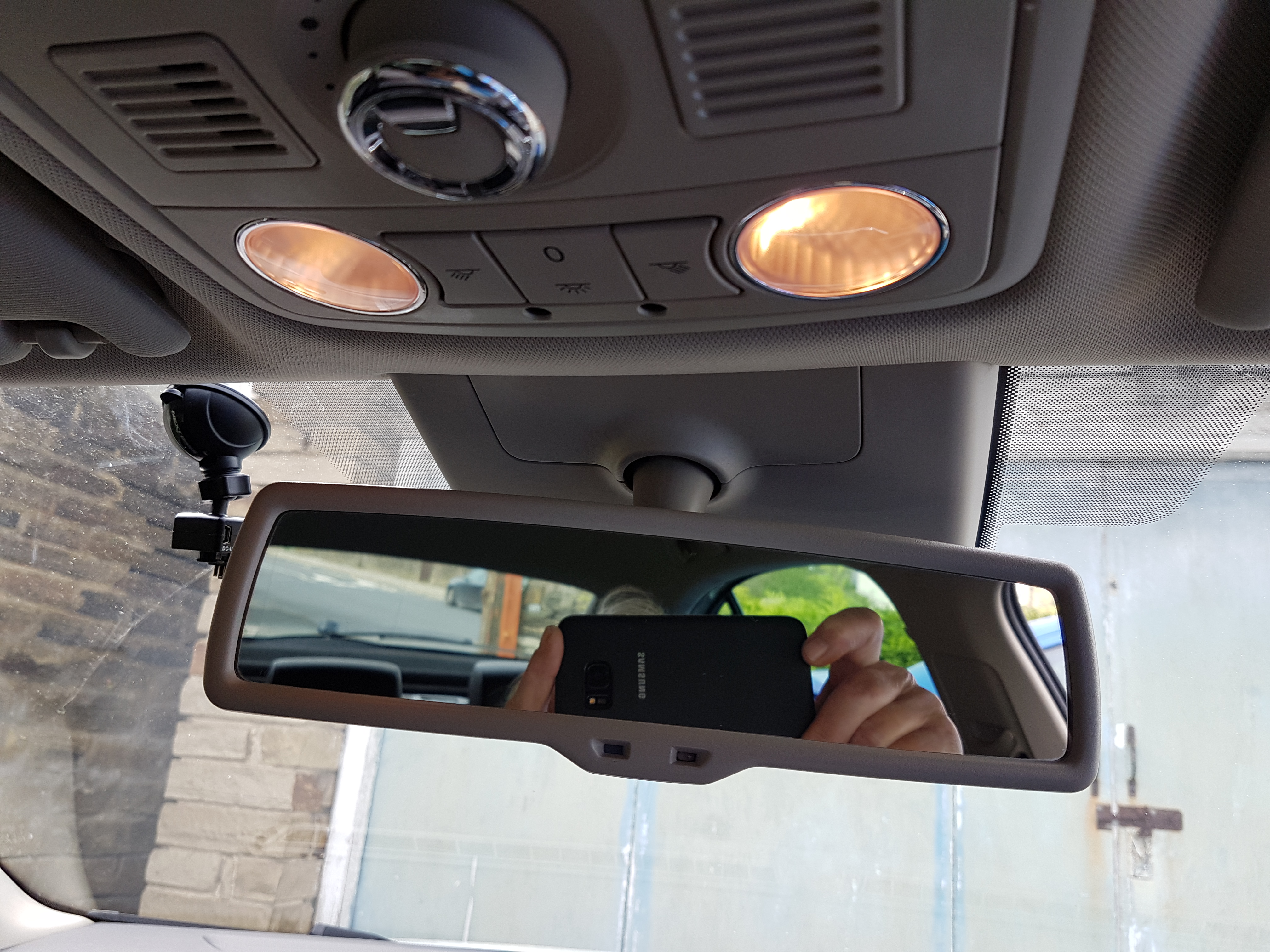

Here's an exterior and an interior shot of the camera that has lane assist and can be coded for TSR
Should have added that these images relate to a pre FL L&K MODEL with sunroof
Others will let you know if that makes any difference
Pretty sure my 245's hangs a little lower than that....
Think it looked odd from the angle I took photo from
Here's one that shows it better (in the rain)
yup, that is what we need. Where can we buy it?:)
Sorry can't help on where to buy, but sadly I think the windscreens are also different depending on what camera is fitted
The dark area surrounding the "triangle" that the camera views through is embossed on the glass I believe
