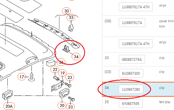

despite having found the correct picture of the clip on an online etka, when I search for the code it shows me the wrong thing.
https://skoda.7zap.com/en/cz/octavia/oct/2002-252/8/867-867055/#34
I am looking for number 34 in the picture, which is the clip.  However when I use the code provided it just shows the blue circle clip which I do not need.  Can someone help?
The code I get out of ETKA is 1U0867280 , but like I said, it is not the clip I am after,

I've had a couple of looks at my headlining for you and have come to the conclusion that the parts diagram is slightly misleading. Item 34 are the blue circular clips but look oblongish in the picture. On my car, a 2004 vRS, they are, indeed, blue circular clips that clip into pegs of item 30. Item 30 is the long piece of plastic trim and the only separable part on it are the metal spring clips, item 33. These spring clips slide onto the appropriate grooves in the long trim and then the lot is banged into the roof to hold the headlining up. On removal, the metal spring clips end up staying in the roof.
The shell is being taken away tomorrow evening (5th July), so if you need items 30 or 34 (33 are fiddly to remove and I won't have time), then shout now or forever hold your peace!
