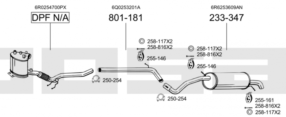

Given that there appears to be NO problem with the DPF or the Catalytic converter, I would still require a front pipe that includes the DPF (over £1000 plus VAT) and a middle pipe that includes the catalytic converter(didn't even price that one!!)!
Absolutely unbelievable. Am I missing something, or is Skoda (VAG) taking the almighty p1ss???? And why does the design of these pipes not include joints at appropriate positions so the pipes can be renewed without changing the DPF and cat. when they're clearly not needed?

Typical (although not identical) from Bosal . . . and as you can see: No joint and "N/A".... (only from Skoda) for the front pipe.5b1d844dd42d5_FabiaIIExhaust.thumb.PNG.218e4217bf696d947fc571e7baaaea64.PNG
