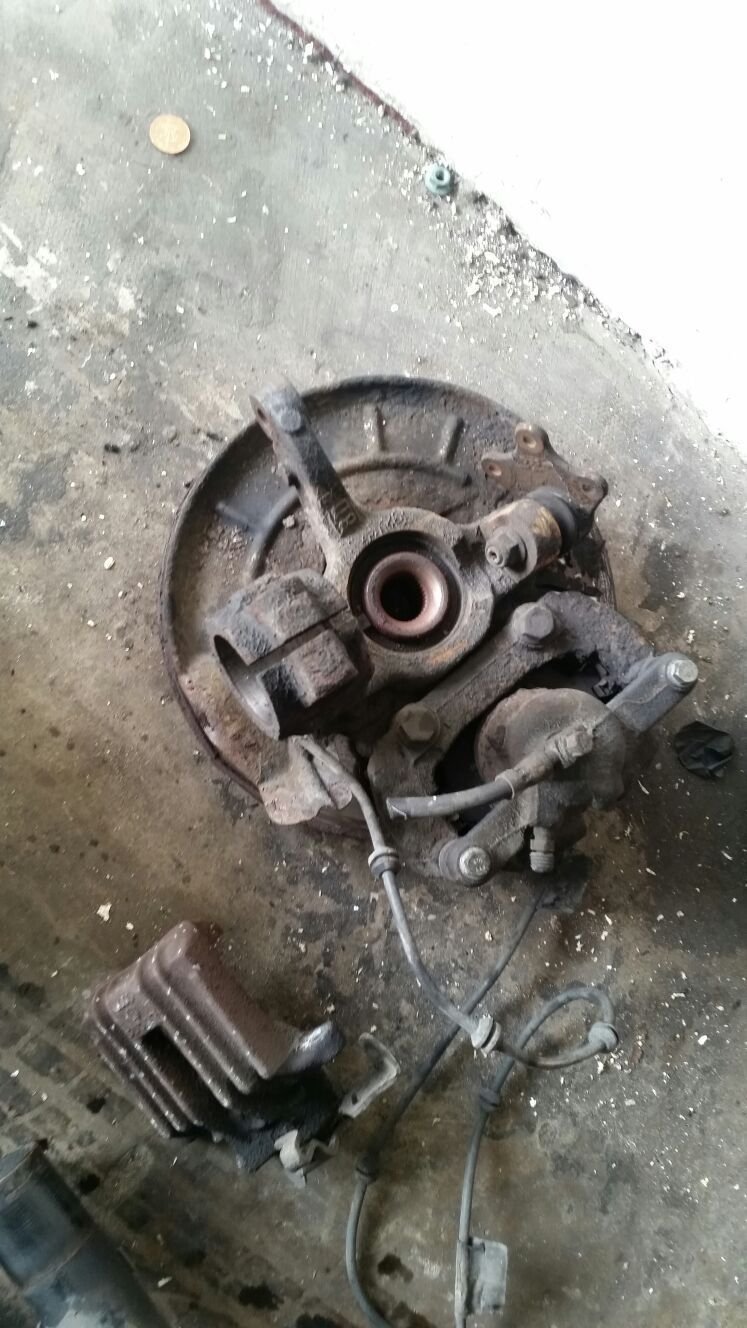

Hi All! This is my first time posting on Briskoda, I have been a long time lurker and have decided to contribute back to the community having used a number of the "How To" guides hosted here.    The first thing many of us do to improve the handing is lowering the car using springs, but this has a drawback in that the lower control arm now sits at an angle that reduces camber as the strut compresses during corning. This is a "feature" designed into all the PQ24 platform vehicles (F
