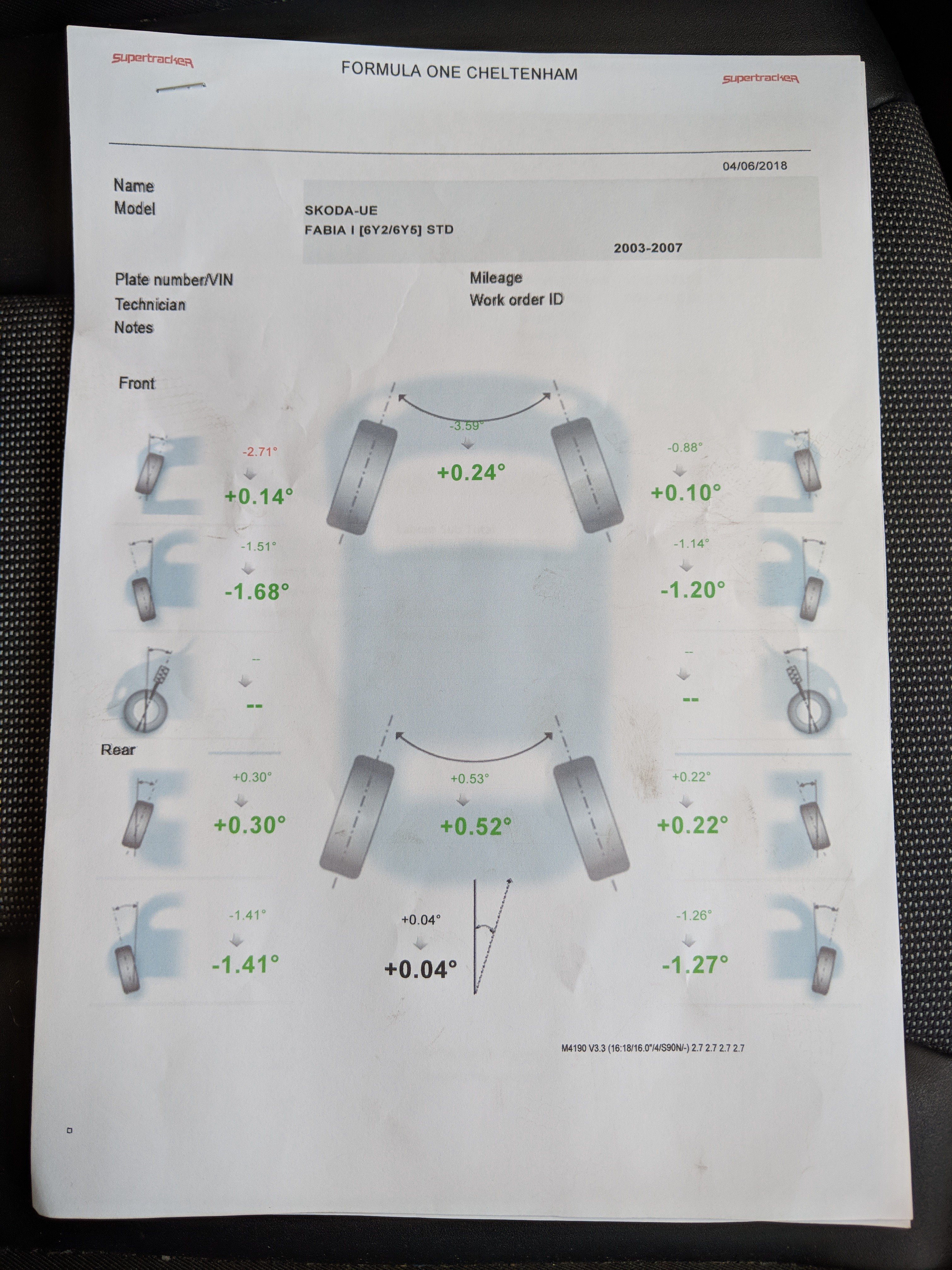

So here are figures for a standard Fabia fitted with just TTRS lower ball joints. The camber is now at about -1.5 (with me sat in it). Unfortunately the alignment machine didn't print out the castor reading for us to see.

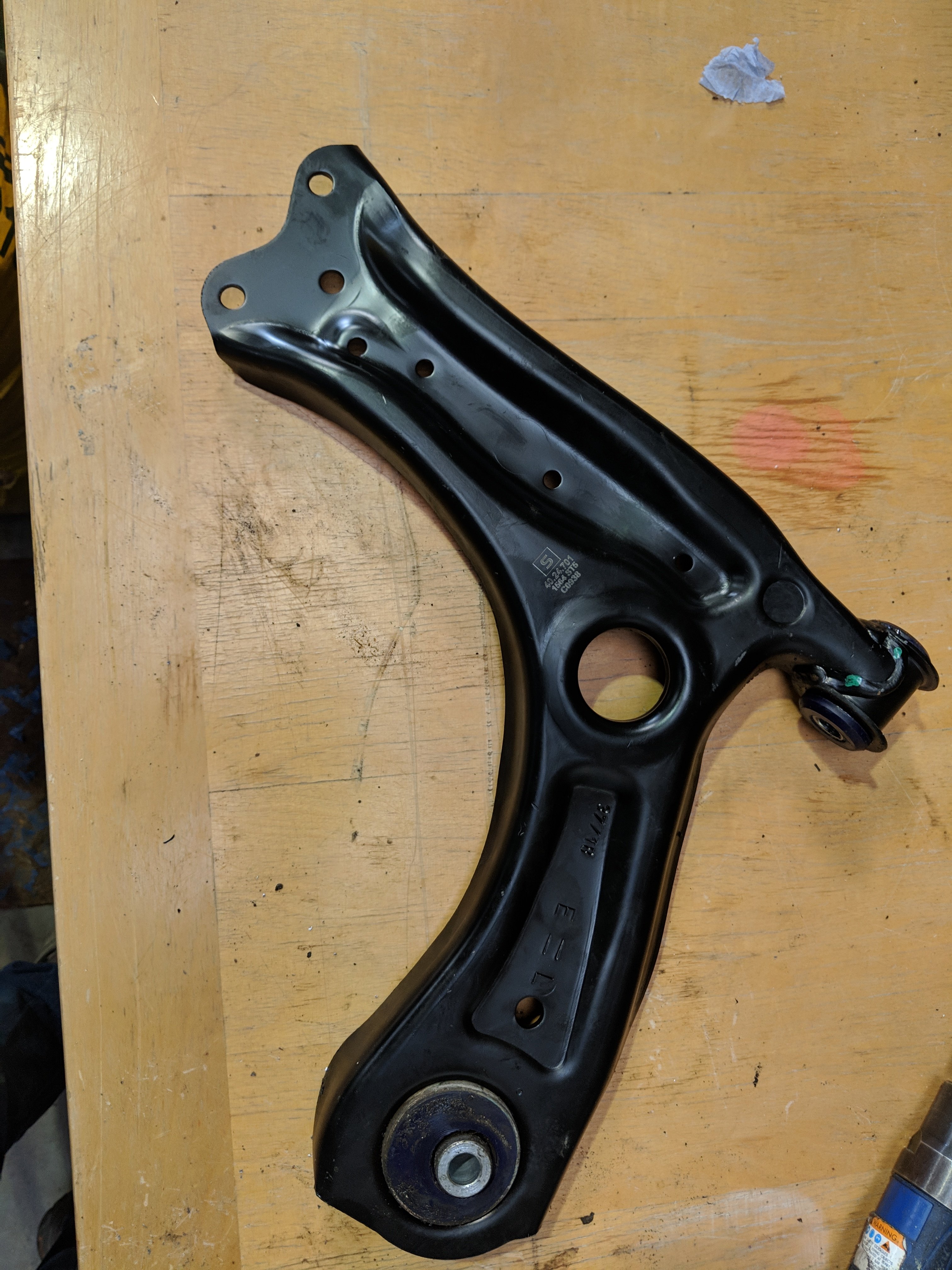

So I've been running this setup for a couple of months now to prove the concept and after having to change a bent lower track control arm decided to document the installation should anyone else want to try it.
First we start with a new arm to modify. I transferred across the poly bushes I had fitted, noting the rear is oriented for maximum castor (you will see this becoming a theme later on)

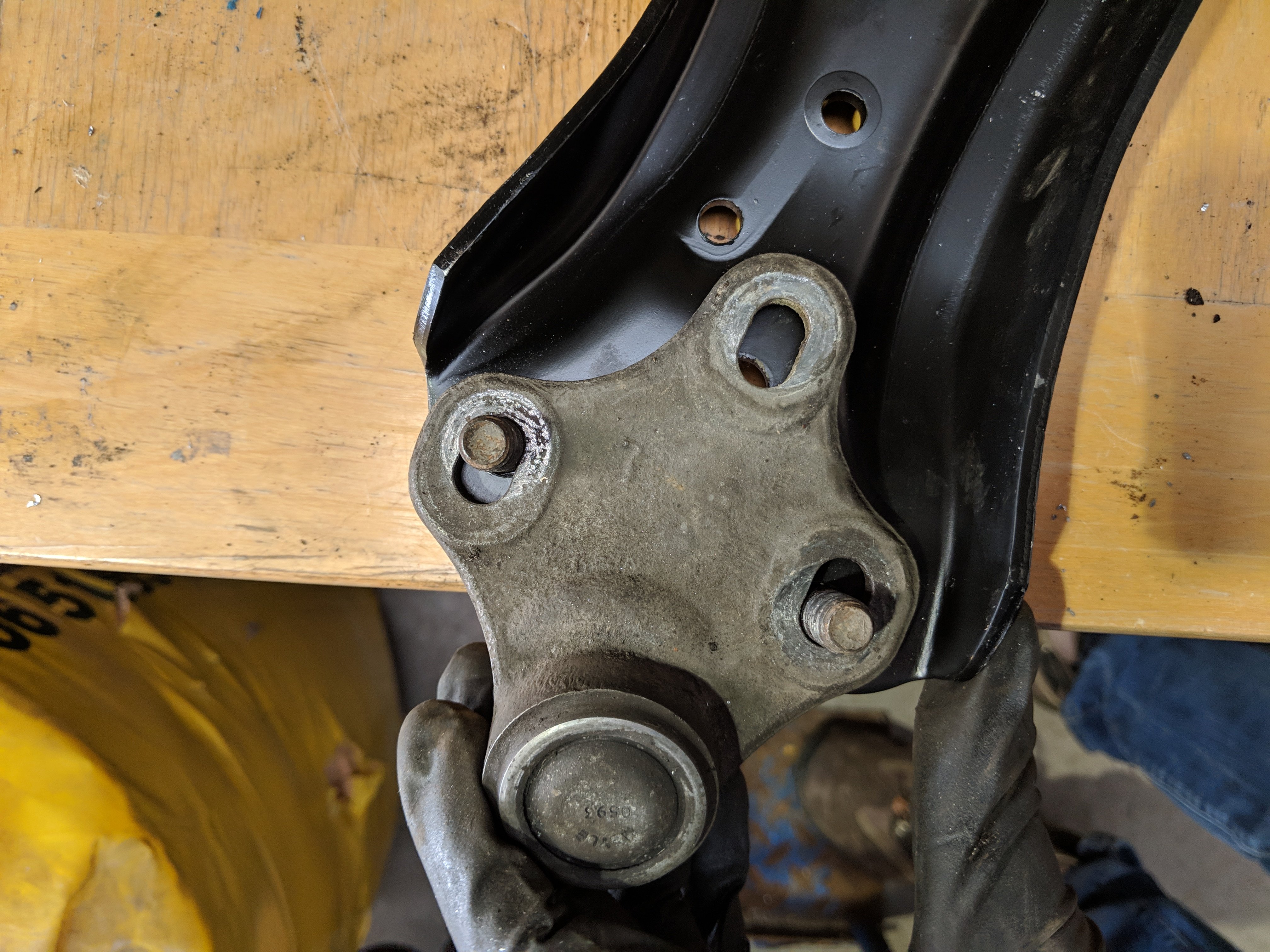

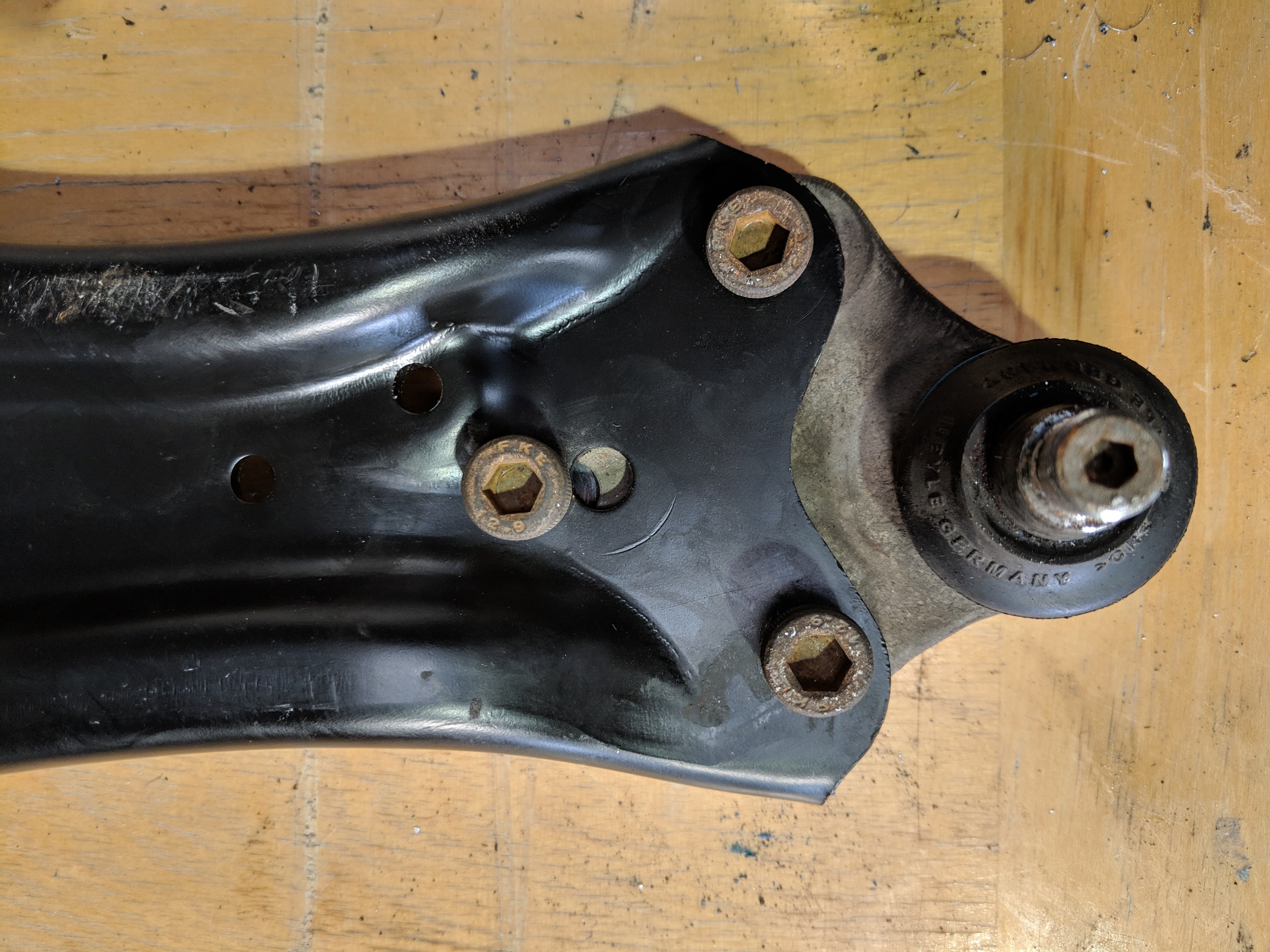

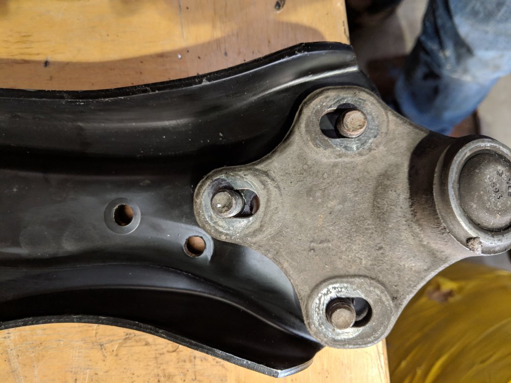

Next we need the Audi TTRS ball joint to size where to drill the new mounting holes. I dropped the bolts through the 2 holes that line up and pivoted the ball joint forwards so that both slots were bottomed out (maximum castor position). I knew from a few months ago that this position would give about -1.5 degrees of camber on a standard car and I don't believe it needs any more than that for a fast road setup. It is possible to achieve more camber by pushing the ball joint fully outboard but this is at the expense of castor. Now we can see the third bolt is going to need some room before we can drop it in, this is where the step drill comes into play!

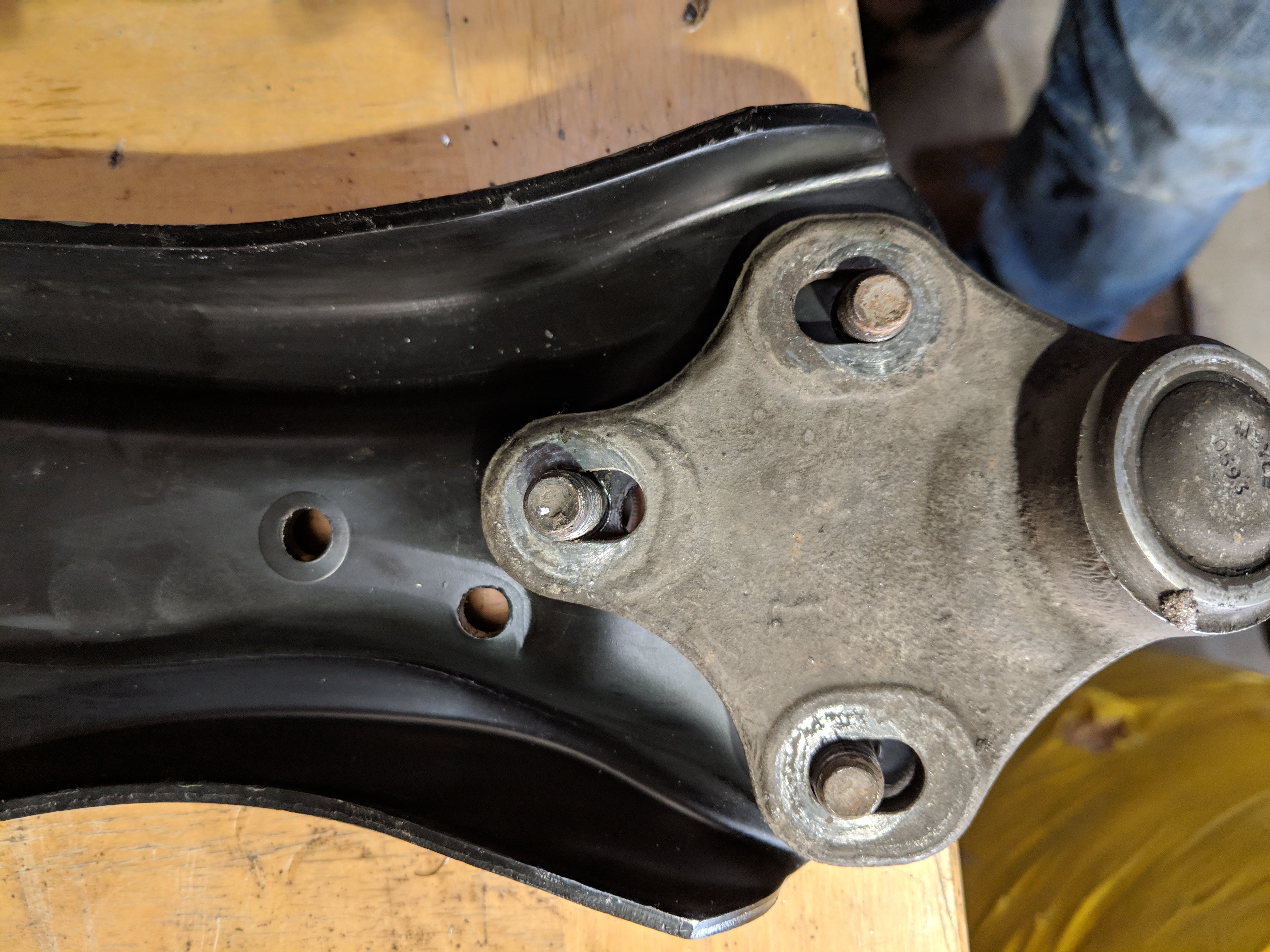

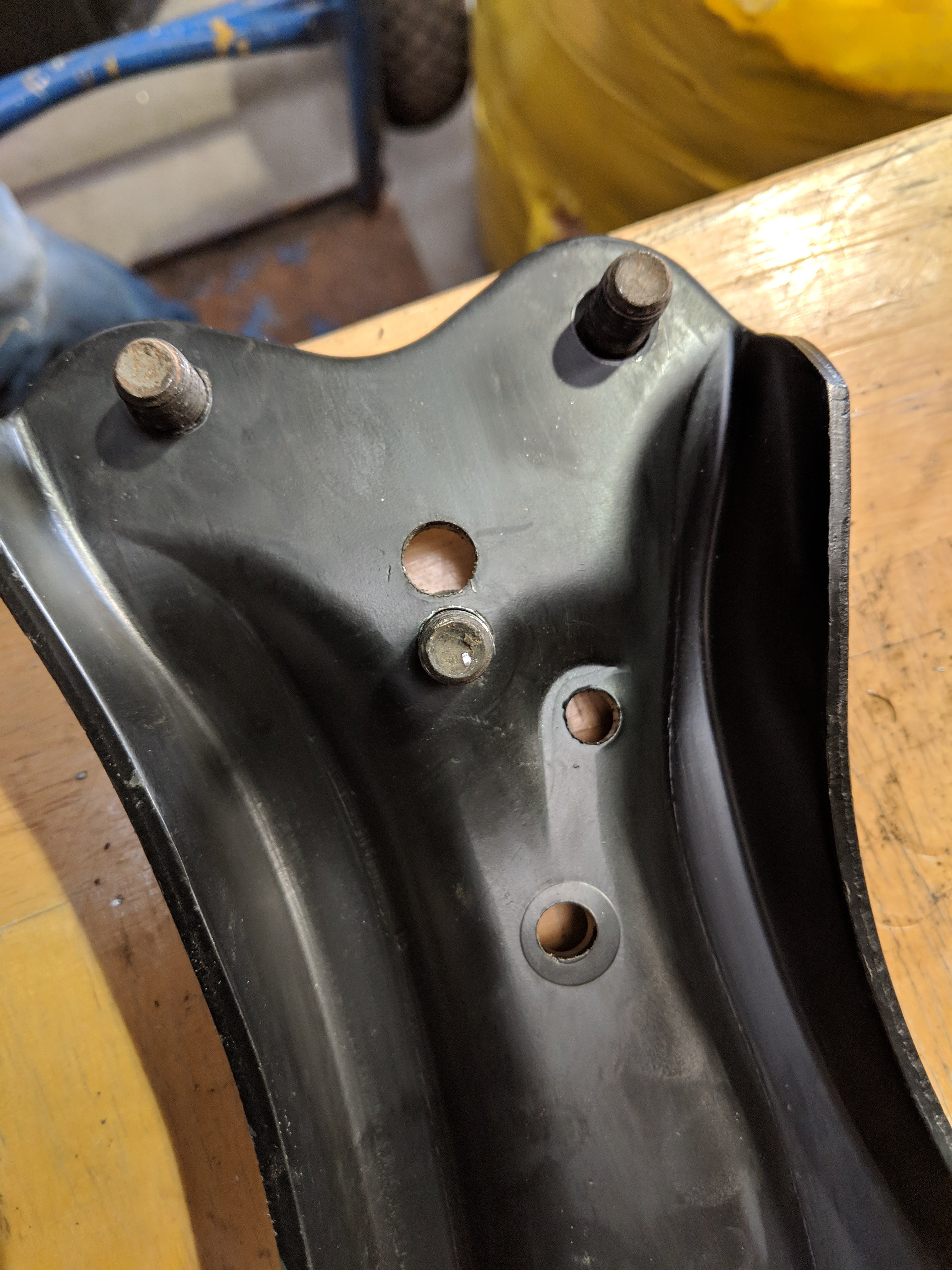

Here you can see the new 10mm hole drilled to accommodate the third bolt. Because of the increased size of the ball joint mounting area you will have to bolt it up from the bottom of the track control arm. And for those of you worried about the strength of this arrangement, I had the unfortunate luck to clobber a monster pot hole earlier this week that bent the arm without shifting the ball joint mount or bolts at all.
Here is the ball joint fitted with a set of M10 grade 12.9 cap head bolts using the TTRS nuts that came with it.

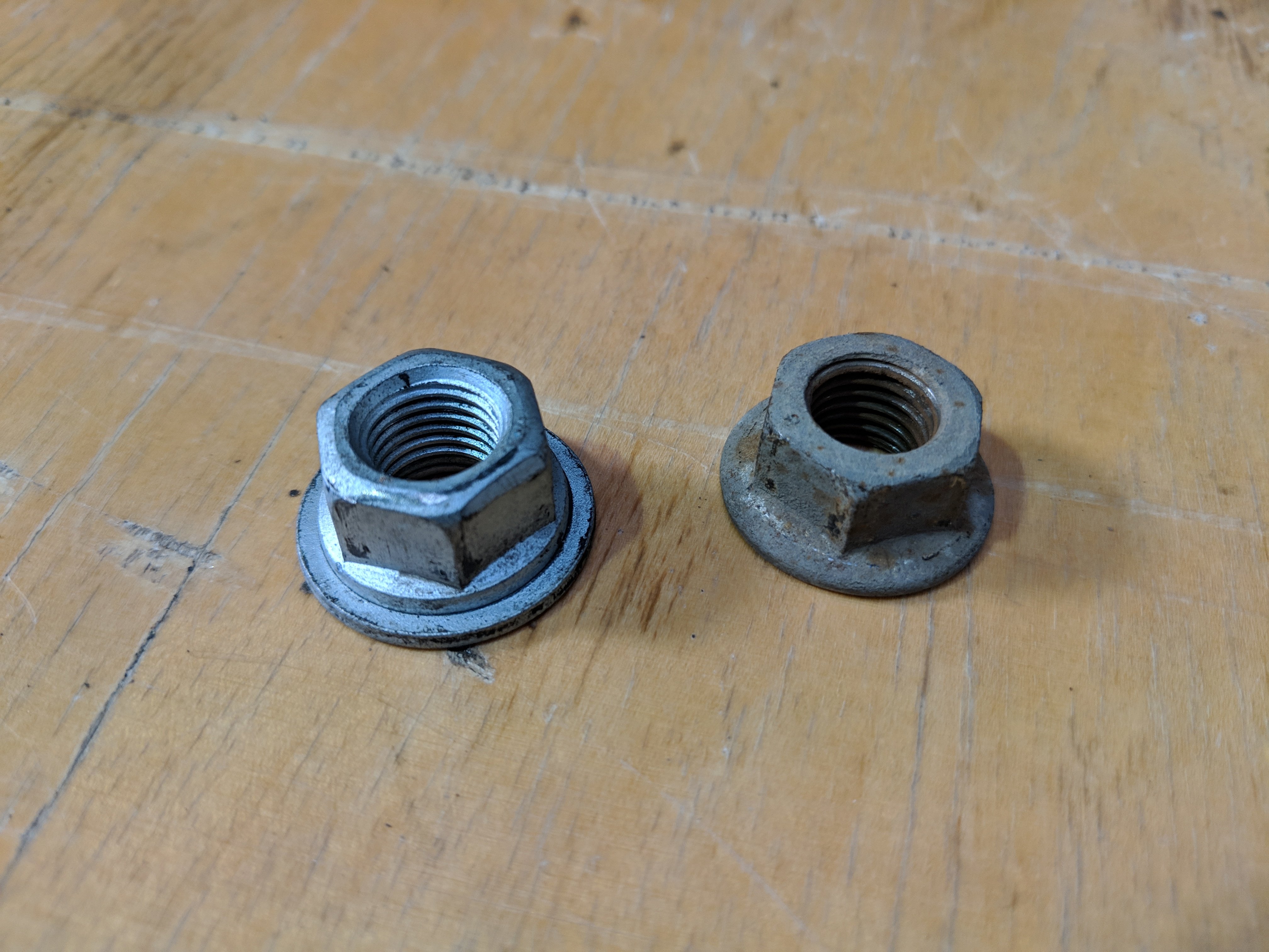

If you are doing the ball joints along with the Audi S1 (quattro) hub carriers the you will need to use the standard Fabia nut to mount the tapered portion to the lower mounting point as the machining there is not wide enough to take the TTRS nut.
Fabia nut on the left, TTRS nut on the right:

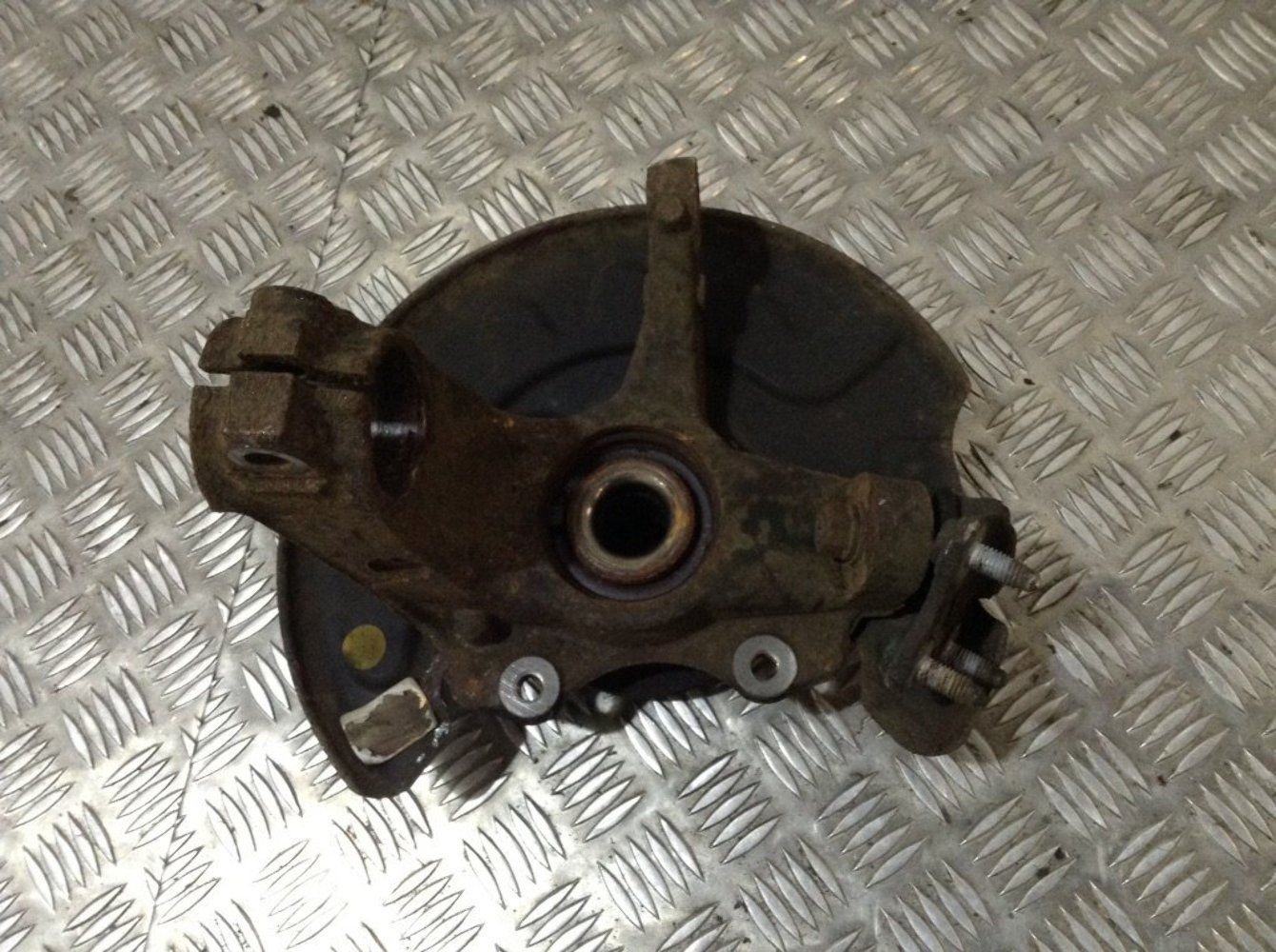

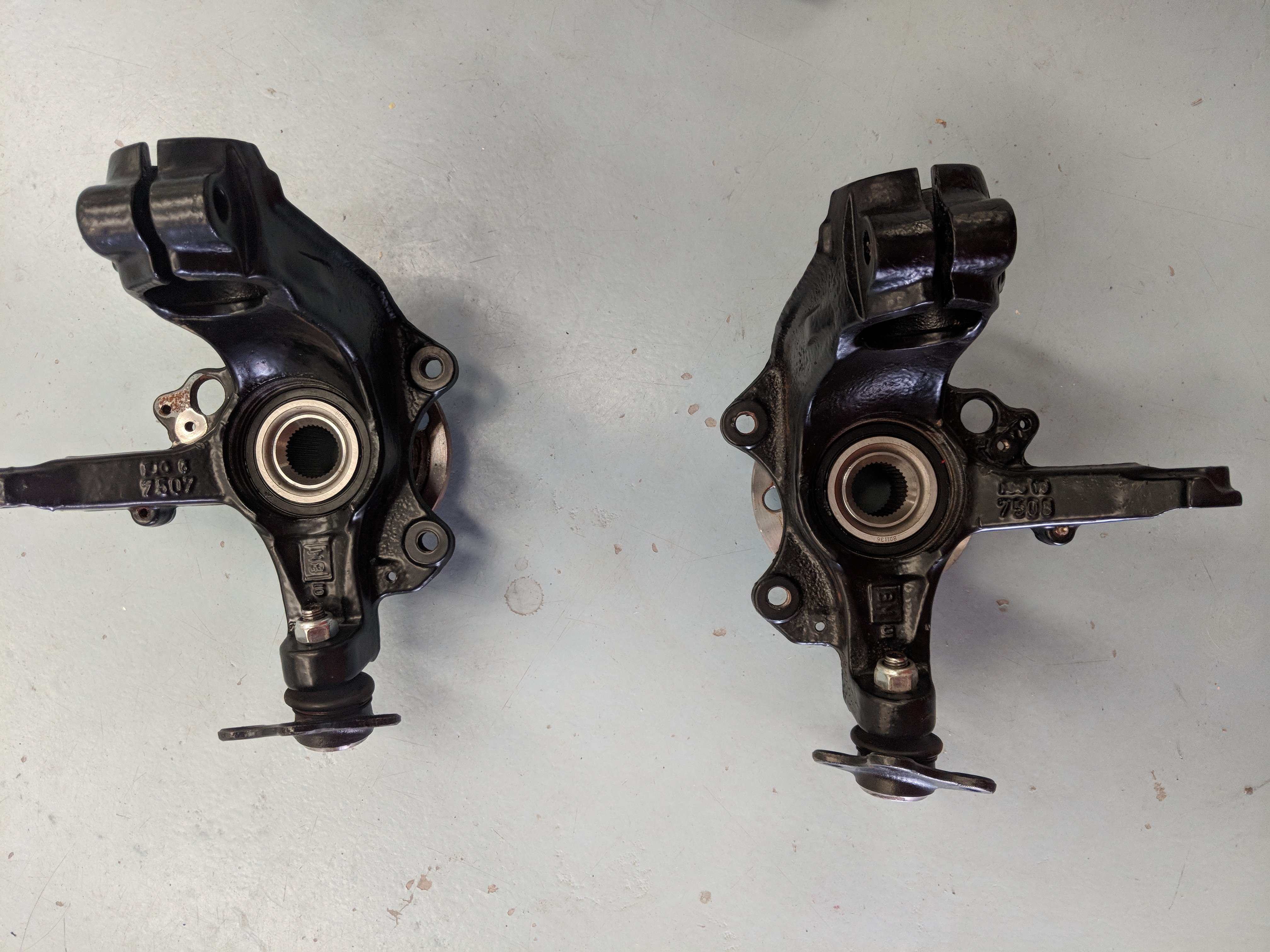

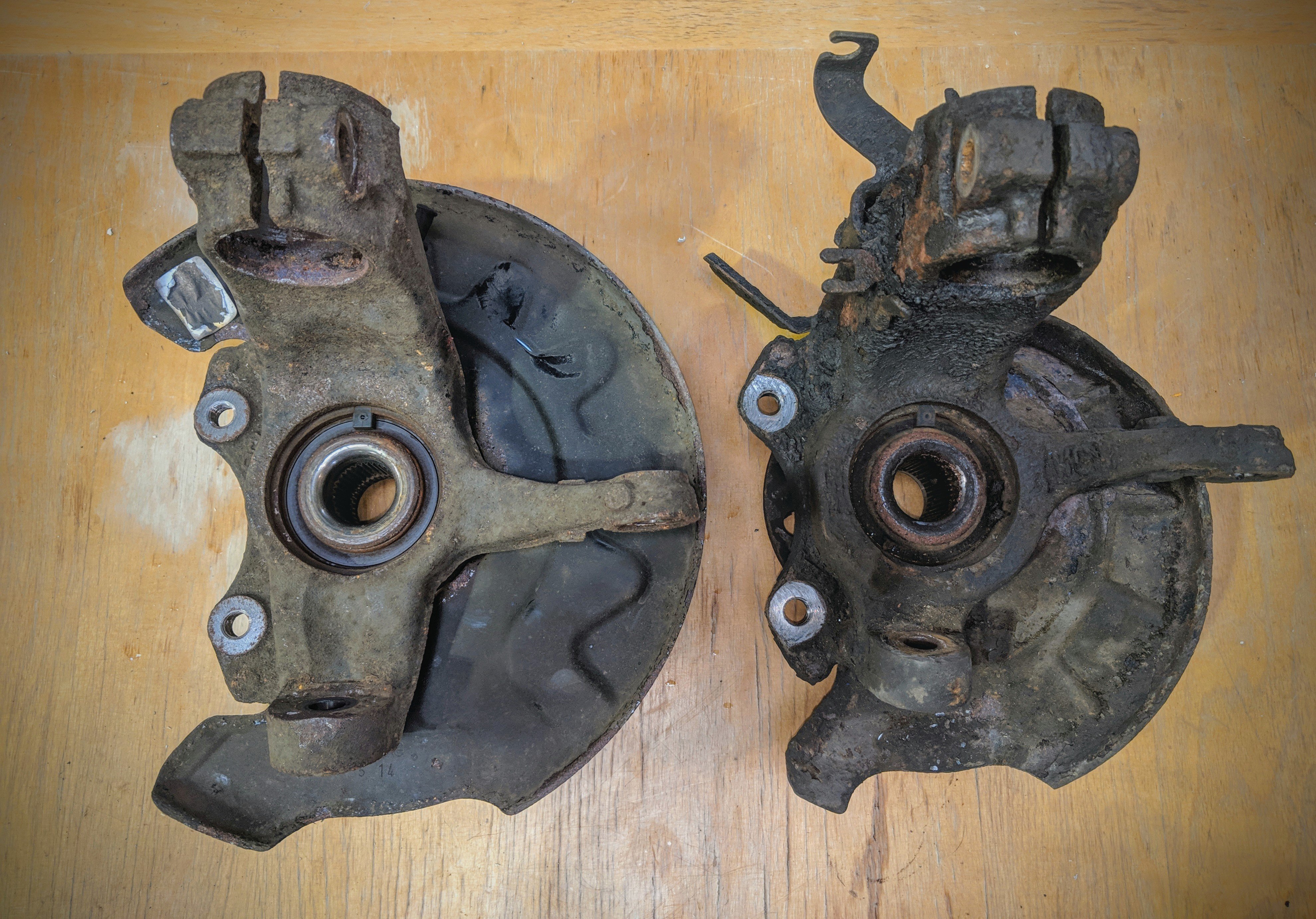

And so the question is what are the benefits of the Audi S1 quattro hubs (on the left) over the standard Fabia hubs (right)?

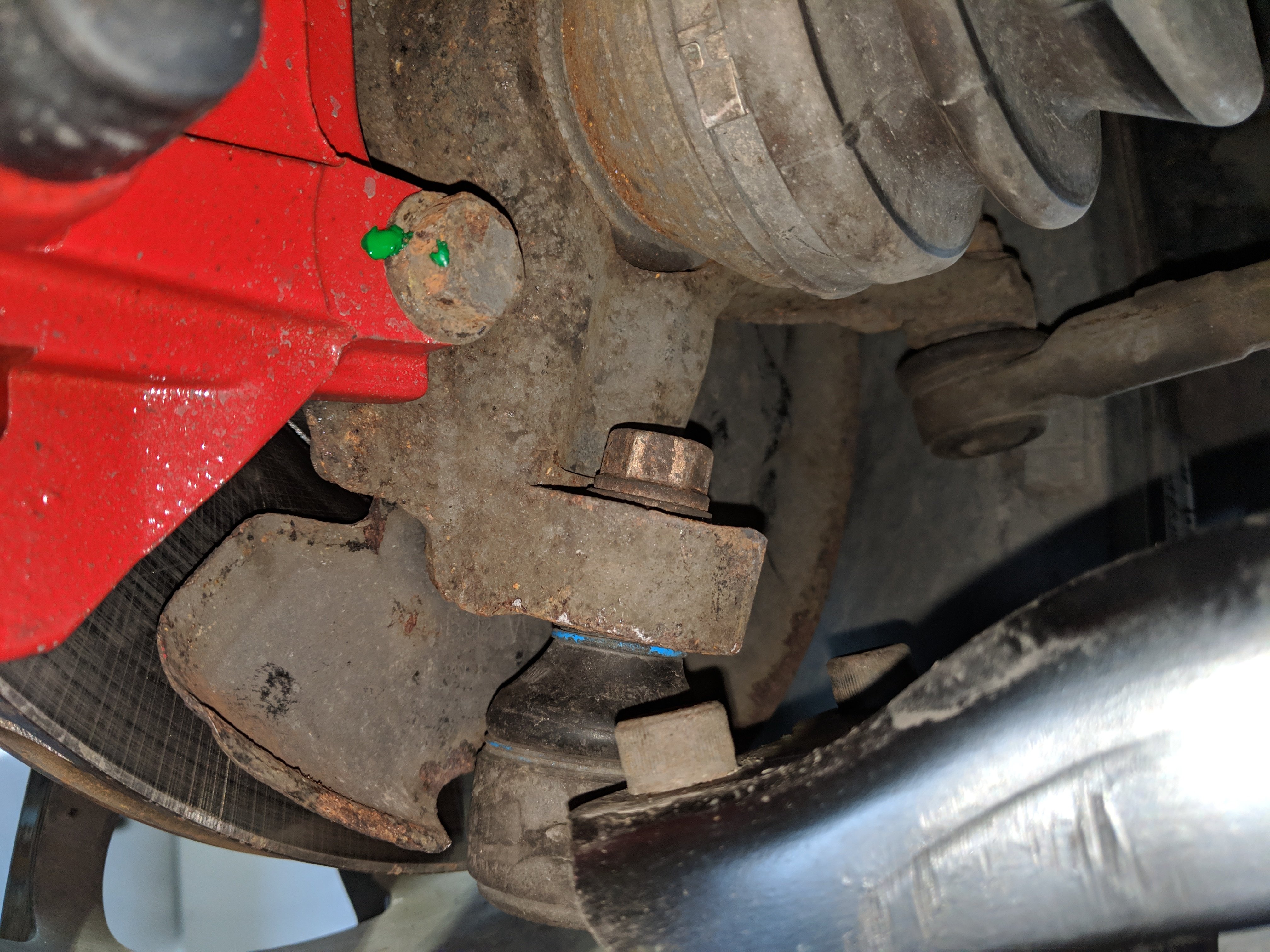

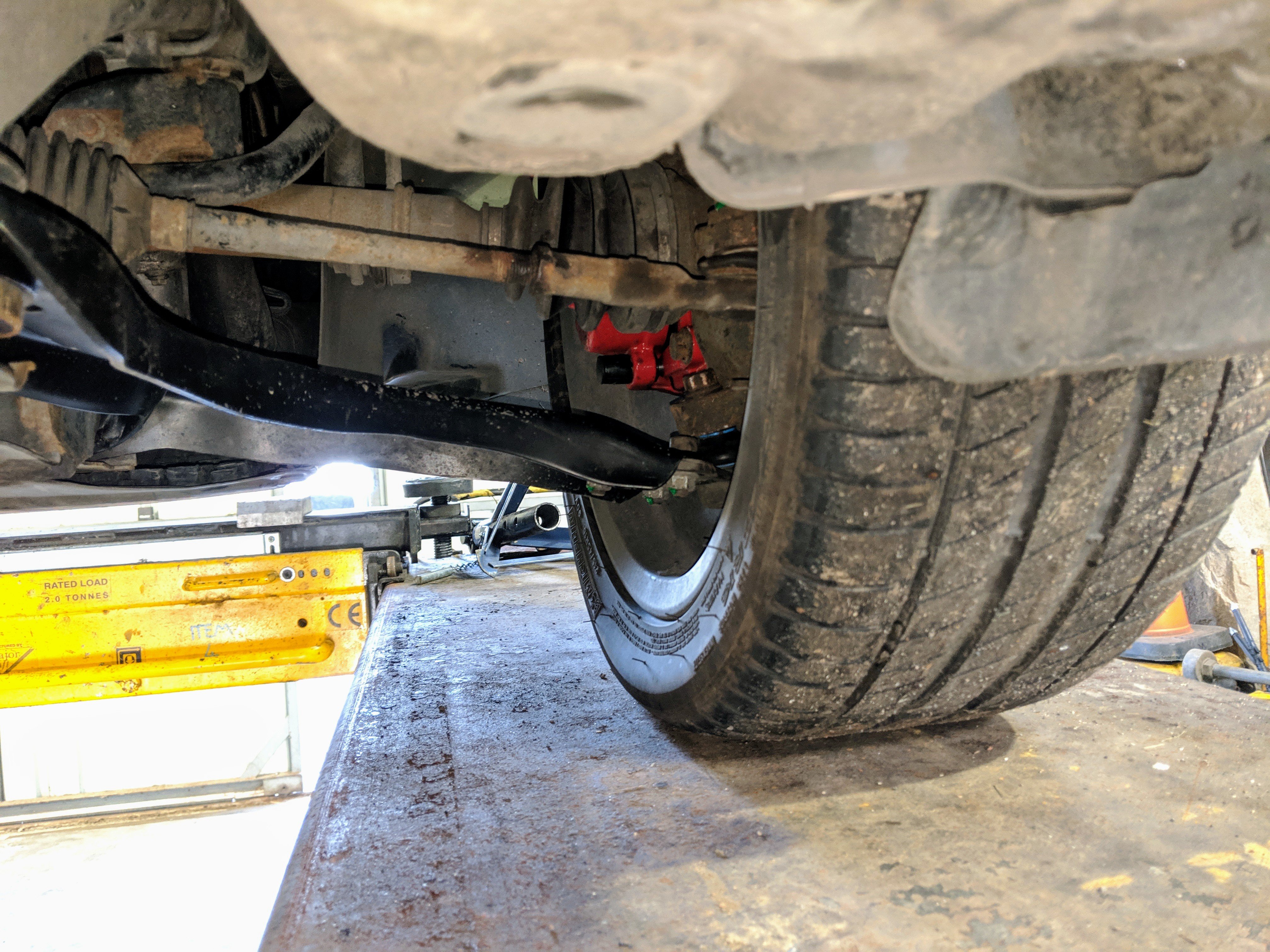

The increase in distance between the hub and the ball joint mount means that when the car is back together the lower track control arm looks like this.
The arms pivot points are now sat much lower meaning that as the strut compresses during cornering we get much more dynamic camber. This should keep the contact patch of the tyre flat against the tarmac for longer, increasing grip and delaying understeer. The added castor settings will also be adding camber as the wheel is turned further into a corner. Subjectively I feel the initial turn in has improved but this could be because the toe in is now set to 0 degrees.

I'm hoping to get the final laser alignment done on Wednesday and will post the results then. Does anyone have a 4 wheel printout from a standard car to compare it to?
