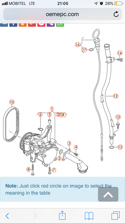

Anyone know if there is any interval for changing Belt on oil pump? I am searching but cannot find anithing. I am about to do timing belt and if its necessery also oil pump belt(number 10 on picture)
do you have the common oil pump knocking noise ?
I have a scout with a crmb this has the same belt set up they have told me there is no current interval. Belt is a wet belt system that’s has been becoming more common since the 2009 ford lynx engine and i suspect the belt setup  on our engines will be very costly to do
