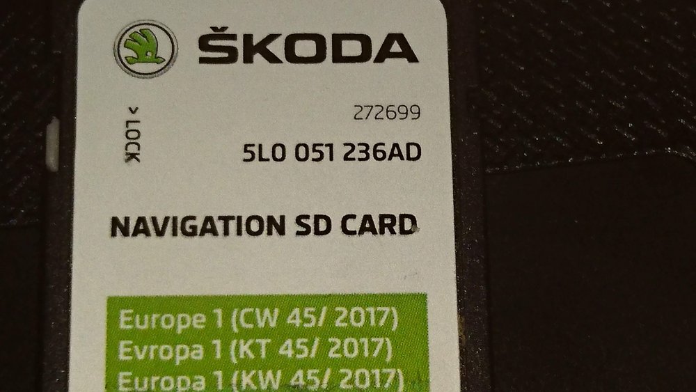

The latest version of the  update is ECE2018/2019. I dont see how the sd card can lock your system. The sd card might be locked with the tab on the side that stops you from over writing.
If you want to update  save maps then delete download new maps from portal (12gb) could take a couple of hours. then copy and paste you can use any sd card or usb for radio station logos You can find the version in your system settings

that sd card is the right one the numbers on the card are what version of maps it has before you update

Here is mine out of my Karoq Mine came in a sealed white cd box took delivery in June
