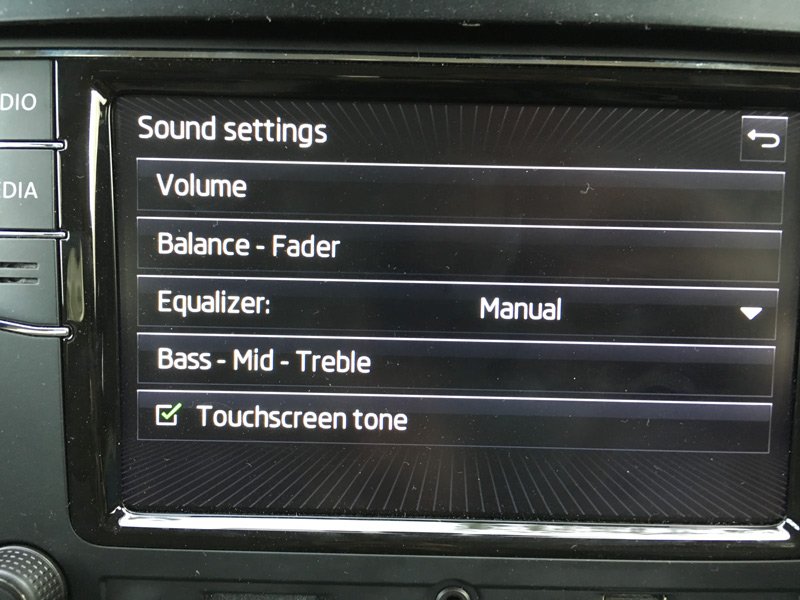

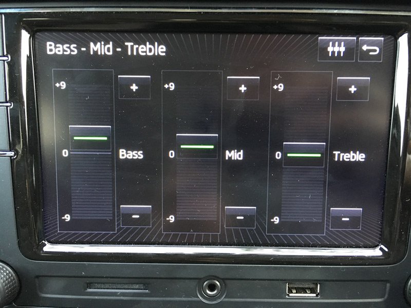

  • Individual sound/volume settings for media playback for Bluetooth, USB, Aux, SD

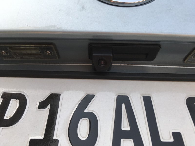

Rear Camera
I bought an aftermarket good quality rear camera with Sony CCD for around 22 USD.

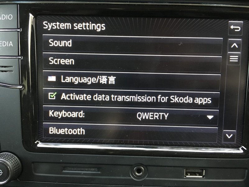

Media: You can change the source to SD card, USB, BT Audio or Aux.
Phone: Supports Voice operation too. Incoming call is shown in MFD (Maxi-Dot) too, but I can't seem to make the steering button (right side) work to accept the call. Possibly some options in VCDS that I need to look at. For now, had to accept the call from the HU.

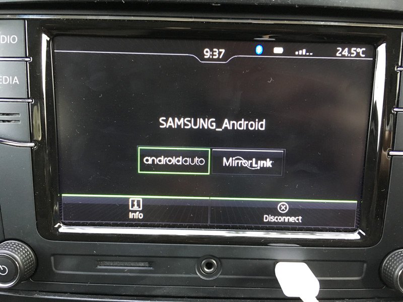

App: The HU supports Android Auto, Apple Carplay and MirrorLink. I had tried Android Auto (Samsung Galaxy s7 edge) and Carplay (iPhone SE) and works seamlessly.

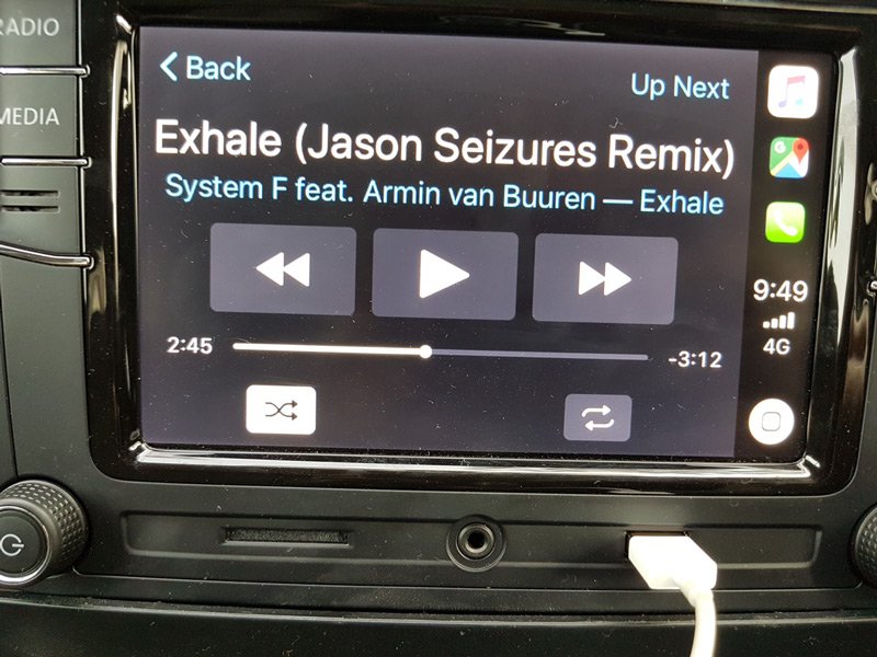

CarPlay > Music

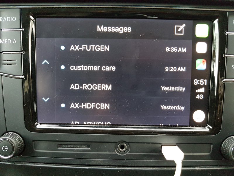

CarPlay > Messages
Siri can read the new/unread messages for you.

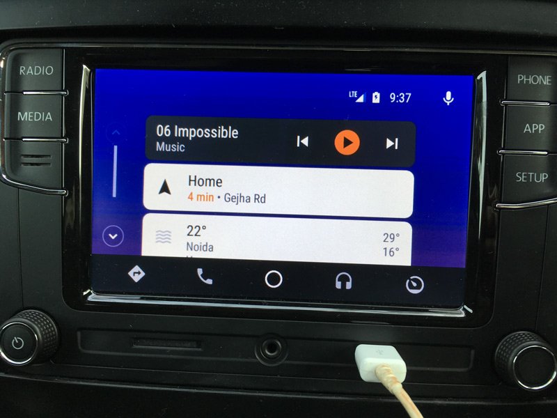

With Android phone, you have the option of connecting either via Android Auto or Mirror Link:
Android Auto > Landing page

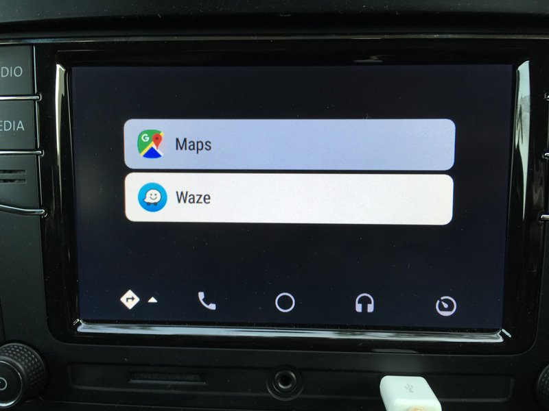

Android Auto > Maps
Choice of either Google maps or Waze.

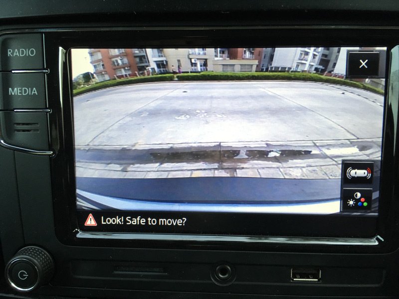

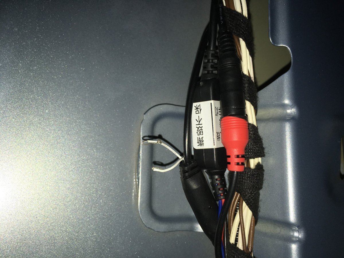

Connecting Rear View Camera to HU
This is perhaps the only complex part of the installation and took a greater part of time. RCD330g supports connection with any aftermarket AV camera which is excellent as OEM (RGB) cameras are very expensive. Just remember to get a decent one. I got a sony CCD one for around Rs 2K. The camera came with 5 or 6 metres cable.
Connection diagram (courtesy from Aliexpress seller):
1814957d1541309454-skoda-yeti-replacing-
Just wiring the camera cable from dashboard to rear took a good 2 hours, ripping off plastic trims on dash, sides, trunk and rear. And then as per the diagram above, we connected E and F to reversing lamp using Crimp Locks to avoid slicing/cutting of wires. Power to the camera is delivered from ACC (cabin fuse box). The head unit already comes enabled with VCDS coding, so if you don't have VCDS cable, no worries
Picture quality is simply fantastic, so is the wide angle. You can even adjust the picture/video brightness, contrast and Hue. Lastly, by default the camera don't show the guiding lines. To show the lines, you need to cut the small wire in the camera unit.

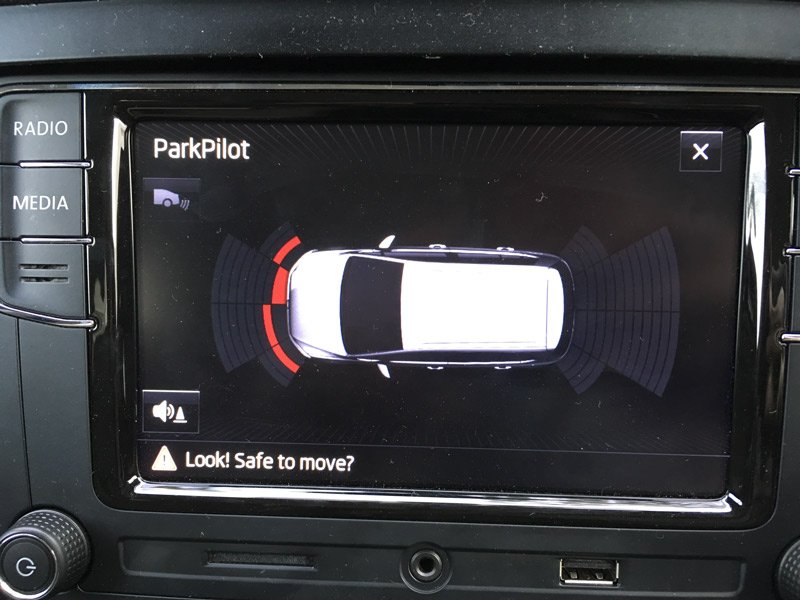

Optical Parking System (Park Assist)

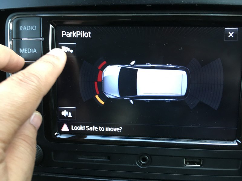

I won't have gone for RCD330g unit if it didn't support the park assist (OPS) of my car. Many had reported their OPS don't work on RCD330g and that was possibly due to older or lower variant CAN Gateway. Mine was higher one (7N0 907 530 H) and hence no need to upgrade my CAN gateway. Only then I ordered the head unit.
I got VW Jetta as the OPS image. With VCDS, I tried changing to Skoda Yeti, but all I can get was the Polo (hatch). And for now, it is good enough for me.
To switch to camera, click the small button on the top left corner.
