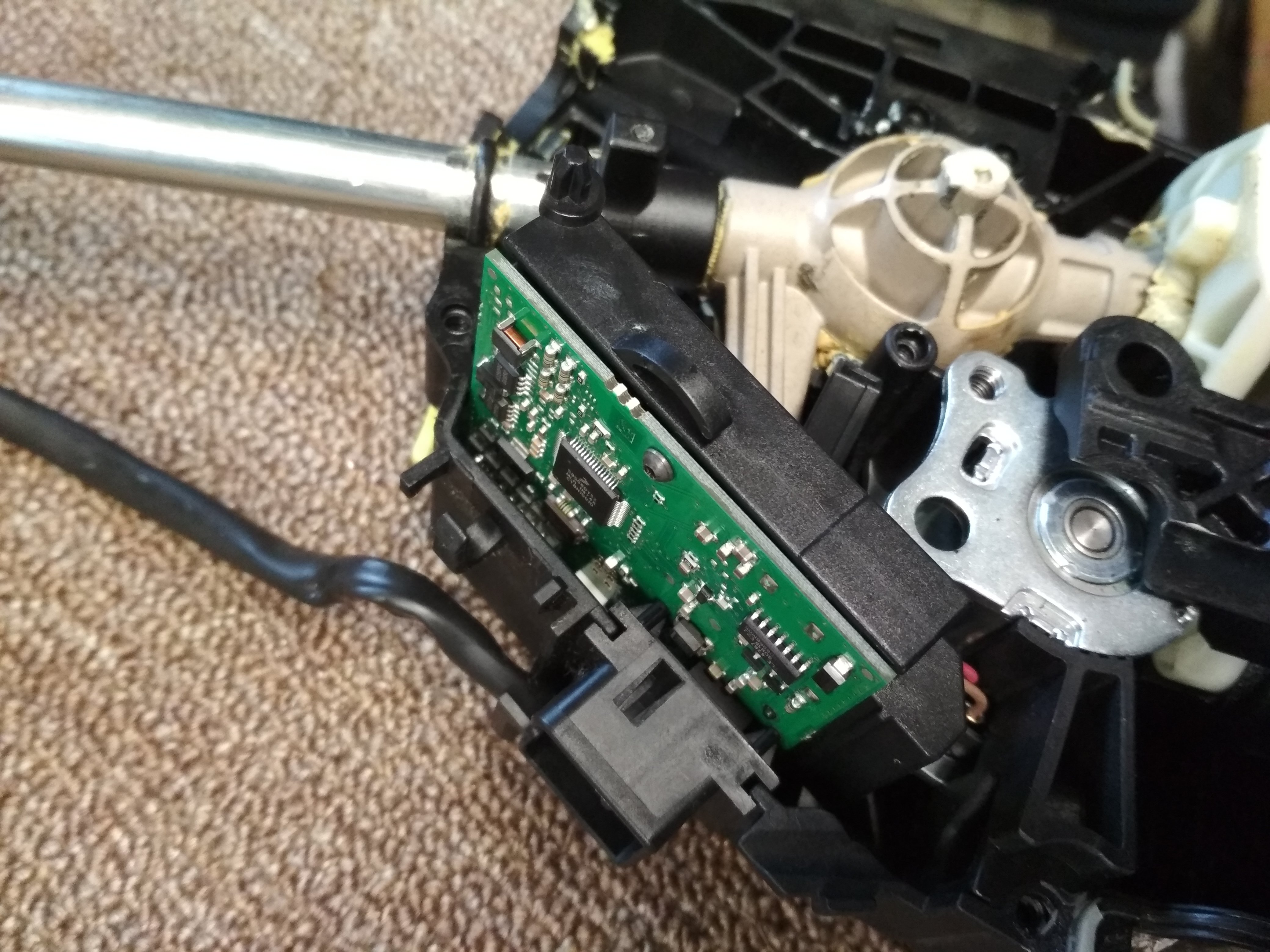

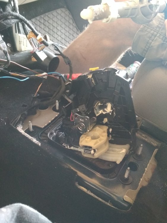

Hi. I finally managed to solve the problem. I have a friend who had a spare gearbox. I mean the lever and stuff, the selector. So took it apart, and switched the electric control board what's inside the selector. Unfortunatelly you have to take out the whole central console, with the armrest, and stuff. It's not the easiest job to do but manageable. Here some pictures if you want to take it apart. I don't know if your's have the same problem, but maybe a way to start with.
