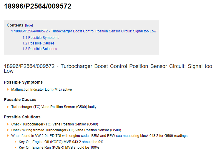

P2563...
P2564...
Thanks.
Why has the Turbo Charger Vane Position Sensor got two different references - G500 and G581?
Found the linkage coming out the bottom of the VNT Actuator in the first picture. I can touch it bit not apply any force. I'm hoping I'll be able to get it to move with a handheld vacuum tester.
