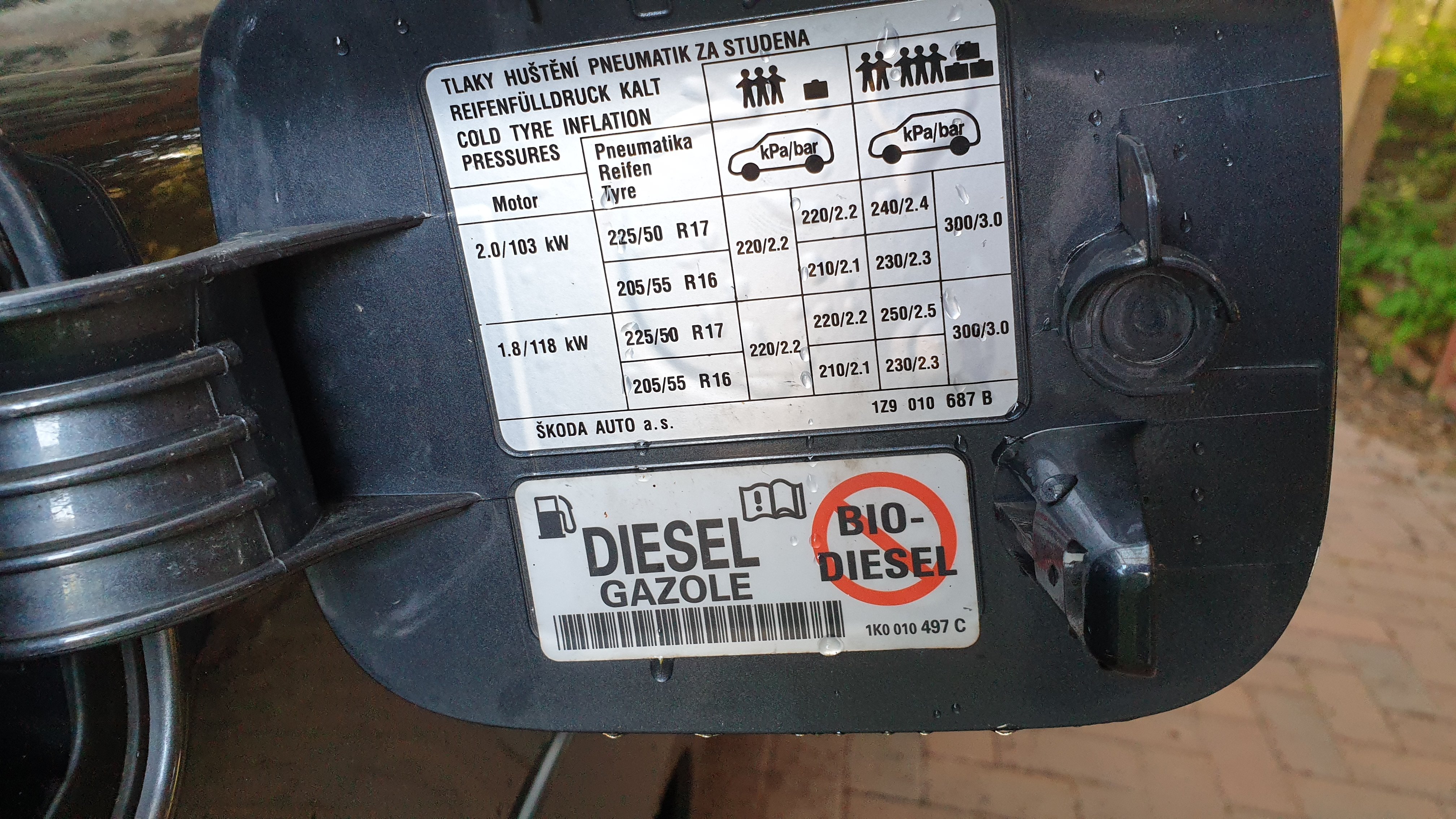

Have purchased a one owner 2011 Octavia Estate 1.6 Diesel Cr  80,000  miles fsh.  As I drive Octavia 4x4 Estates for my job I am happy to get this one. I would like to increase wheel size but not sure to what. Peter
There should be a list of manufacturer approved wheel sizes in the fuel flap. Go out with those sizes, and IIRC, you invalidate your insurance.
Ok thank you , the ones at work have 17” dia will check flap
If you get no joy, let me know and I'll check my 2010 brochure and see if there was a 17" option offered for the 4x4.
The Octy Scout came with 17" wheels as standard.
What wheels are fitted to Octavia Scout please .
225/50 R17
For winter tyres on 16" steels, I fit 205/55 R16
Thank you so much for that info. Peter
