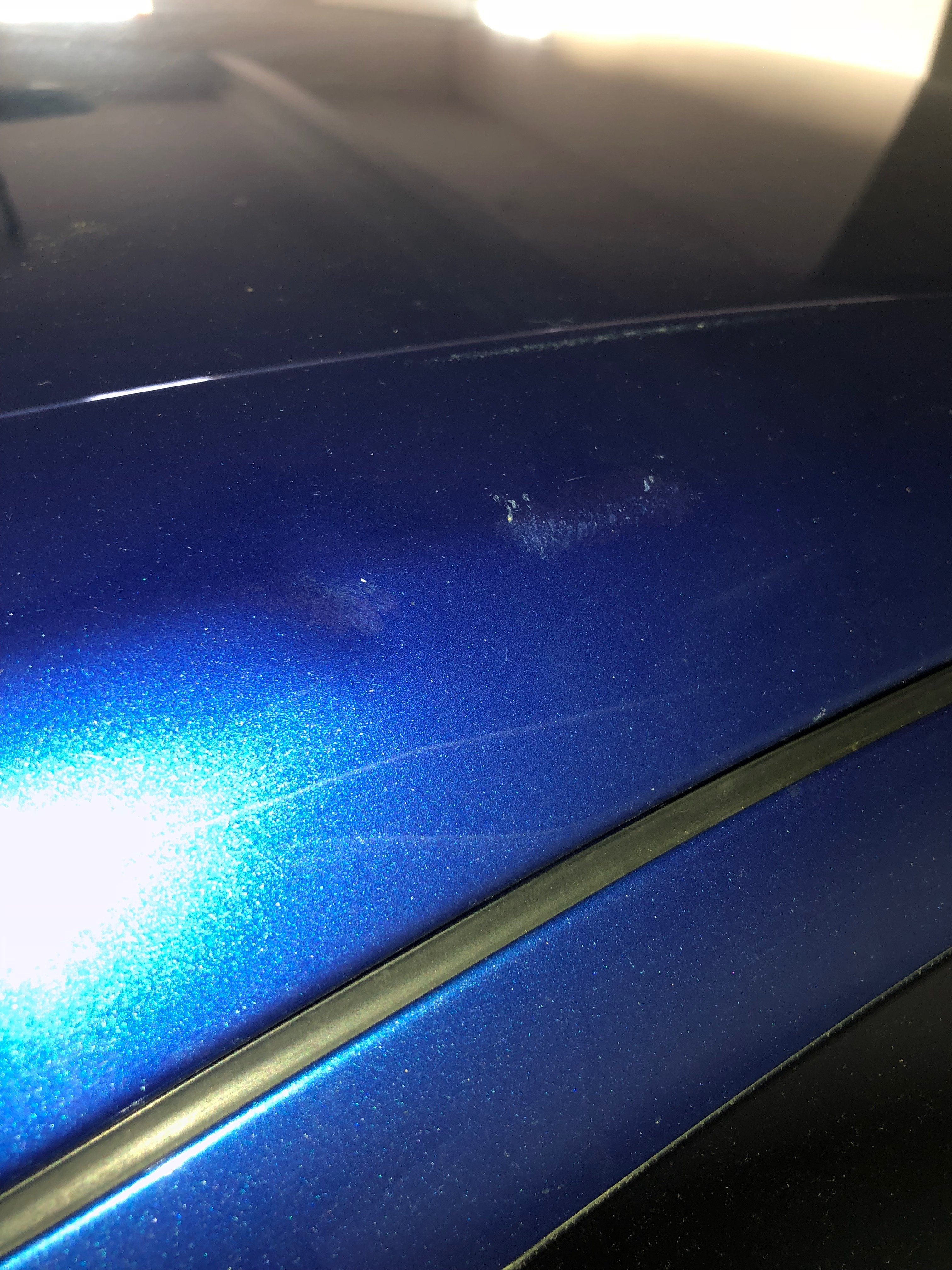

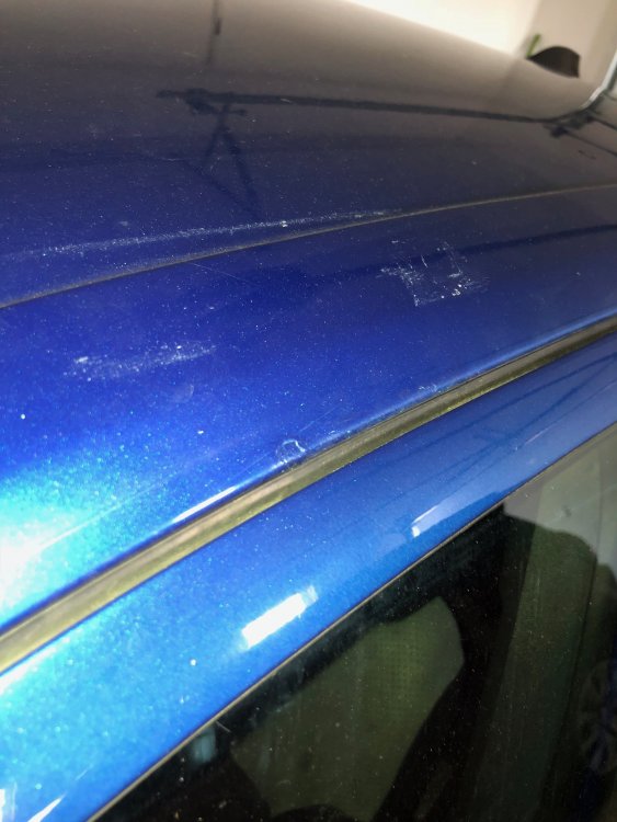

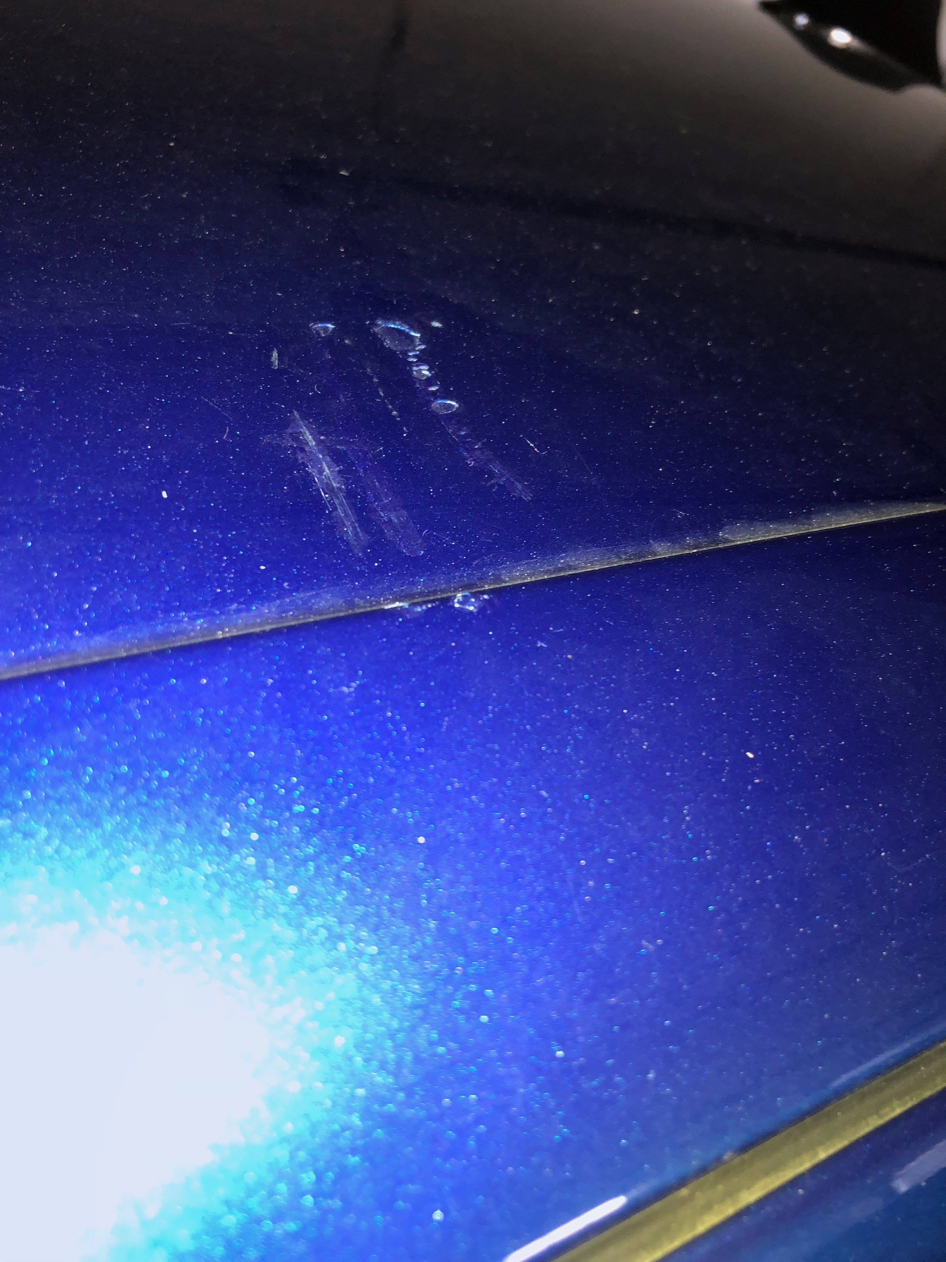

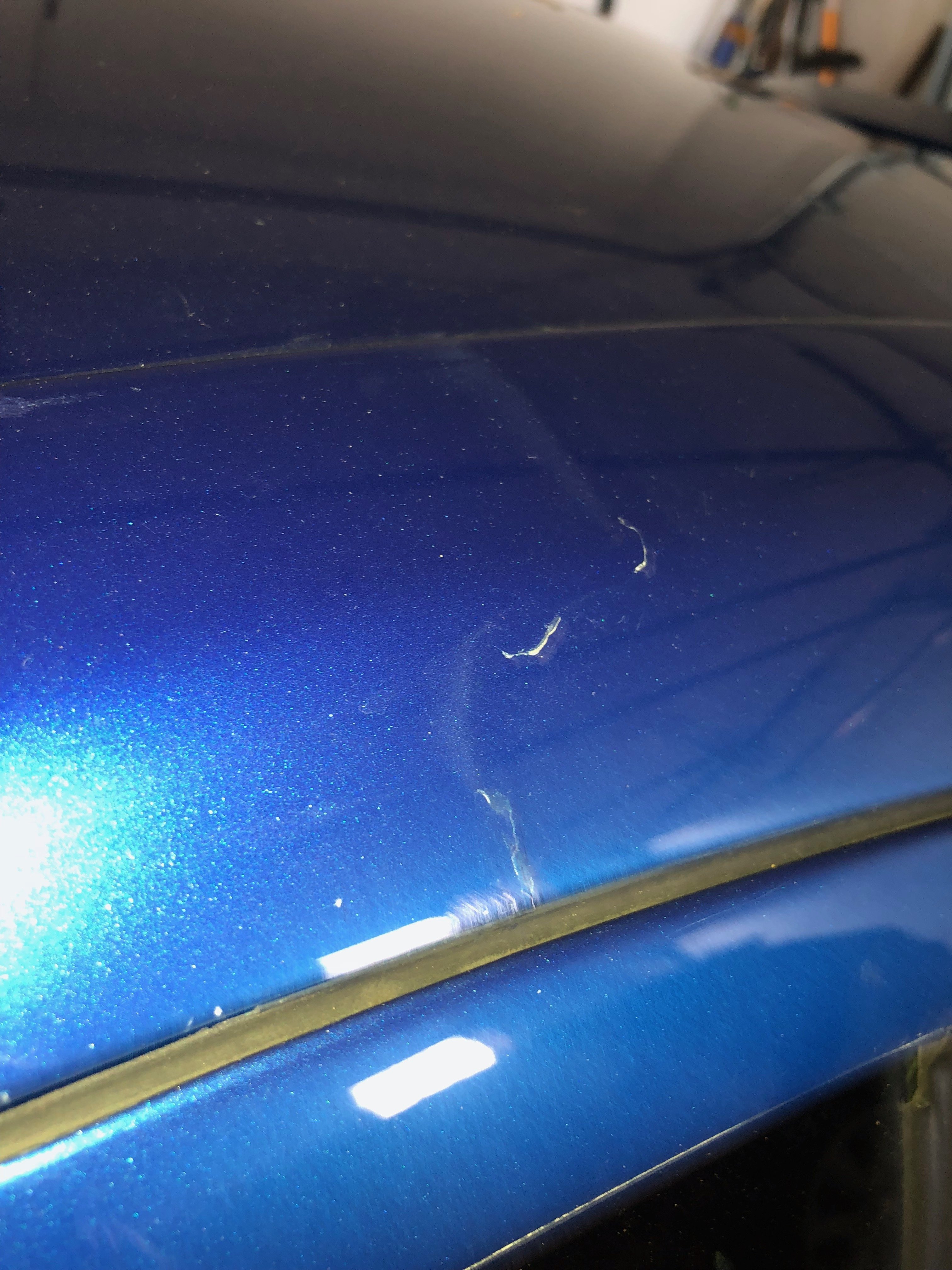

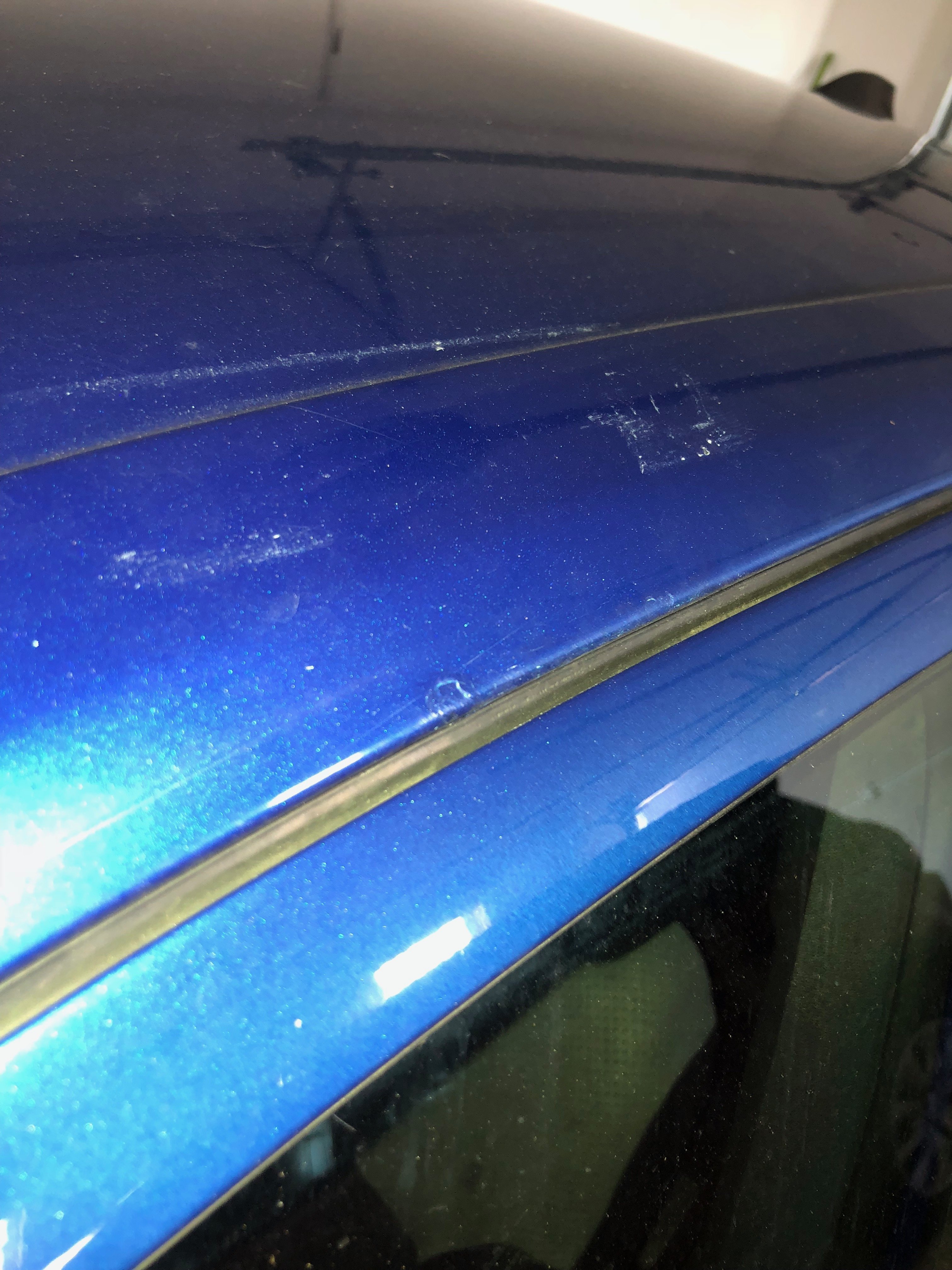

A few months ago I bought an Octavia vRS with a badly removed roof rack, now is the time I'd like to repair it, but I'm not sure what to use and how would I fill in the small dents! Any help would be gladly appreciated! I added some pics below!
Smart repair or body shop i'd say
Most of them are in the lacquer coat (they show up white) and will flat and polish out, the deeper ones will need touch up paint then lacquer, OK for the single scratches but if they are multiple or its dented then its a smart repair job.
