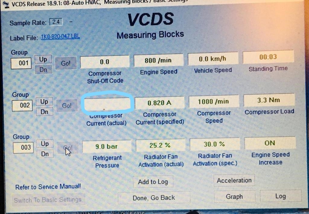

Hi , I also face same issue .. when its hot outside AC doesn't work at all ..
When i scan for errors .. there is no error found , but compressor current (actual) is not having any data ..its empty.
any idea what may be the issue ?
Am in the same boat too!
Would appreciate inputs.

I have done refrigerant refilling also and tried , but same behavior , more note : 2 month back i replaced the Condenser , compressor and High Presser value .. after that AC worked for few days and after that started behaving strange as mentioned above.
