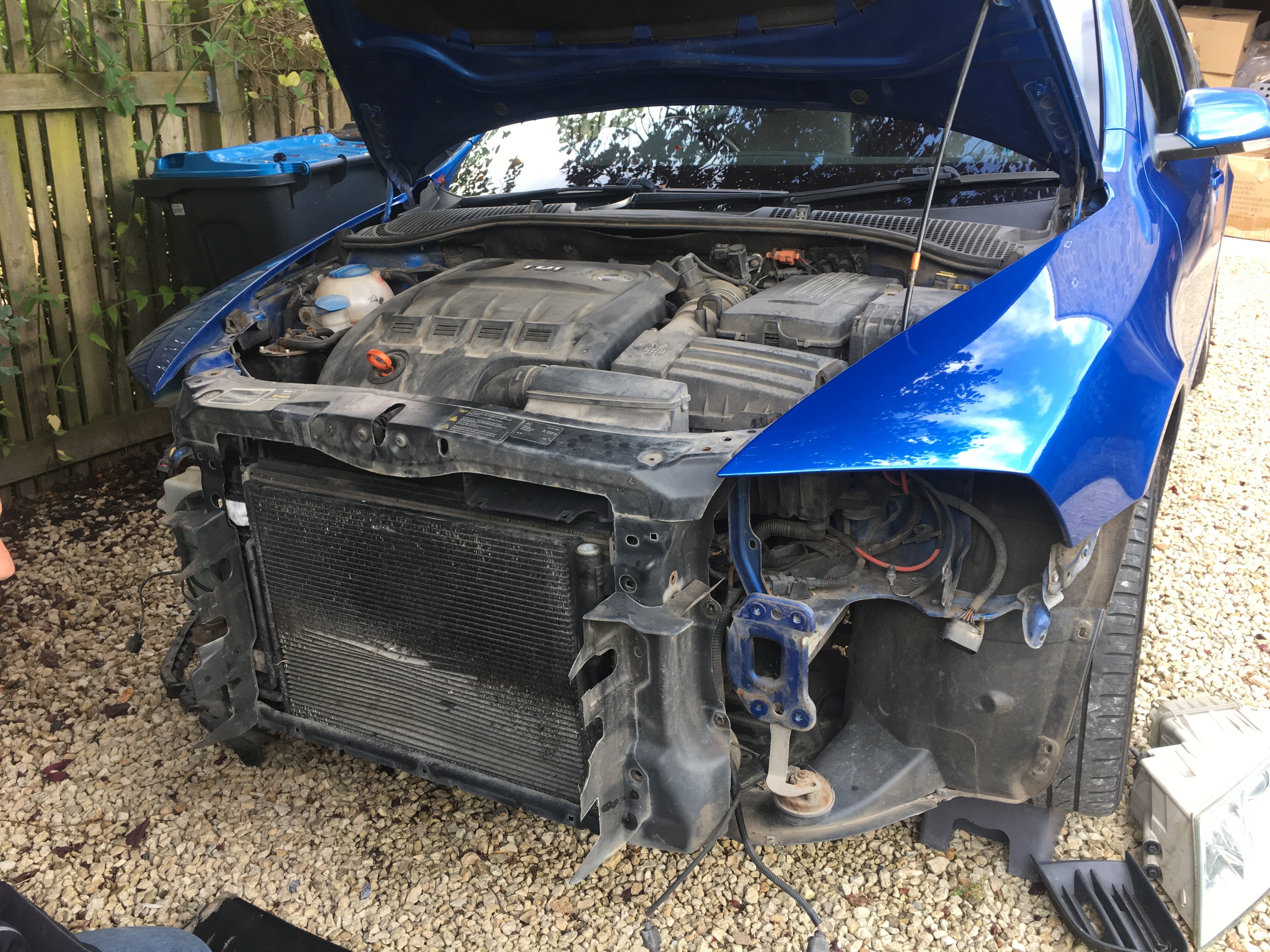

Following my recent purchase of an 07 Diesel VRS I took a gamble knowing the air con wasn’t working, turned out it needed a new condenser and compressor...
Checkout the condition of the condenser...😲
The chap who fixed it apparently does a number of Octavia’s and Golfs, commenting on the pain to remove it though...
So I’m finally ice cold, just as we turn into Autumn...
