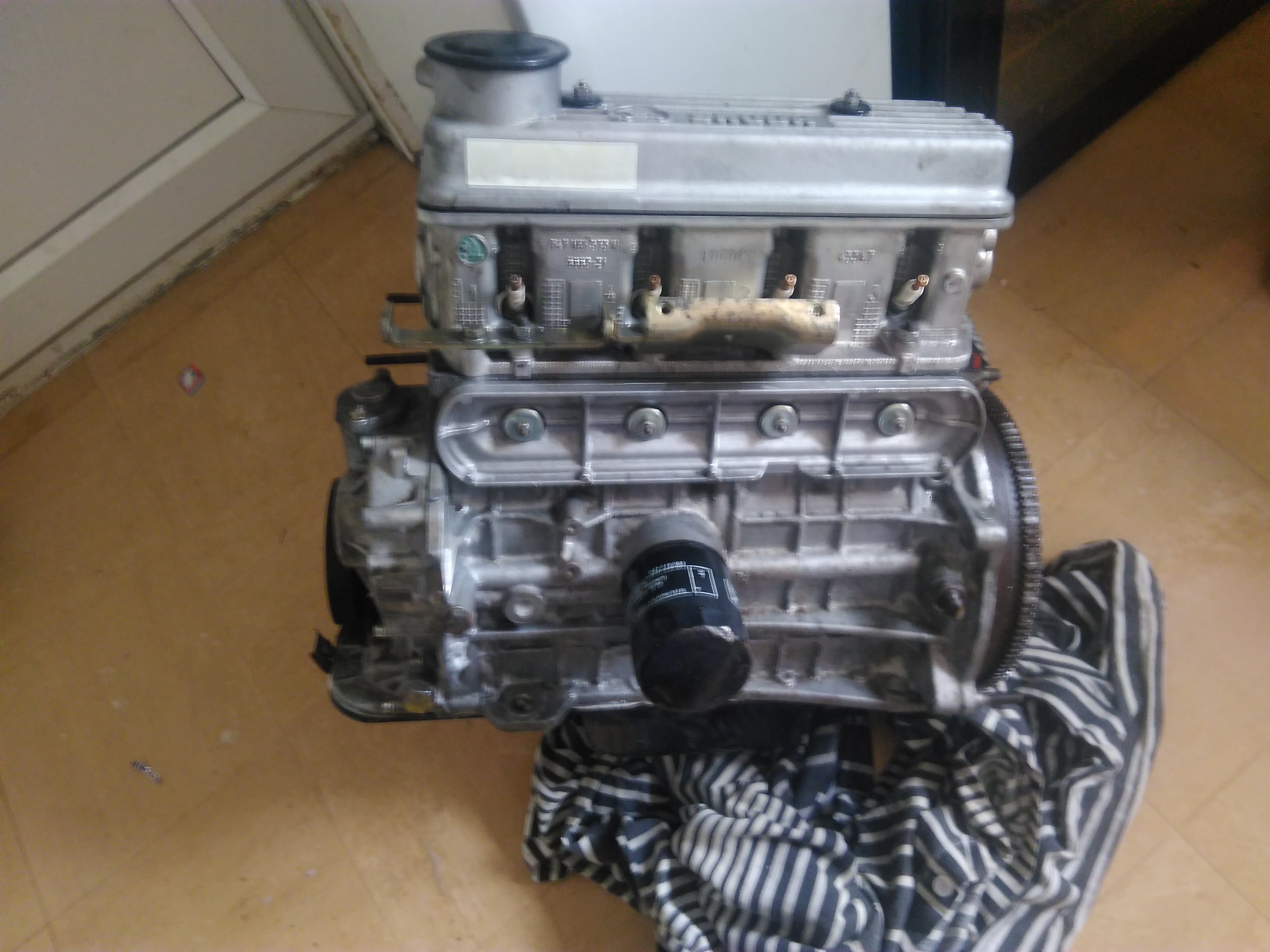

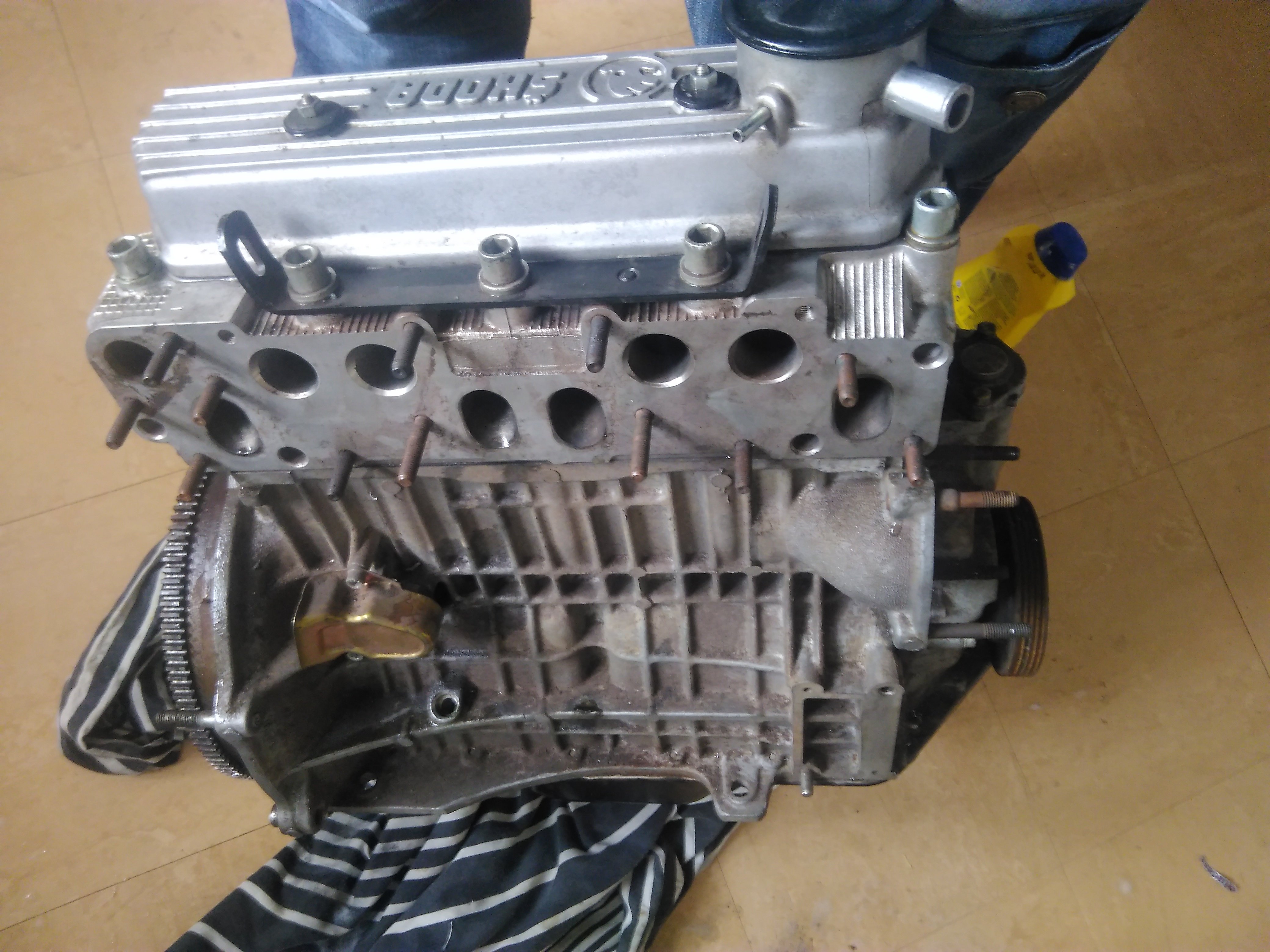

Hi I have recently purchased a skoda 136m engine to go in my Estelle what's involved in the process of swapping out the 120l there is pictures to see what I'm working with I will need manifolds as the 120 I a 5 port head
I wrote a piece on what was needed to convert a 136 to fit in an Estelle......looking at your engine without a dizzy it makes me think it may not have the necessary cut out in the end of the crank to work in an Estelle.......take a picture of the flywheel end of the crank and I'll tell you. If it doesn't then you'll need to take the crank out and get it machined. In the meantime I'll see if I can find the list of parts you need and what can be swapped over.

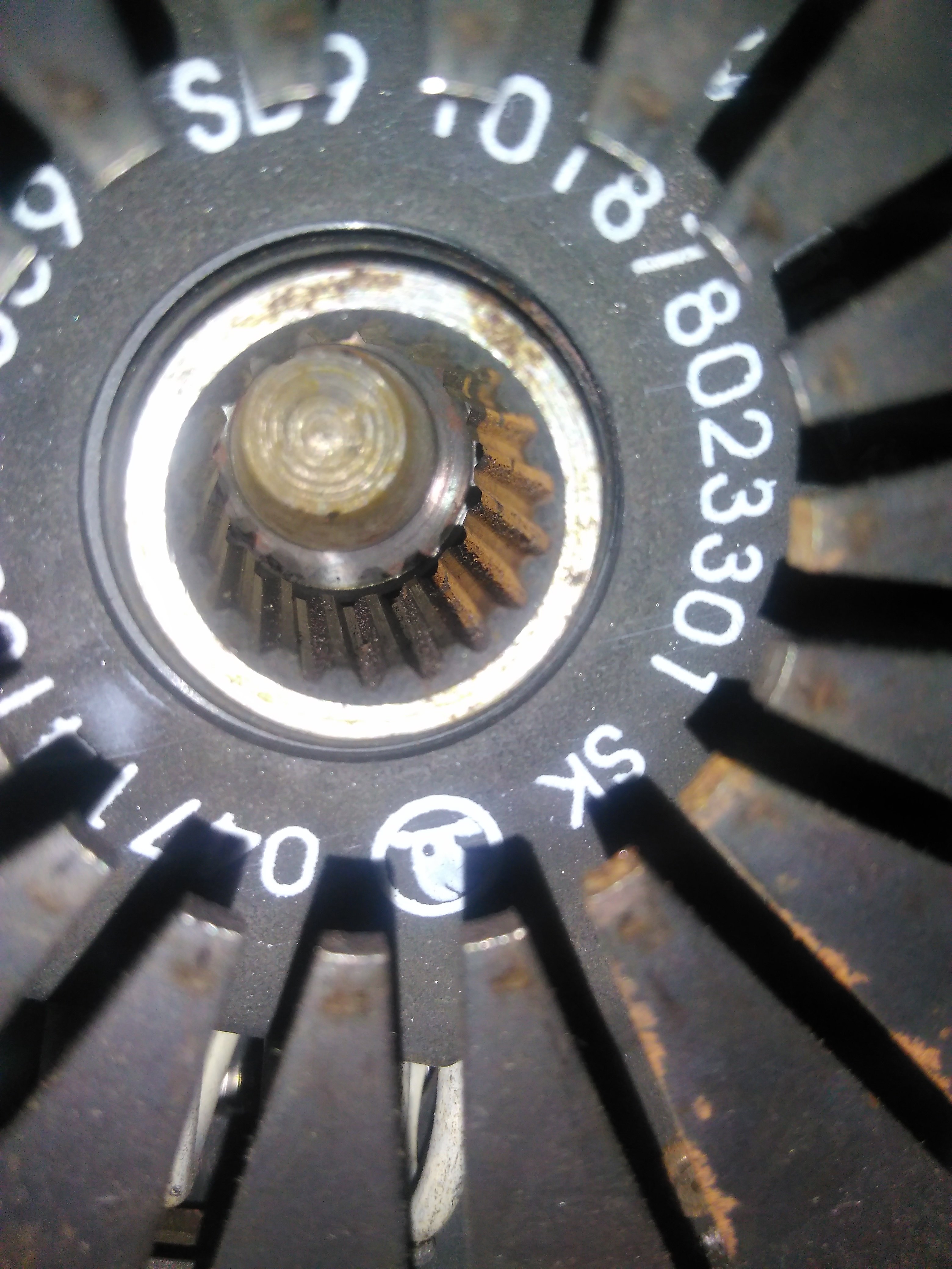

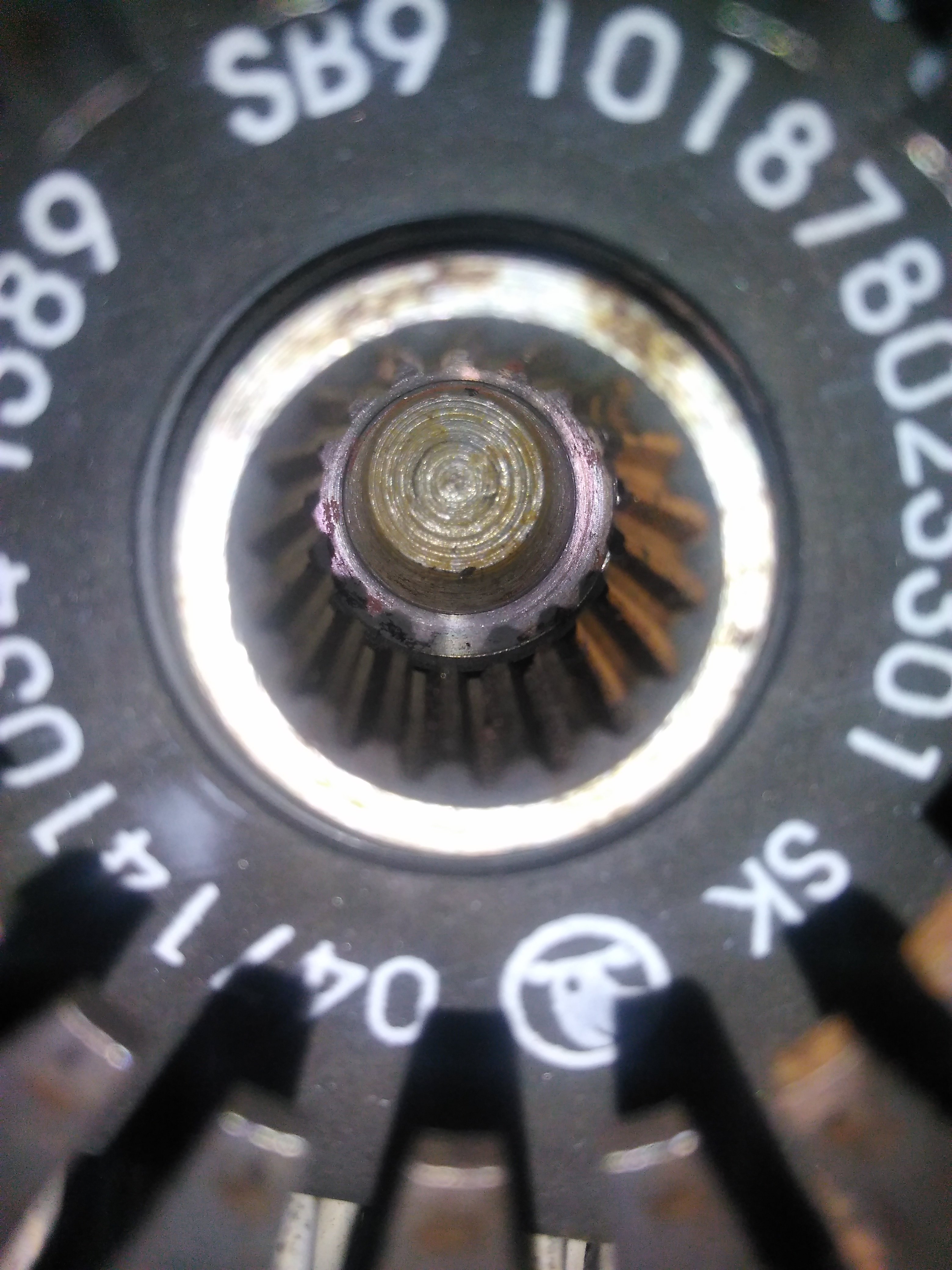

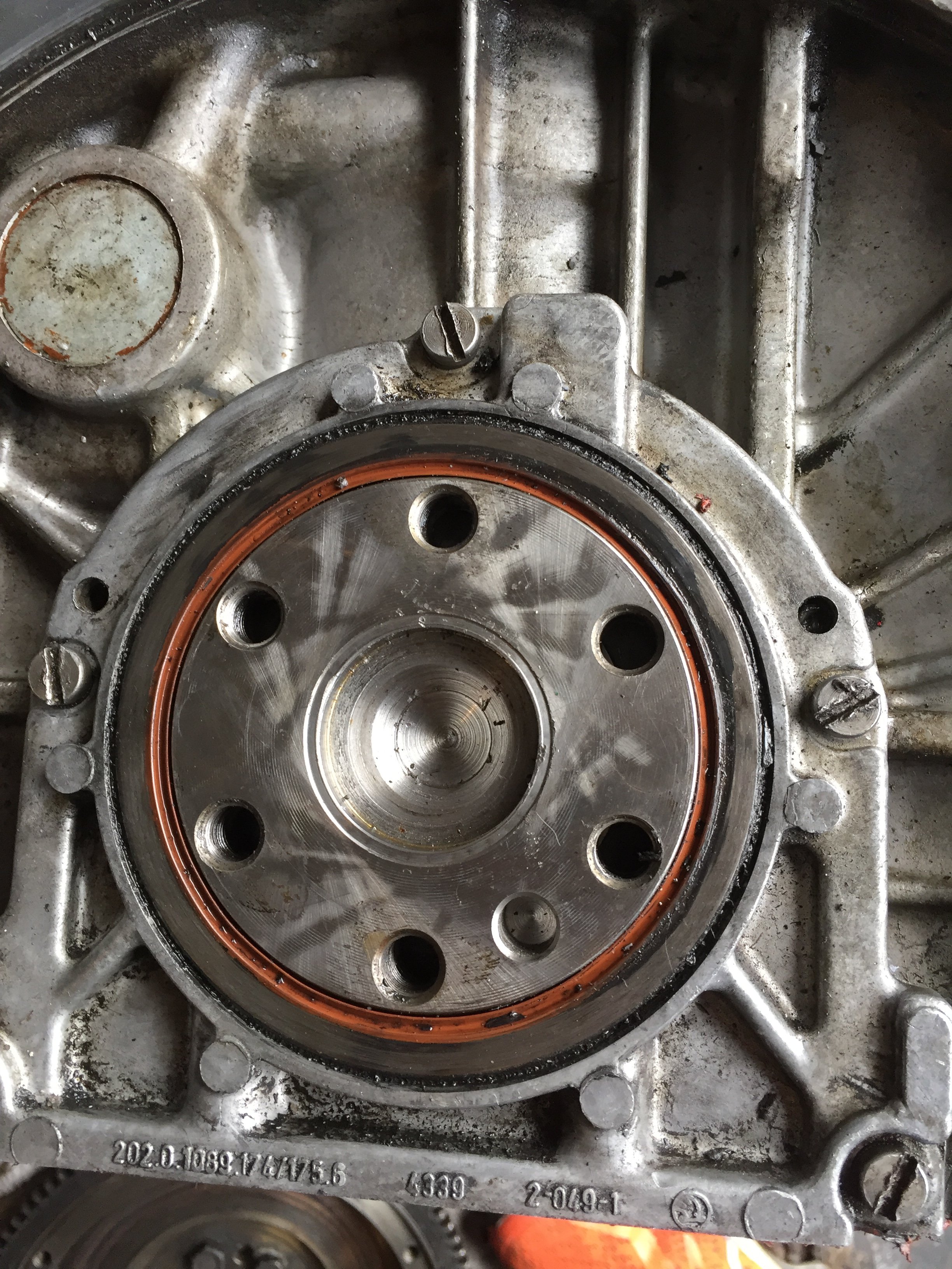

Hope the pictures are clear enough to see thanks
Yes they certainly are......that isn't compatible....you need to get the crank machined unfortunately......there should be a cut out with a bearing in it for the input shaft to sit in.
Here is a photo of what the end of the crank needs to look like.....the cut out is designed to have a 6202 bearing sat in it that the input shaft fits into
Thanks for that picture so it requires like a spigot bearing would the crank out of my original 120l engine fit or would it be better to machine the136
Almost nothing is compatible from your old engine....the crank main bearings are a different size. As Kieran pointed out on Facebook the engine also doesn't have a fuel pump take off so you'll need to fit an electric pump. Inlet manifold is one of the main problems because the FWD ones won't work with RWD configuration as they are - if you know someone with a machine shop they can possibly cut one to sit at the right angle.....but RWD specific ones are super rare because only the Rapid 136 had them and they didn't sell many. You may also have problems with finding a pulley to fit if the crank is the later larger type.......see if your 120 crank pulley fits.....if it doesn't then there is no pulley to fit that uses the Estelle v belt configuration. Exhaust wise....you should be able to get a Favorit or Felicia manifold and modify it, or buy an aftermarket exhaust system from CZ.....but that would cost (£500+)
