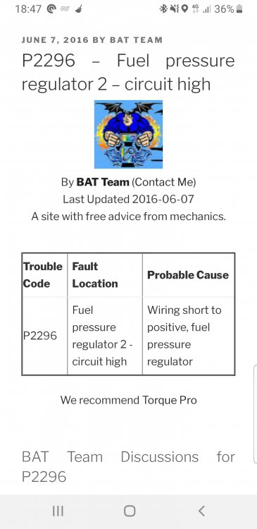

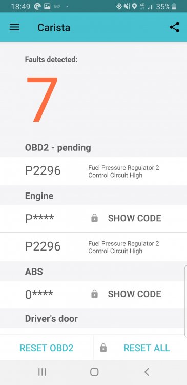

Hello all. Having issues today to start my 2011 vrs tsi. Don't seem to have any compression as car is not firing. Got home from work to have a look and scanned using carista, threw up code P2296. Guess if the fuel pump has somehow failed then this explains the no compression. Anyone come across this before?
