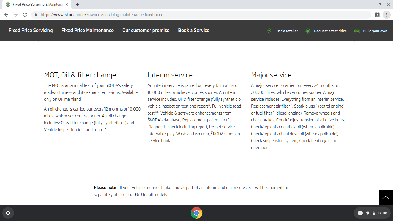

How often should the fuel filter be changed on the 1.4 three pot diesel, I can't seem to find any mention of it in the handbook. I had it done on the last service a year ago & the car is telling me a oil change is due in 300 miles so I thought I might have it changed at the same time.
The Skoda Fixed Service price menu at participating dealers shows that they might change diesel fuel filters at Major Services.
This is on cars 3 to 10 years old.

Skoda / VW / Audi / Seat dealers might do them every 20,000 miles / 2 years, or might not.
Like I said the last service wasn't done at a main dealers & the mileage was 20483, from what I can see in the service history the fuel filter hadn't been touched until I had it done last year.
Sounds right to do at each 20,000 miles or 2 years in the UK where diesel is not going to be contaminated as in some world regions.
