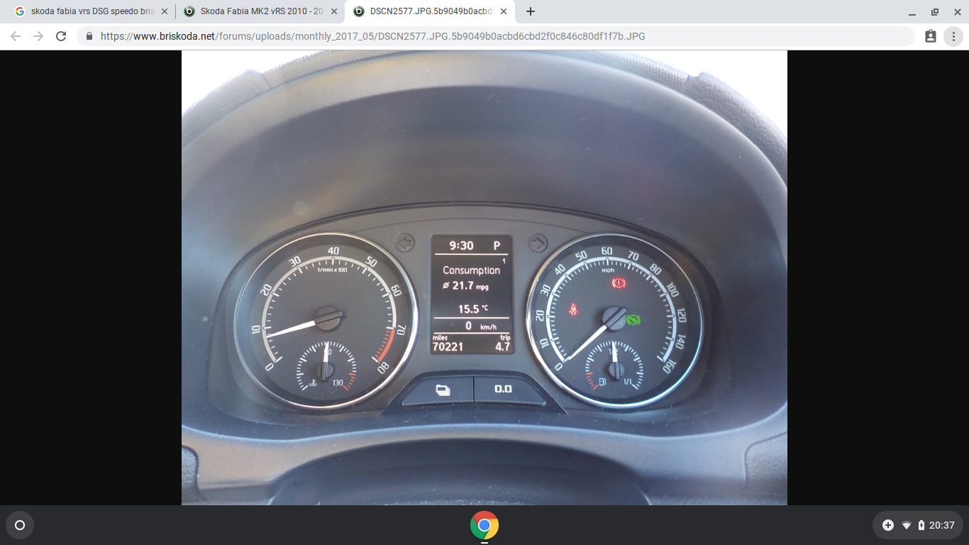

The only issue I had was while accelerating in parking mode it wouldn’t go above 40 hence I booked another viewing in day time to check on motorway .

It’s automatic car in parking mode I was in during accelerating and the needle wouldn’t go above 40 .

In 'P' the car should be parked and the front wheels are locked.
Sorry, but not sure what you are doing or did.
I was accelerating while it was parked to check engine noise .
So not above 4,000 RPM.
Thats correct, it should not rev higher in P.
 Why would you want to rev it when stationary above that to hear the noise unless you want to wreck an engine, hence the rev limiter. .

Oh ,that’s why .
