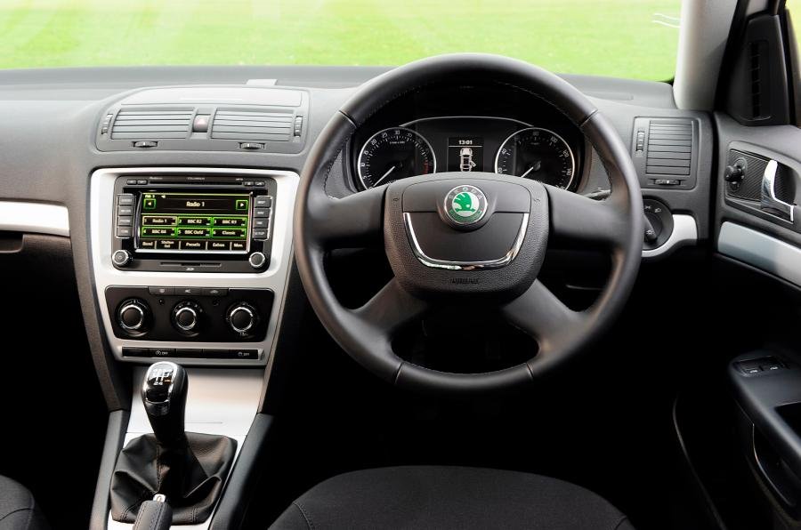

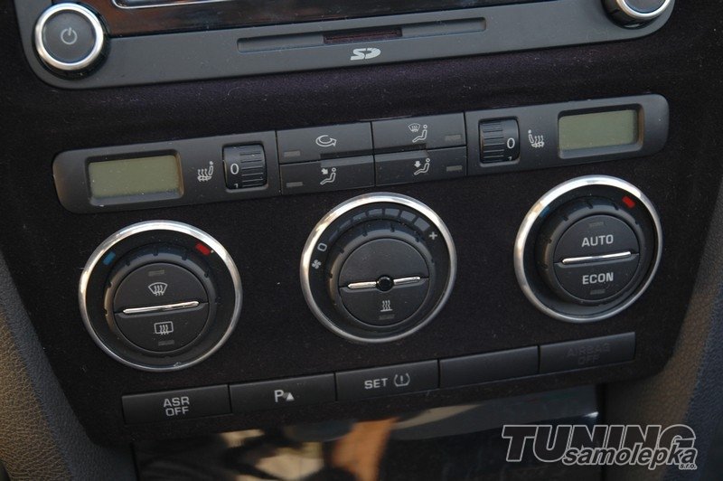

Do you have Climatronic?
Pre-facelift...
Facelift...

Or just regular controls?
Does the blower / fan work on any of the speeds, or just not on the highest setting?
If you have Climatronic then this is unlikely to help, but have you tried restting it?
Thanks bro. Did the resetting and so far everything is good. Will update further.
