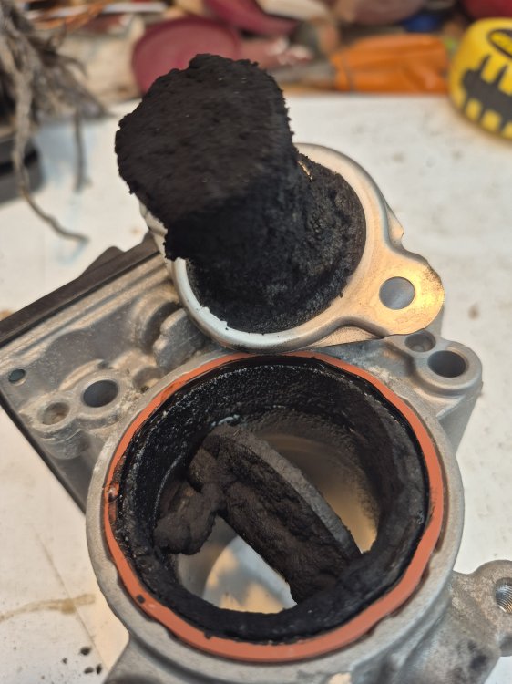

Your one was really oily & cruddy, mine was at 79K miles & had a lot less soot & barely any oil holding it together, it pretty much brushed off.
I wonder what the throttle valve etc would have looked like on a car with the same mileage without the emissions fix?
I bet your fuel economy will improve as well, mine has gone from 45mpg to 52mpg and was a lot less clogged than yours, I could feel the difference as soon as I drove it, much better low speed flexibility.

Yes, fuel average is now 50mpg. I always use proper VW spec low ash oil at changes, and did long motorway runs for work; that's maybe how I got away with it for so long! Now my wife runs this car, so shorter journeys.
