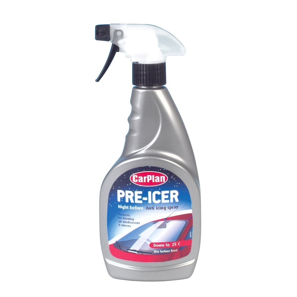

The Car Plan Pre Icer i got last year was rubbish for windows but good for spraying door seals as long as nobody gets their clothes spoiled on it and you clean off after the winter.

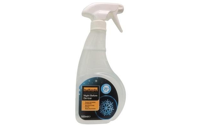

Halfords Night Before Deicer was great but not had it for a couple of winters.  It was usually 3 for the price of 2.
