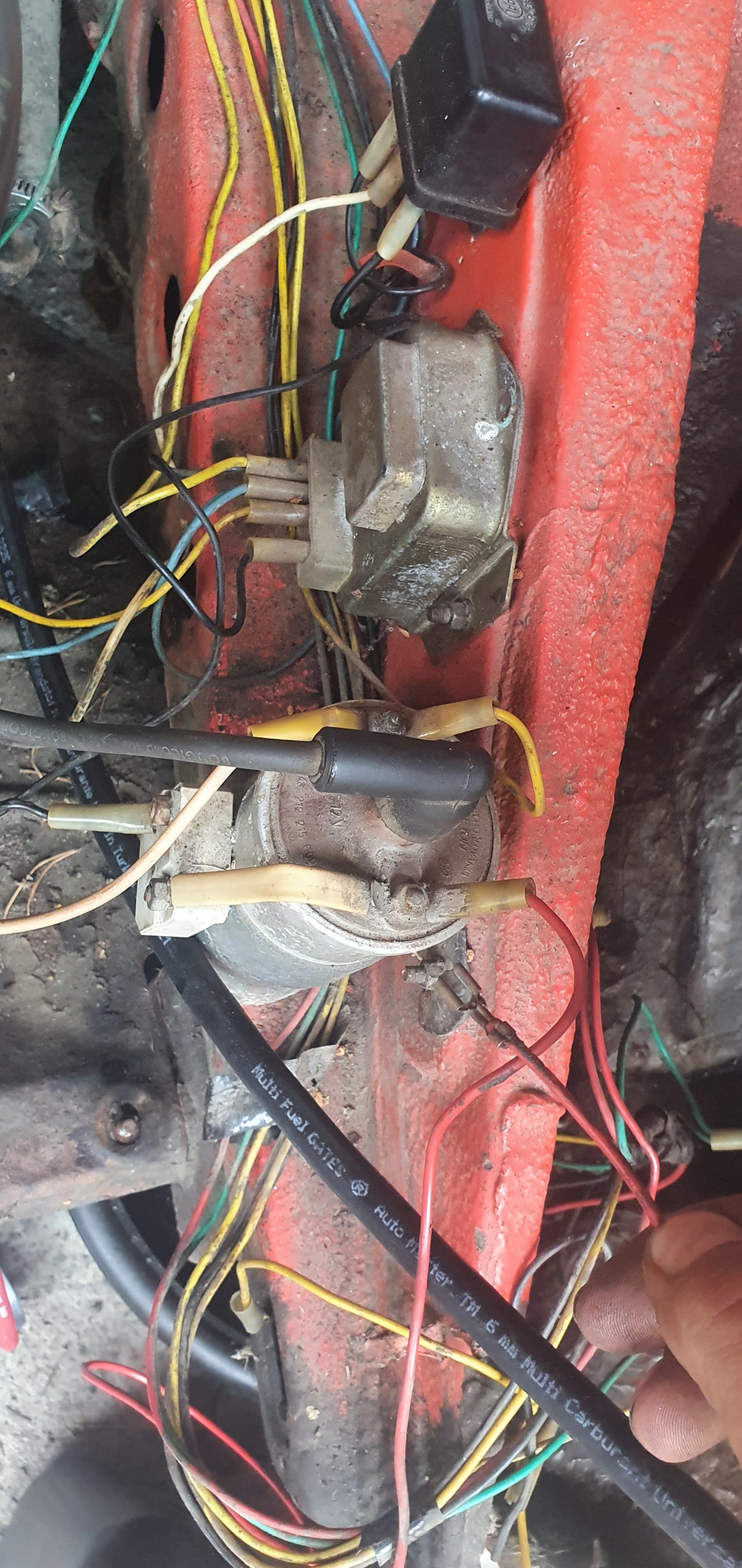

Now I've got it to the point that it cranks, but I noticed that one of the ignition coil wires is not connected to anything, the red wire here. It is connected to the, what I believe is the positive terminal, and the other end was hanging free near the starter, I've no idea where this should be going to, coil does seem to be getting power from somewhere as I measured the poles with a multimeter and got 6V with the power switched on.

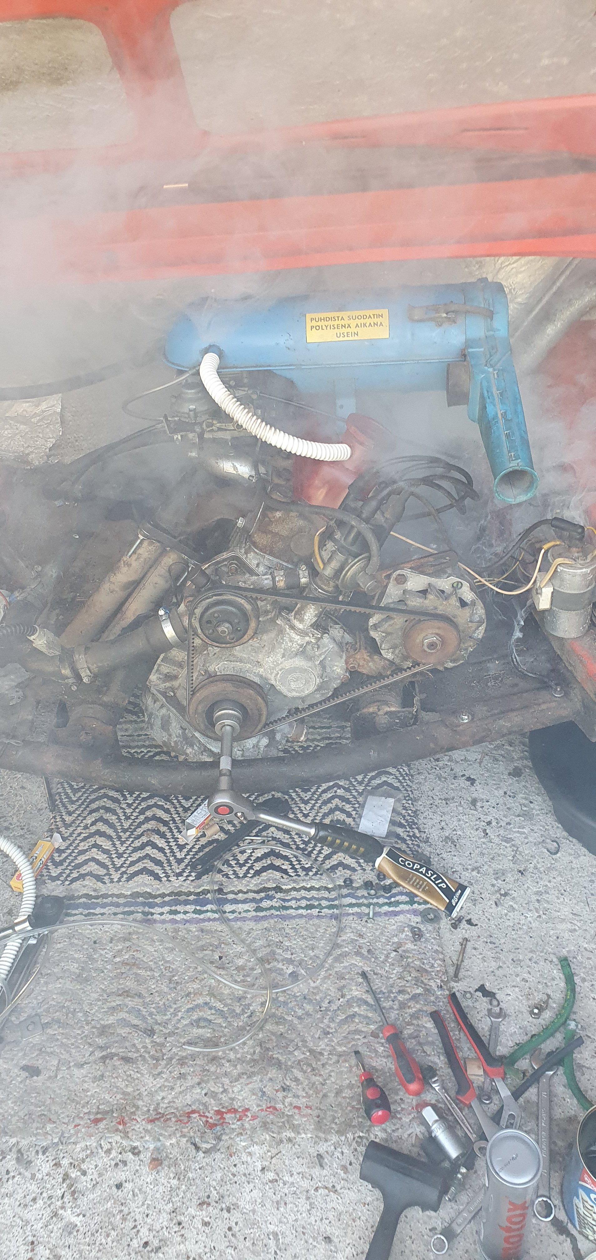

As an added bonus, here's me learning the hard way that not every black cable is a ground cable, you can still see the cable I ran straight from the starter solenoid to ground, learned from the smoke that it was also connected to the battery and not a ground cable.

I found some stuff in some hayness manual that the red wire from the coil should run to the starter solenoid battery terminal, but there's no "tongue" for it to clip to and honestly I have no recollection how coils are supposed to be hooked up
The red wire on my 84 estelle goes to the right side of the carb And White to the distributer... Then I have a spare green hanging 😬😂  this was how it was when I bought it an the car runs fine not sure if thats any help for you

Ah, so it's for the anti-dieseling or whatever device then, that thing is broken on mine so I just pulled the wire out and left the connector empty.

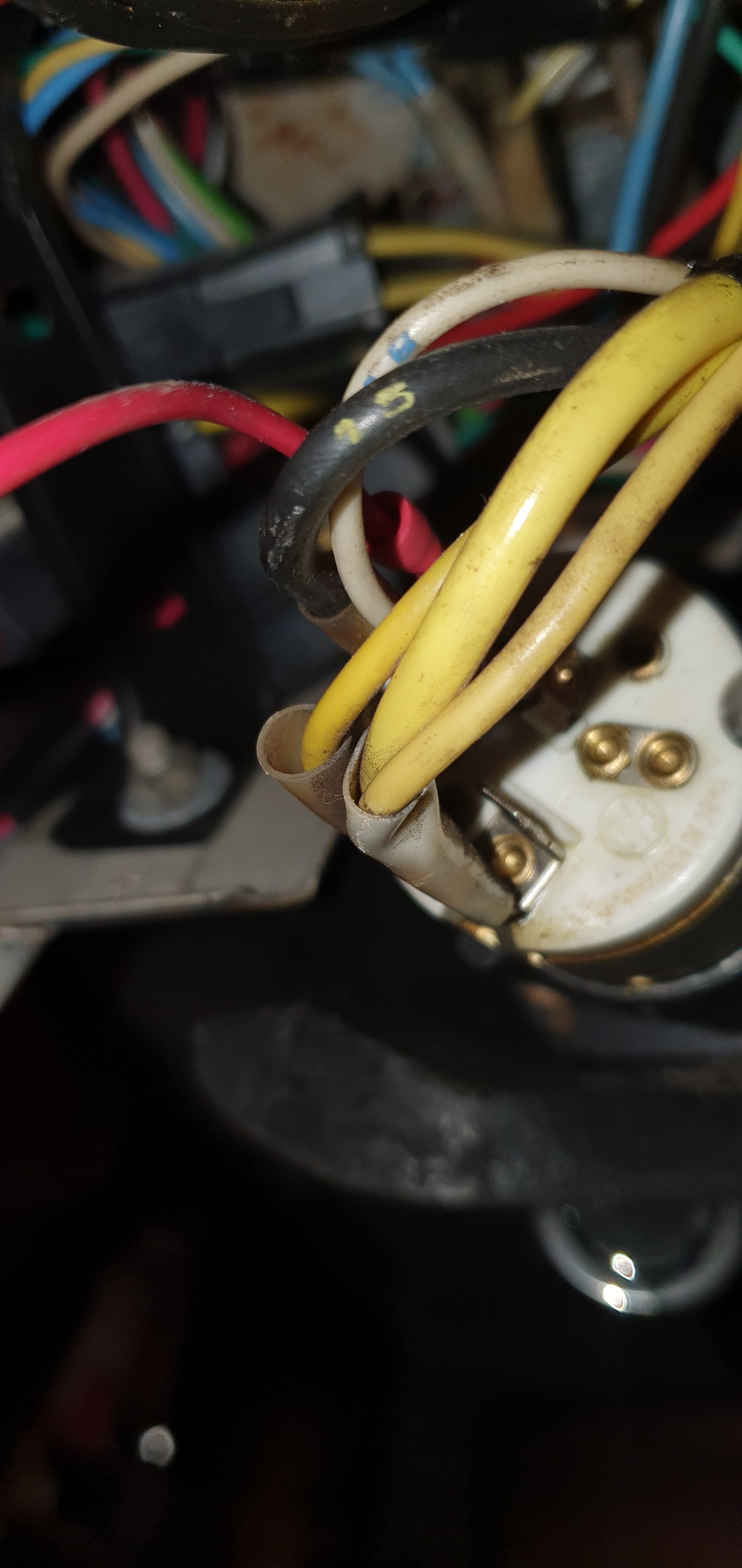

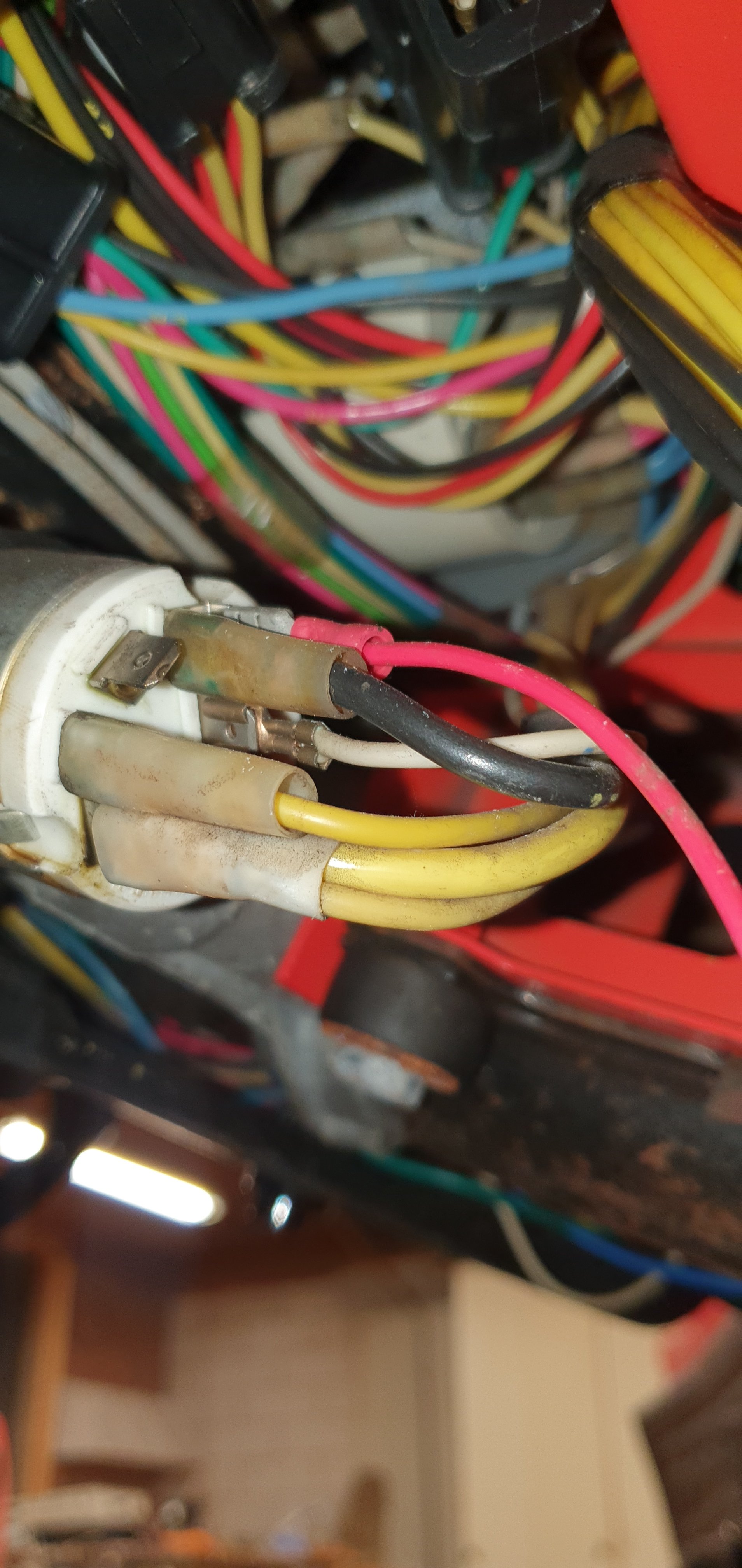

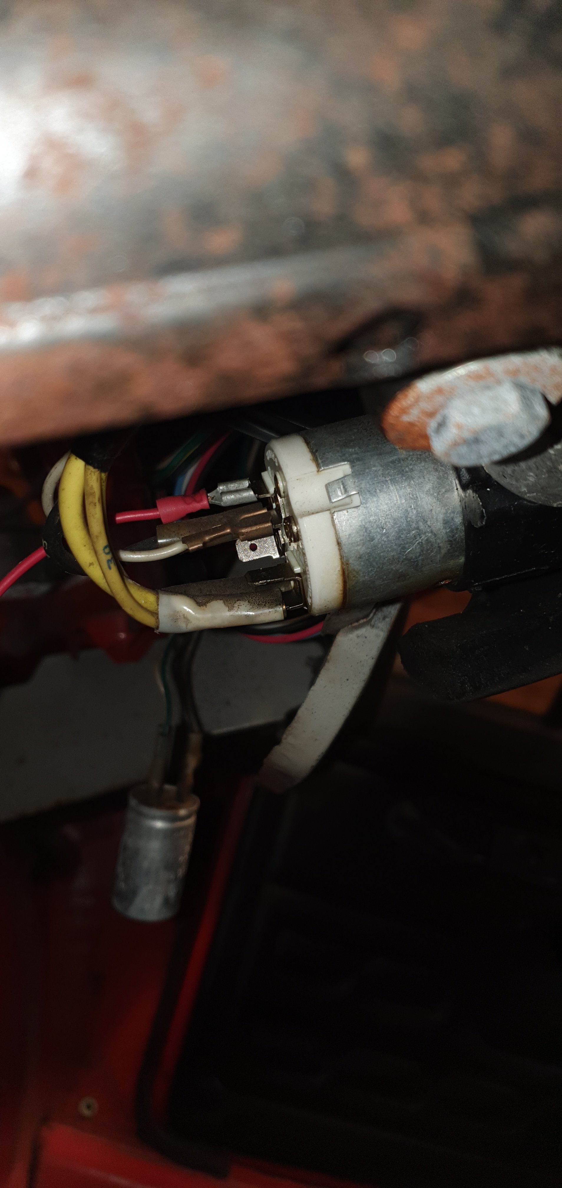

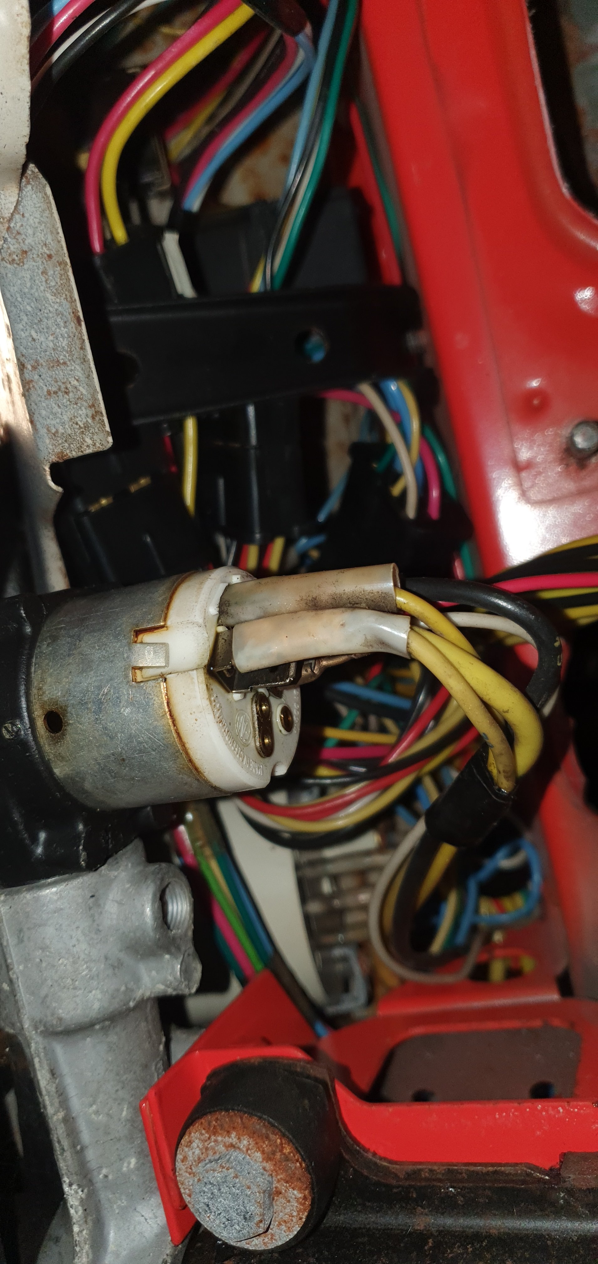

Yeah I believe so, sounds like your having as much fun as me... I've just done all brakes all round aswell as lines... Chasing a few unplugged wires also but it is getting there... still got a few bits to do before registration and inspection but pretty confident it'll be fine... I don't suppose you have a picture of the rear of your ignition switch at all do you.?
I can take one when I get back to the shop after work, all the wires in mine were yellow and looked the same if memory serves so I don't think it will say much, but can still drop a pic here

Yeah by all means if you have a pic for general reference I'd appreciate it, same as fuse box 😂 give or take a few wires the colours should be roughly the same to each I'd hope
Here's some pics of the ignition switch, the red one goes to the radio
