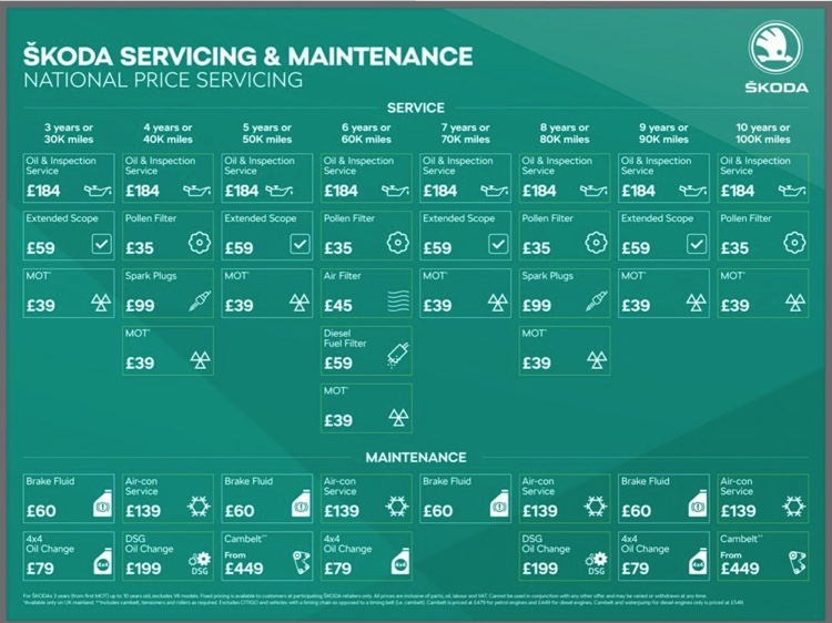

Prices are up from this on the Skoda Dealers Fixed Price Servicing and maintenance on 3-10 year old cars on Fixed Servicing at Participating Dealers.
EDIT 2.
I see @varaderoguy's link has the latest prices.
1135553596_ServiceSchedule.jpg.010f7f298e30d227a90f596bebce01ae.jpg.7a32aac51c9e4f8244909253ae1de96c (1).jpg
