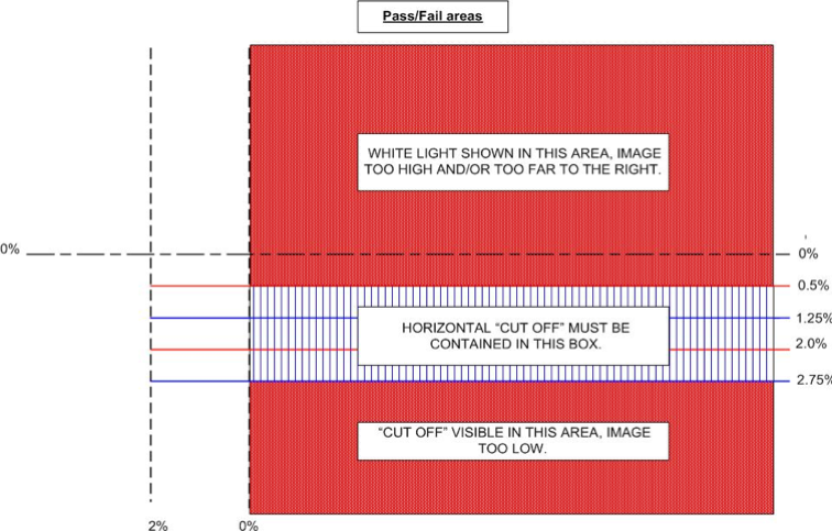

Cost to set headlights ?, no idea to be fair, your headlights "should" be set as to be legal and not affect other road users "now" hence you have an MOT. The problem stems from the fact there is a large "window" as to where the headlights can be set that will
pass an MOT......BUT thats not always the best setting for being legal and having better performance. Headlight range can be from 0.5 to 2.75% below the horizontal, mine where at 1.5, brought them up to the max of 0.5% and the difference at night was to be fair
like I had spotlights on as well.
I set these myself as I have access to an MOT garage and equipment, but any MOT station should allow you to check them for small fee I would hope and may even help adjust, it will be certainly cheaper than a cheap HID kit thats for sure.
If you decide to fit "better" bulbs, you may find the improvement of just the new bulbs is enough to satisfy you for now and then at your next MOT have a word when it's time to get on the beam setter and have a go then.
Attached is the "window" of where your lights can be, you will see a headlight set at 2.75% will be so much closer to the car and not give very good distant vision, compound that with a standard old halogen bulb and the performance will be
 quite poor.
