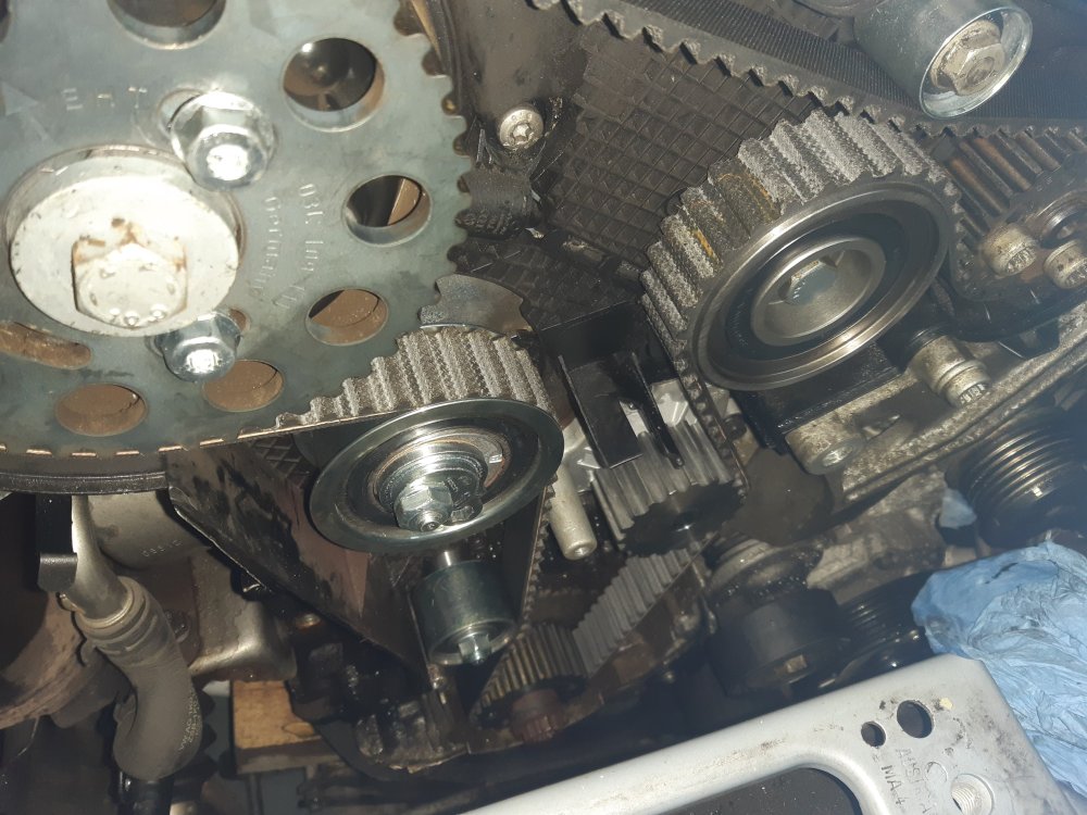

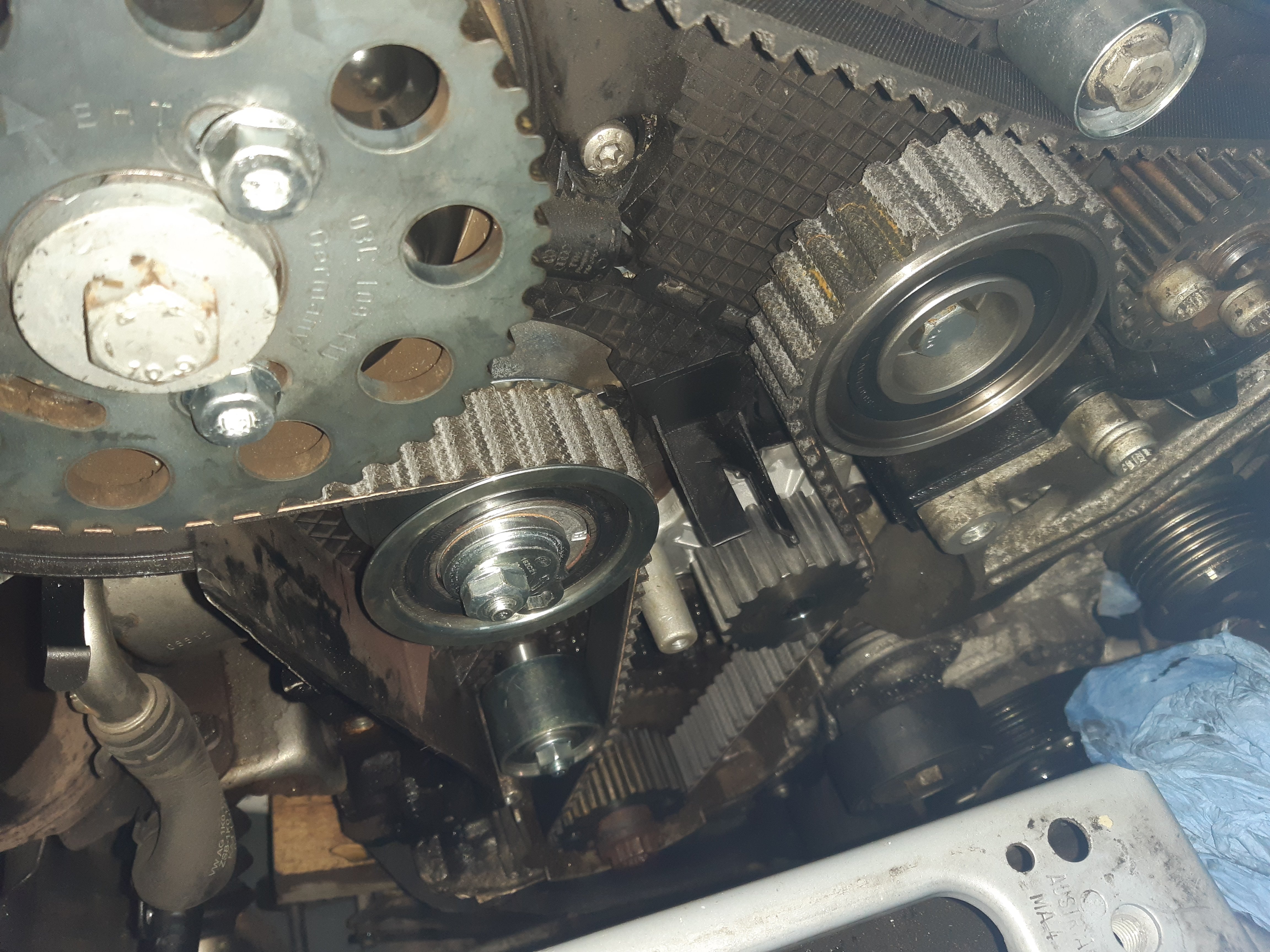

I own a skoda superb 2.0 Tdi. I am facing white smoke on startup after timing belt change. The smoke starts after 5 minutes of tirning on the engine before that it runs perfectly fine. Is there any way i can check and adjust my tdi fuel timing in vcds . The vehicle is equipped with UDS protocol so the measuring block option is greyed out in engine group.I am also posting a full scan of the vehicle

What your asking to do is re-map the engine I don't believe you can do this with VCDS.
Your engine code is CLJA 140bhp ? Did you time the fuel pump correctly?
You didn't have this problem before changing the timing belt ?

The fuel pump has to be timed. It's not as critical as the crank and cam shaft timing but it has to be fairly close. I'll see if I can find the Autodata print out I used.
Ok thanks also do tell me how to time the pump as in manually adjust the fuel pump or in vcds. The crank and cam shaft were both locked in place using special tools.
1 minute ago, Derbyshirebod said:
 I had also locked the pump pulley in place just as mentioned in the picture above using locking pin. I thought you are mentioning retarding it forward or backward after loosening the 3 bolts holding the fuel pump pulley in place. Can that be done because i feel my pump has advanced timing
It's difficult to see the fuel pump timing slot with the belt in-place. The reason for undoing the cam shaft and pump pulley bolts are so that the cam belt tension can be set correctly between the two pulleys and all the belt slack can be taken up by timing belt tensioner. The cam shaft and fuel pumps should be locked with the timing pins so their timing remains correct.
I don't see how changing the cam belt can have affected the ECU fuel pump settings ?
 That is what is bugging me. Even after following all the steps this problem has occurred. I just hope the fuel pump isnt going bad. Any way to check the timing om vcds for these engines?

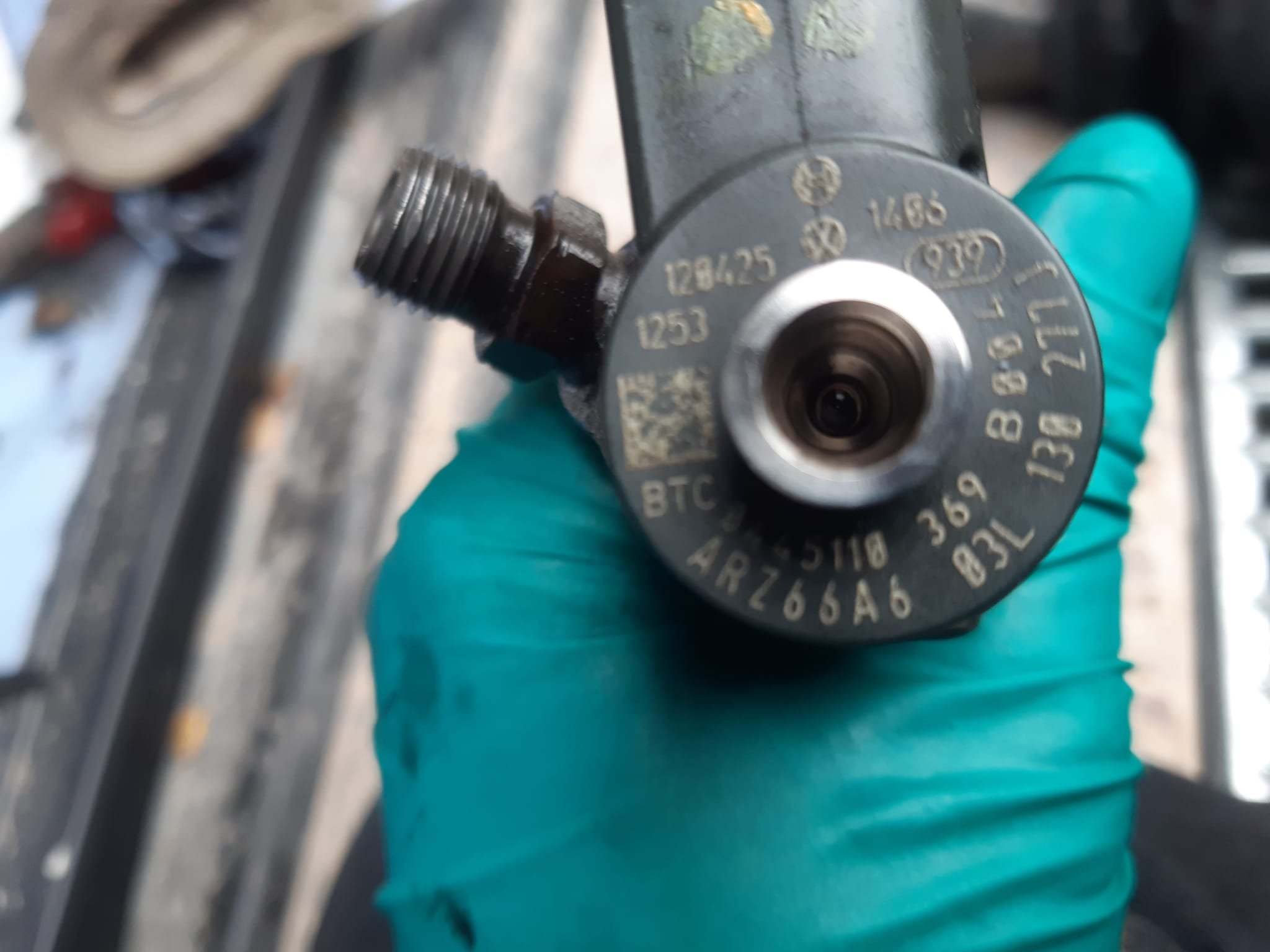

I don't know if your engine has the same injectors as mine? I exchange mine at my local diesel specialist as they have to send them away to be re-manufactured, cost me £840!
I have the exact same injector with same part Number. They cost 900 pounds here for the new ones
 From what I've read they are very prone to failing! I believe my car has had the injectors changed before as there are chatter marks on the injector sealing faces down inside the cylinder head. It took me ages to polish the marks away.
I bought my car cheap with a declared unknown engine problem It was the injectors. As I'm wanting to keep the car I decided not to gamble with trying 2nd injectors as they fail regularly there are a lot used ones out there and i wonder how long they will last ?
