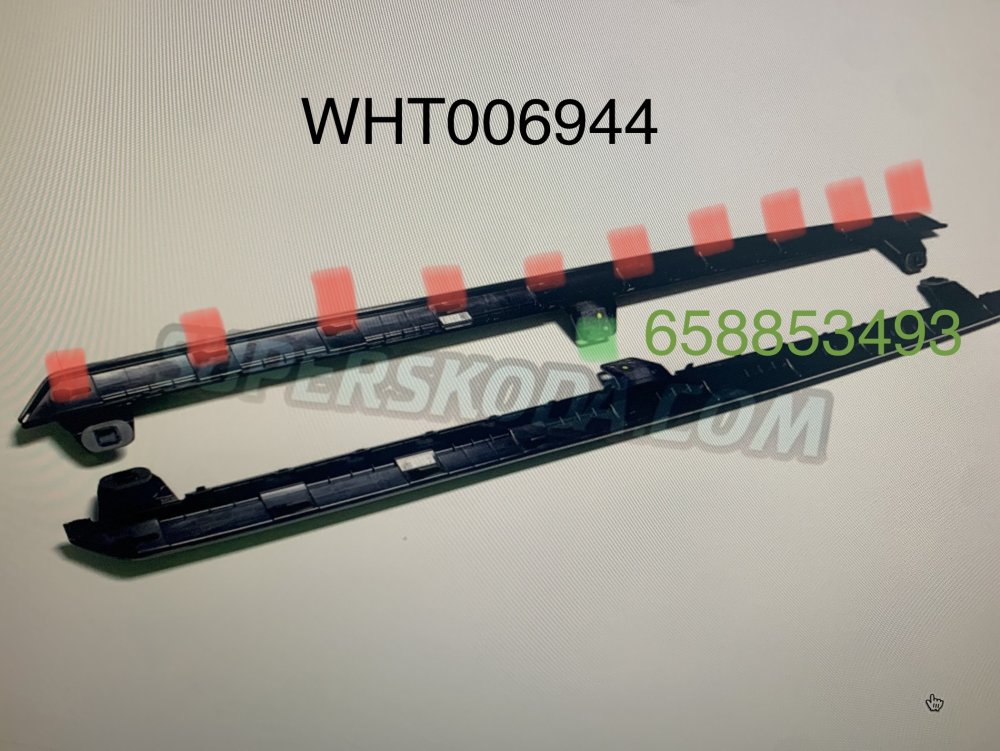

Hello, I mounted the front and the sides, the sides have 10 screws that are threaded to the WHT006944 sheet, it also has a staple in the center 658853493.
the reference of the moldings 657 853 856 F9R right, 657 853 855 F9R left
