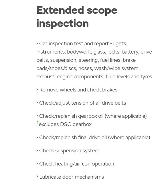

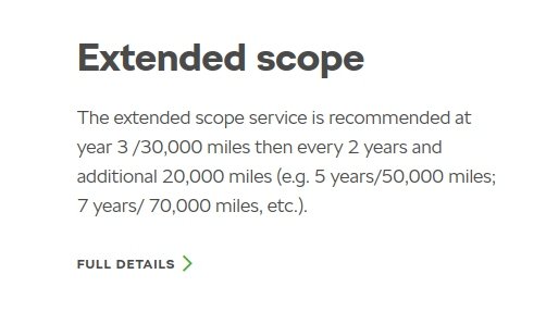

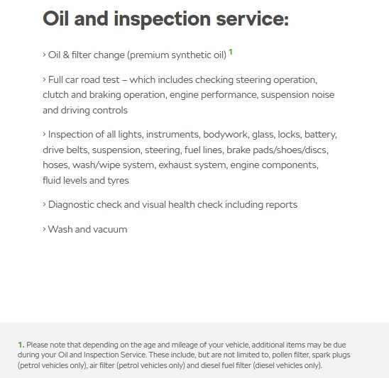

Skoda or a Skoda Dealership can show what is on their system for Servicing, Service Campaign or Warranty work, but showing Minor / Interim or Major services or Oil and Inspection Services is not enough if the extra work / parts replaced is not shown.
Best look in the Air Filter box then and see the air filters condition.
Regular Oil & Filter Services even at Skoda Main Dealerships does not mean stuff is done to the Recommendations or Guidelines or even a schedule.
A car from Cinch does not mean servicing is up to date as a member found out recently.
Look for a record of work done and when, like has the brake fluid ever been changed.
