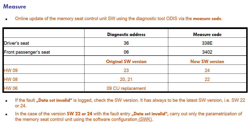

At least for the Octavia, the update is part of TPI 2049942-3:
