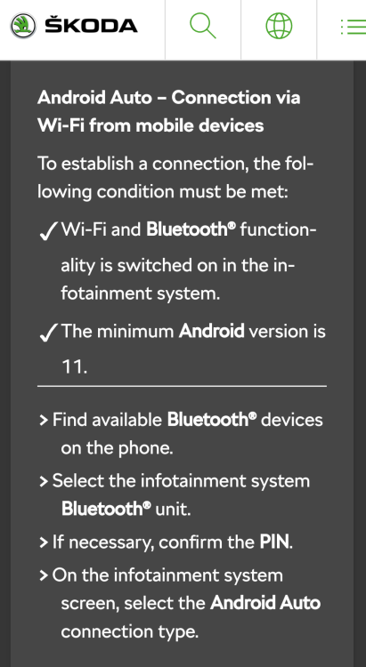

The online manual for my car suggests wireless should work, but needs Android 11 (I have 10 - so this may be the issue until I can test with a newer phone).
