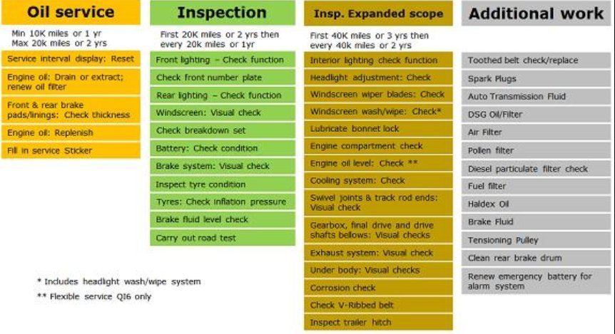

So that's MY2016, I was asking as their's a change for MY2017 in the maintenance book.

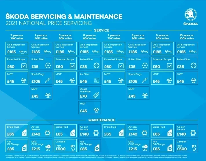

I am always amused when I see the servicing chart above, issued by Skoda UK, as the official timings for things from factory are XY, and Skoda UK take things off there own back to add a Z on the end to earn themselves money I presume.
Example 4x4 service:
Factory = Change oil every 3 years
Skoda = Change oil every 3 years or 30k miles
I always wonder why they decide they know more than the factory, and have the autority to slap on their own condition?
This is the same for the belt, it's supposed to be for "life" (rather open ended statement) but I myself would probably stick to 5 years (or check condition then, and every year after)
One thing I did see not shown on above chart is alarm battery at 6 years, probably skipped over by most, and really down to yourself to decide on that.

No chart was published for 2022. The website had the similar time / miles but price on application.
As to cam belt / cambelt & waterpump.  The prices on application for a 1.0, 1.2, 1.4 or a 1.5, then diesels or 2 litre TSI's is all getting mixed up with the simplest / cheapest, least labour jobs having crazy prices quoted at UK main dealerships.
eg. Not the easiest / least labour with a 1.5 TSI.  Many going to get a quote or the work done @ 5 years are in for a shock.
