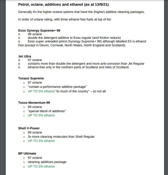

Until they or someone find the issue maybe get a tank of E5 super unleaded 97 or 99 ron petrol in rather than E10 95 ron if you use that.
Summer spec E5 & E10 should now be in the filling station.  Just £3 extra a tank fill to see if it works with Tesco Momentum 99 or Sainsbury 97 ron min.
340214144_1384336435_Screenshot2022-01-3014_03_59.jpg.d43b66a38bf086423e31cbd1b02722b8(1).jpg.dce3a2706e11f7c315d6b050e3a54835.jpg
1179912860_922218293_Screenshot2022-09-2115_58_57.jpg.3711dc86397a804fc83f268add4ae736(1).jpg.606196879c2532f67305f1ec411800c6.jpg
