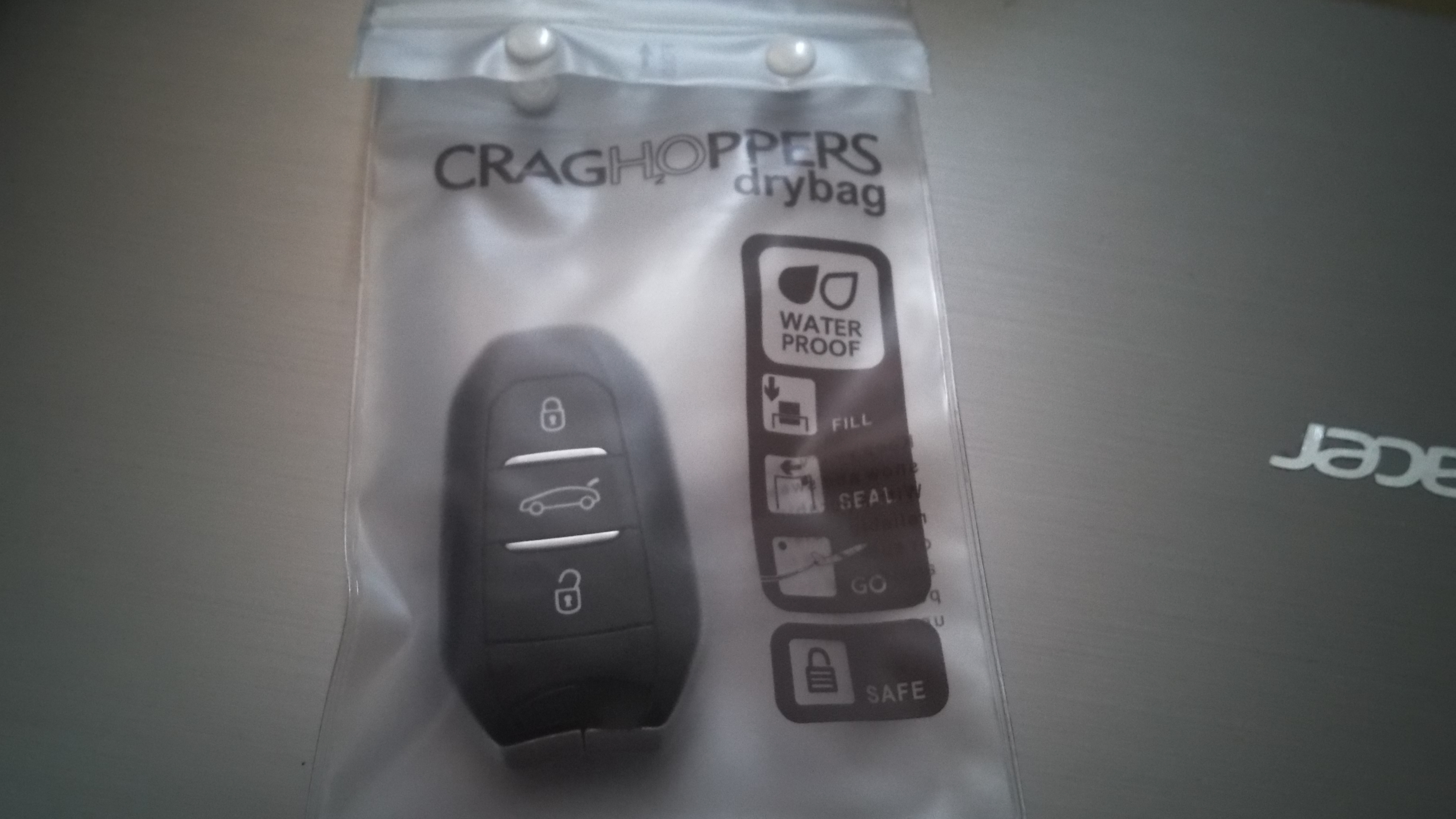

As to Dry bags for keys,phones etc, i used them for years, perfect for the job.
