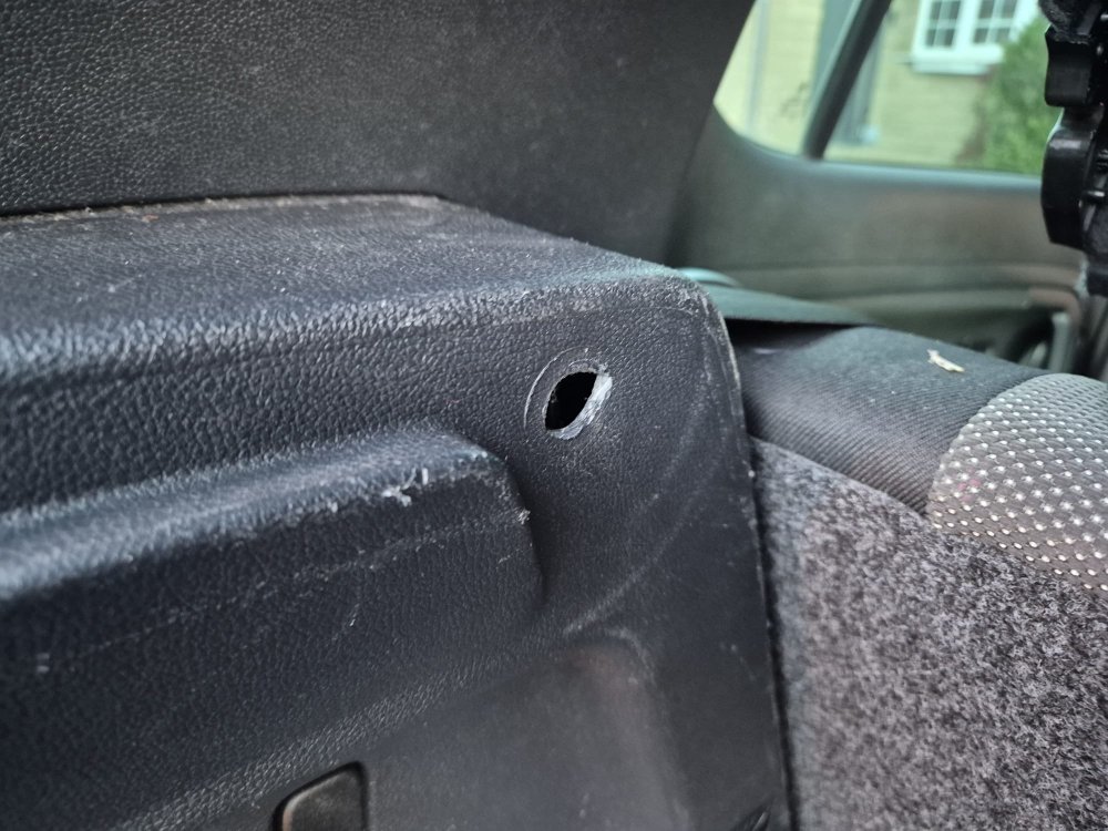

I tried supaglue but it didn't last long. What did work was to drill a hole and then while holding a piece of metal with a hole in it with long nose pliers then screwing a self tapper into the metal. This has lasted a couple of years with no problems.

I drilled a small hole through and used those diy toggle screws pushed through and tightened. A bit of glue on the cracked bit as a back up to secure in the correct place. Lasted ages and all you could see was the screw head. You could paint that to blend or even put a number plate screw cap on and do it

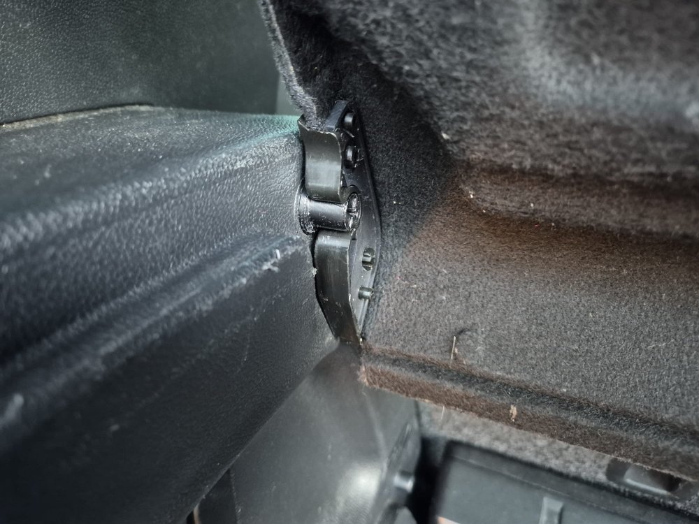

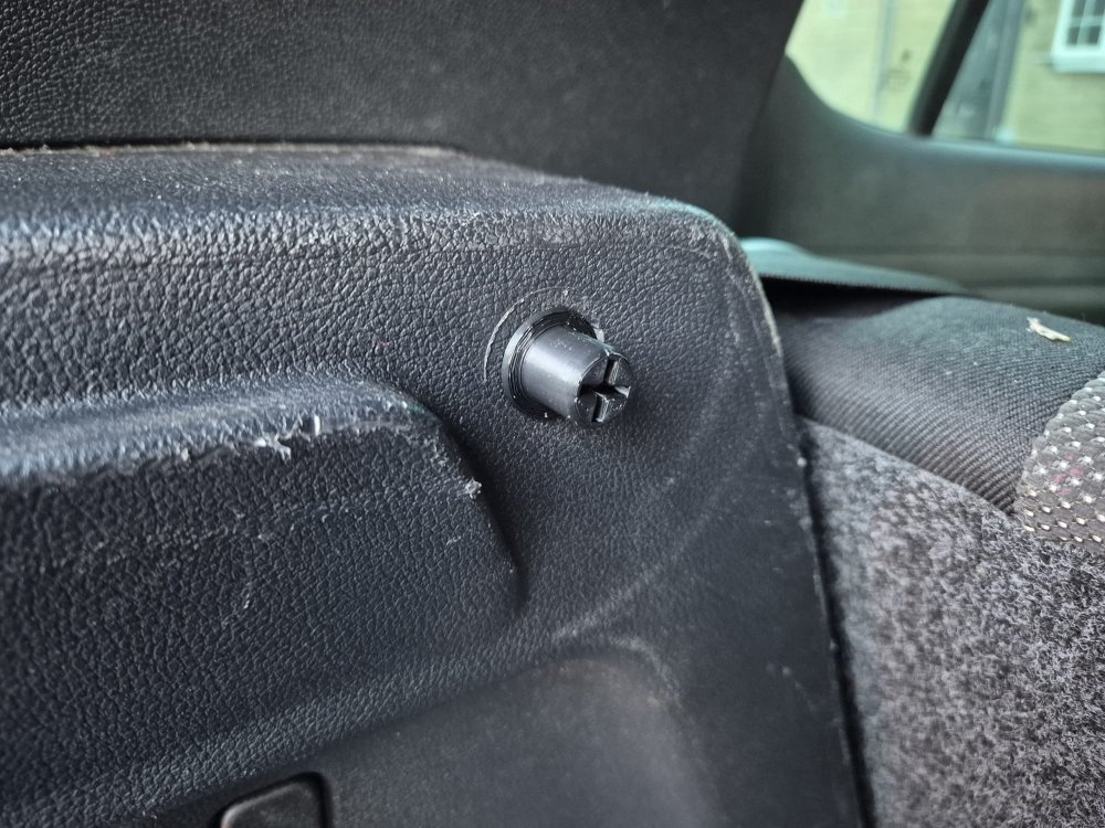

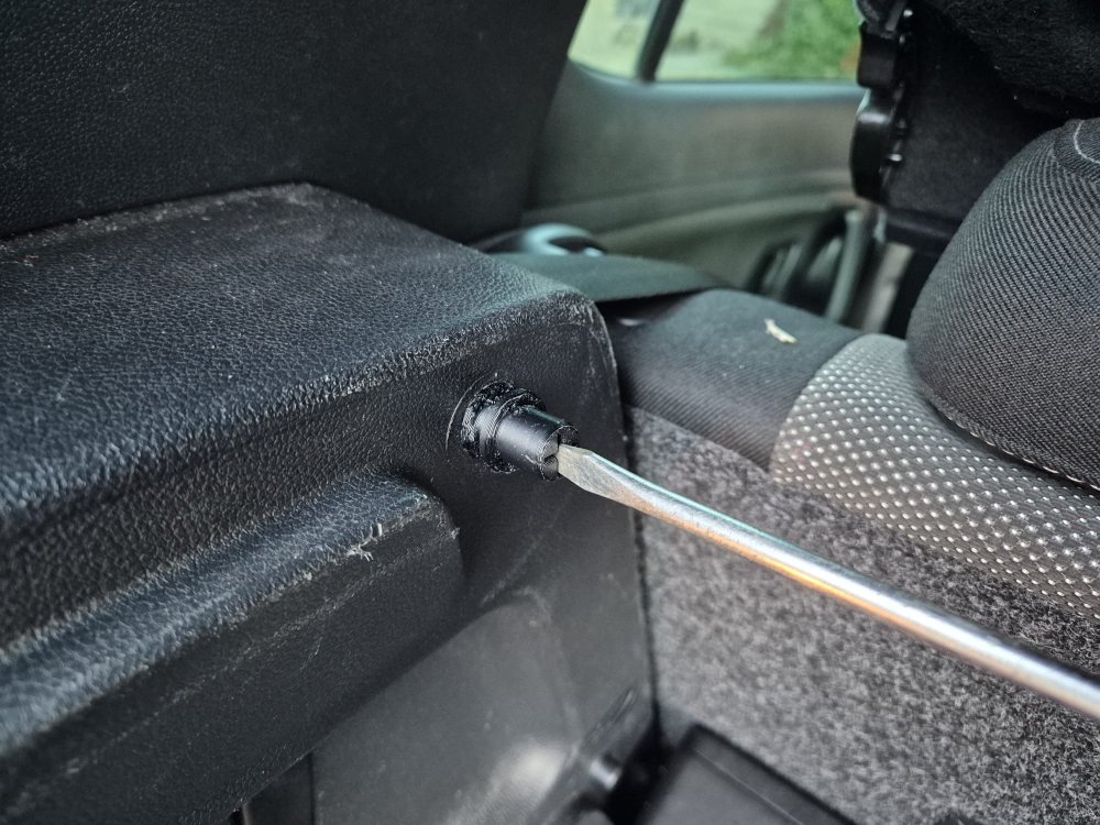

I had the same issue on both sides- so i designed these easy to fit screw type repairs- they work a treat!!

Thanks, I have created a model and printed in PETG. Not ideal but I will test for now. I may finish getting your version if it does not works well.
