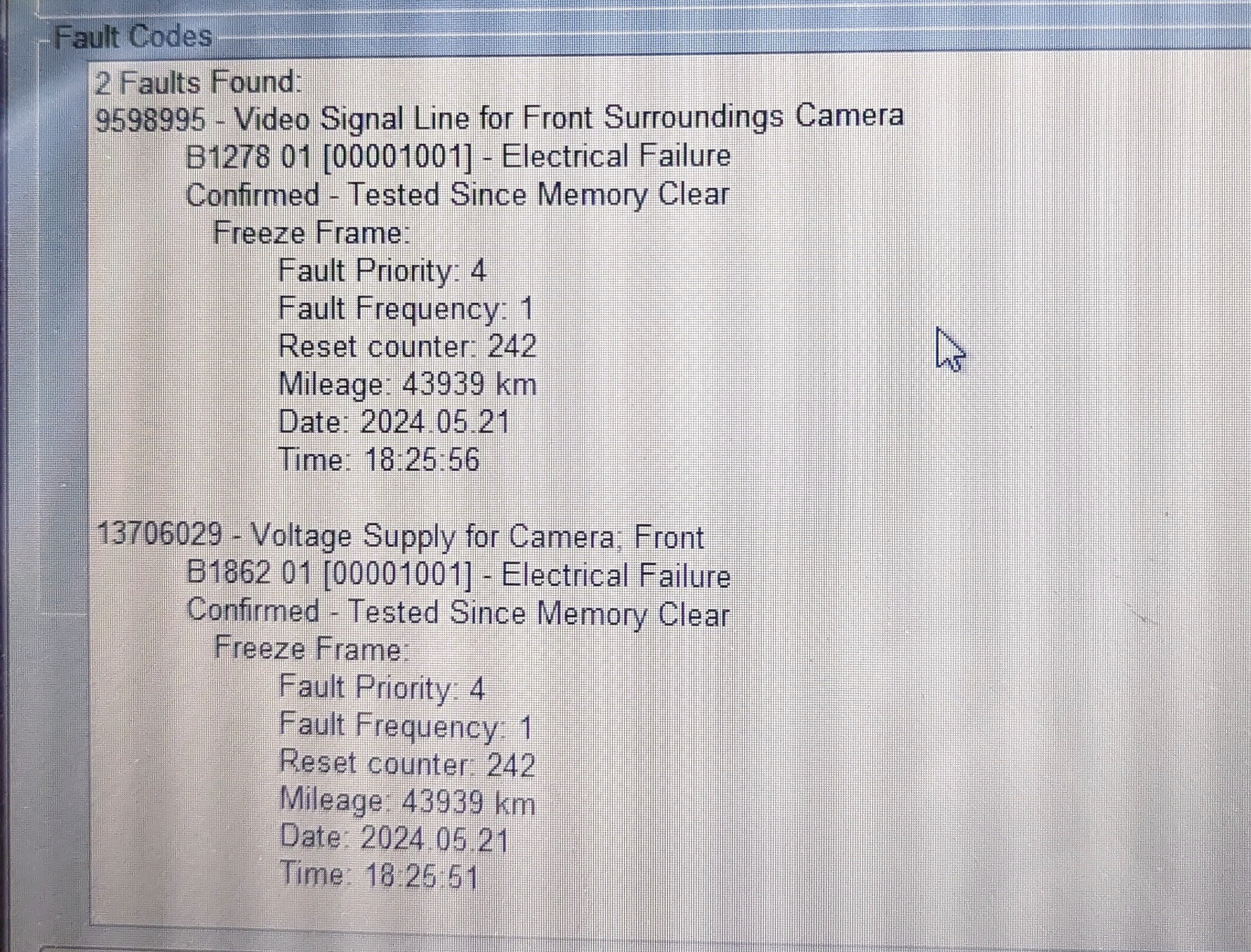

I finally bought myself a VCDS.
Attached are the codes. @ApertureS is it suggesting it is a wiring problem, or the camera is dead?
Many thanks in advance for the help.

That to me indicates either a damaged wire or unplugged connector.
or the camera has completely failed.
first thing I’d be doing is checking the connectors are all in:
back of the camera in front grill
left side chassis leg connector
left side lower a pillar in car
control unit under right seat
if all of these are okay then next would be continuity tests for the wiring, which need very small pins and go as follows
pin 1 to pin 4
pin 4 to pin 1
pin 2 to pin 3
pin 3 to pin 2
and these are pin outs at the camera connector and at the control unit connector.

Left side chassis leg connector was loose.
Many thanks.

Me too. Finding time to tackle it was the biggest issue, but I managed it without taking the bumper off.
I was feeling a bit tough last time I did it, and there was a chance that I did not properly connect the connector.
When I dropped the left hand wheel arch, I could get my hand In enough to check the connector.
