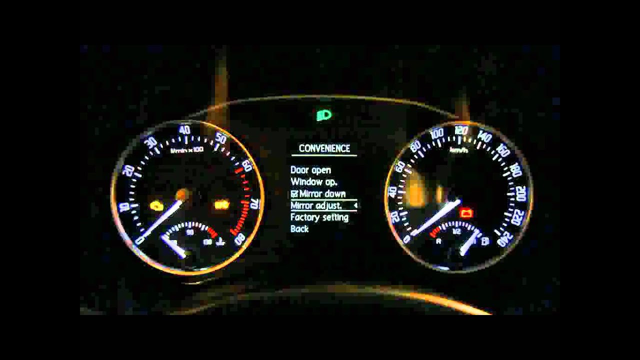

I have found and selected "Mirror Down" option in the dashboard display - I found the same feature with VCDS: Central Locking block. The mirror won't dip when I reverse.
I have put the mirror switch to "R" - the car is left hand drive from Norway, the parking sensors turn on but right mirror won't dip down. Both mirrors can be adjusted without any issues.
Has anyone had the same issue, what would be the issue here?

I don't have memory seats, nor my mirrors have an option to fold automatically. I heard that opinion before, when I was trying to turn it on by VCDS, some were suggesting online that you don't have to have memory seats in order for mirrors to work.
ย
What mislead me that I have this feature is option to turn it on or off in the dashboard settings, my reasoning was that at least they wont that have switch option there. ๐Ÿ˜•
Thanks again!
