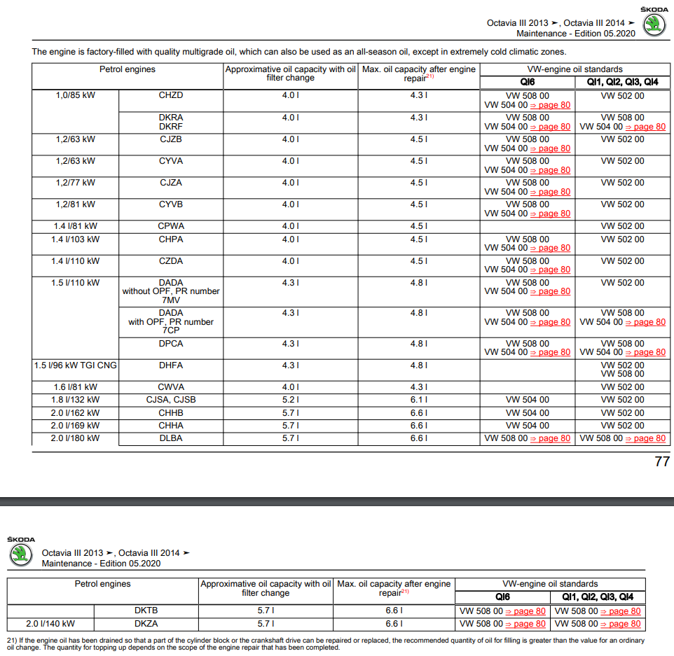

What's the oil type for a 2018 vRS 245? The handbook doesn't tell me and online retailers are contradicting eachother.
VW 508.00 for a 245 :)
You are fine with Oil to VW504 00 / 507 00.  so 5w 30 FS III or 0w 30 FS III if topping up or changing oil and that is what is in.
If last time it got 0w 20 FS IV at the service use that for topping up.

Skoda never started putting in VW508 00 / 509 00 until before the WLTP came in, they were not using it in 2017.

Thanks for the replies. So 508 equivalent is 0W-20?
Yes but that doesn't mean you can use any 0W-20 oil... It still needs to meet the VW 508 00 spec :)
