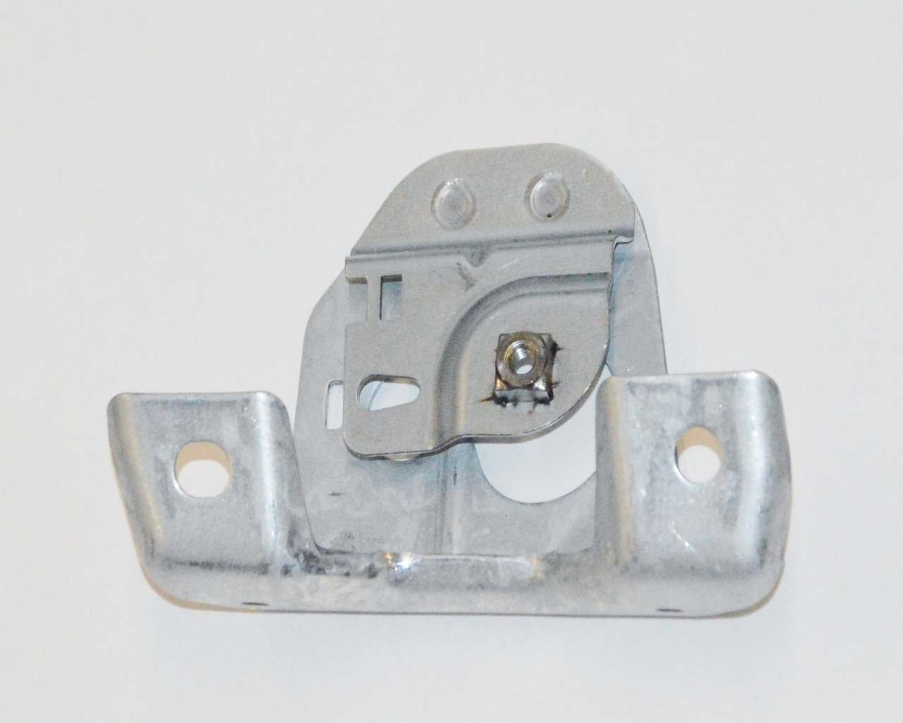

If its anything like the superb, the mounts are not there but can be purchased.
As well as the brackets, you need threaded rivnuts and the bolts to go with it.
Then cut the headliner and the trim pieces need fitting around it.
