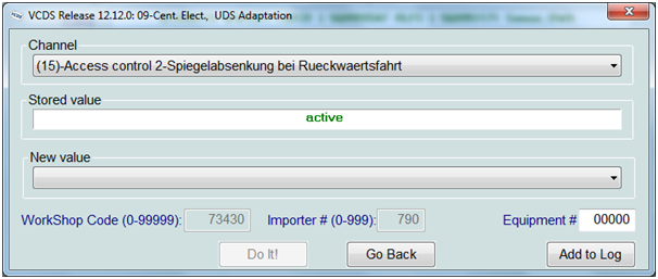

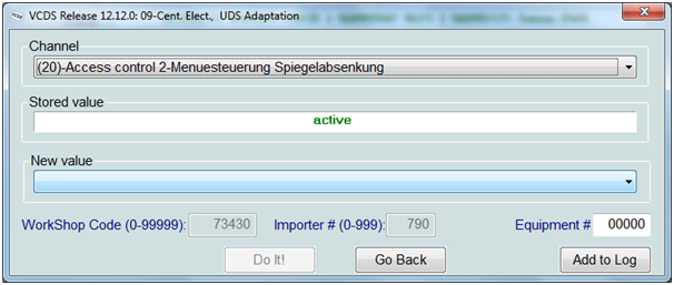

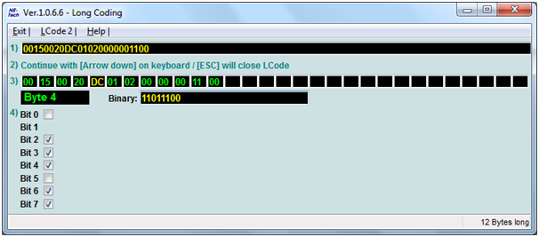

You have to check/change the settings in 2 modules.
Passenger Door module - address 52
Coding, Byte 4 make sure bits 2 & 3 (starting from bit 0) are set i.e. the hexadecimal value is xC
Central Electronics module - address 09
Security Access - enter code 31347
Adaptation - check/change the channel called "Access control 2 - Spiegelabsenkung bei Rueckwaertsfahrt" is active
Adaptation - check/change the channel "Access control 2 - Menuestuerung Spiegelabsenkung" is active

Okayyyy... this looks way beyond my capabilities at this stage of ownership, perhaps forever. What are you using to see/amend this info?
As the attached screenshots say, VCDS.
