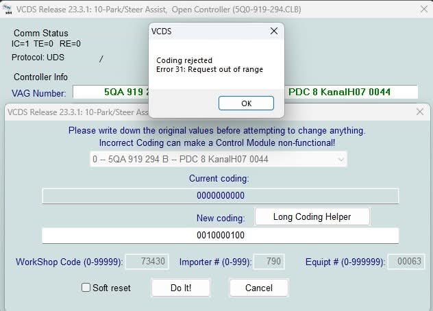

A few dans ago I lost park sensors.
With VCDS I saw the ECU coding was "lost" to 000000
When I try to re activate trought coding I got this error.
I think the ECU is dead.

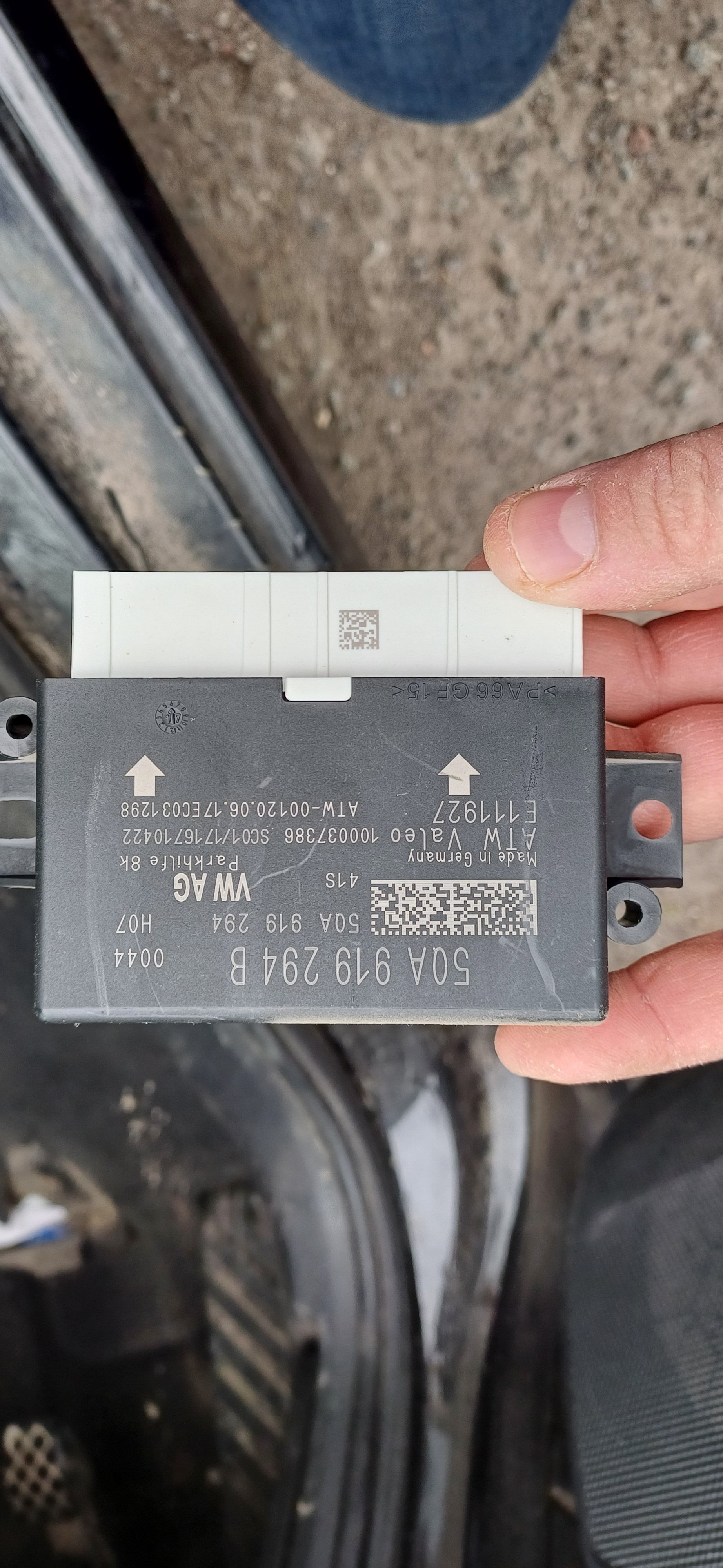

I watt to know if I can buy another one with the ref parts like mine and I dont care about the others inscriptions on it or if I need one with almost the same?
Ie mine have E111927 (5e5 2017 facelift) on it, the cheaper (and older - from golf mk7 2013) one have 305149.
After writing this, I think I will be appreciable to put more money to have a similar one.

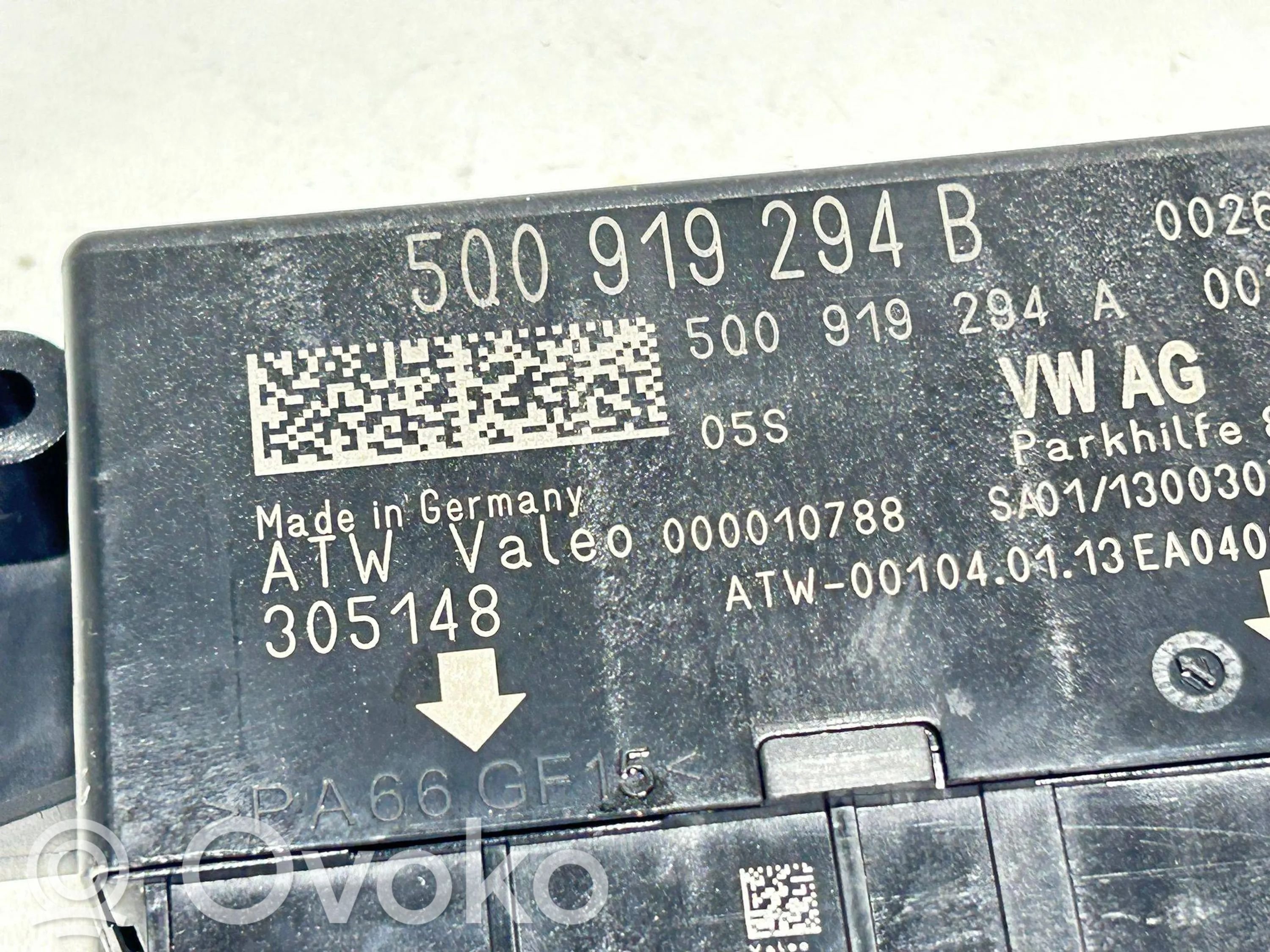

Cheapest one (2013)
o-6fcd78535f0a1f35caa45cfff12e9a58-volkswagen_golf_vii_parkavimo__pdc__davikliu_valdymo_blokas.jpgMore expensive (and newer one 2017)
o-083dda938a028bc0c1a23debb5430697-seat_ibiza_v__kj__parking_pdc_control_unit_module.jpg
Ffs the cheapest one is not the same lfmao
I bought the module on Ovoko on a best seller from Lituania. 10 box + 13 shipping +1,99 services fees.
