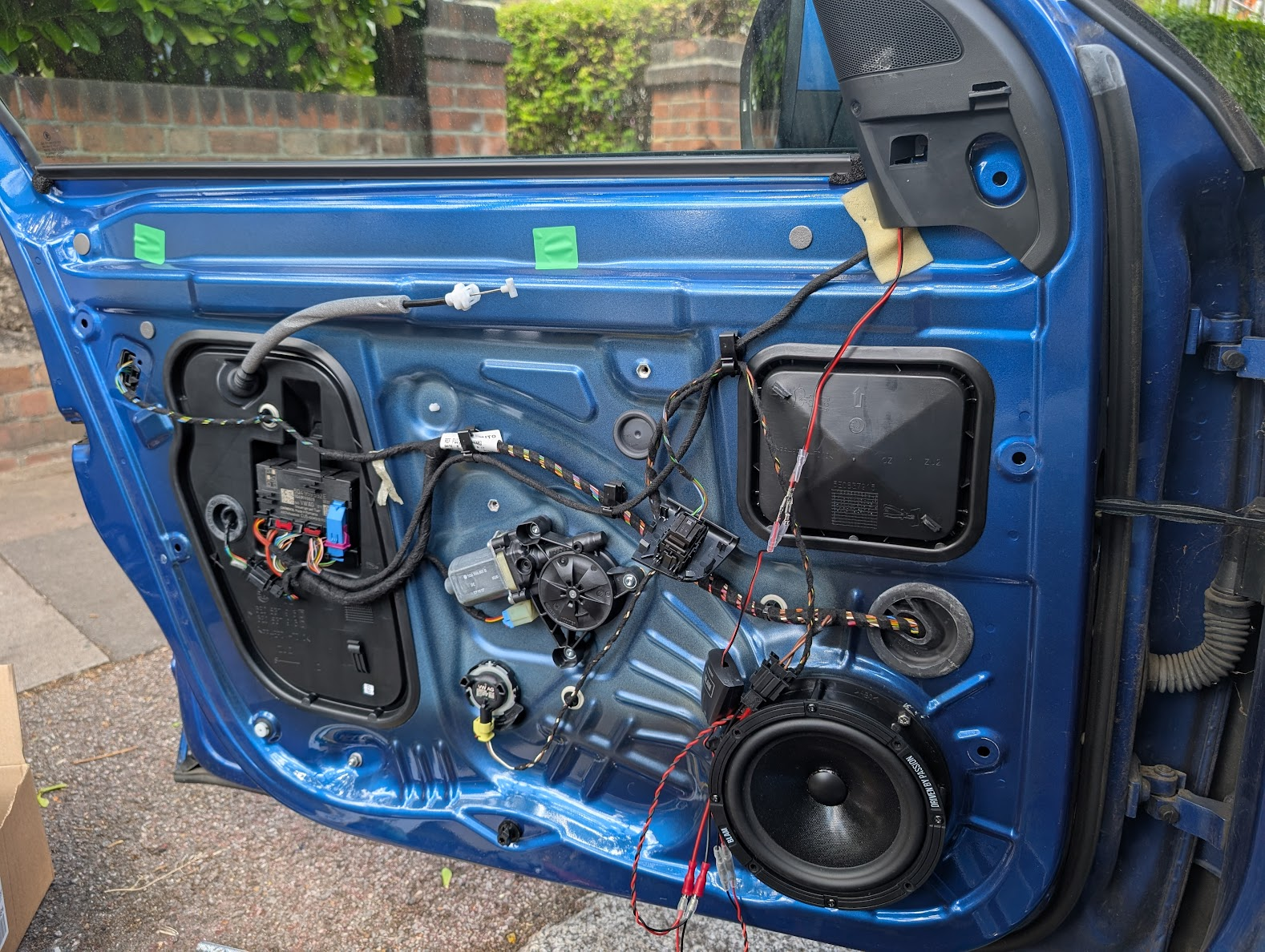

I replace with a Skoda 165mm (6.5 Inch) complete BLAM EXPRESS speaker upgrade fitting kit from inCarTec
https://incartec.co.uk/product/Skoda-165mm-6-5-Inch-complete-BLAM-speaker-upgrade-fitting-kit-SFK-SKO1-ES165?srsltid=AfmBOoo6o72_ZcY4joW5lXKzjbIuNGJ9tMba1HSSJlaUSgXgpXoWhQsn
It's a bit of a pain to do the tweeters as you need to cut some bits out of the trim and then glue the new ones in. I used too much super glue and it came through the grille (as seen by the grey patch in the photo). One of the hardeest parts was pulling the square panels out to put the sound deadening stuff inside the door. Not sure if its worth doing that bit tbh.
Also took my longer as I forgot to reattach the door opening cable to the handle before putting the door car back on.
