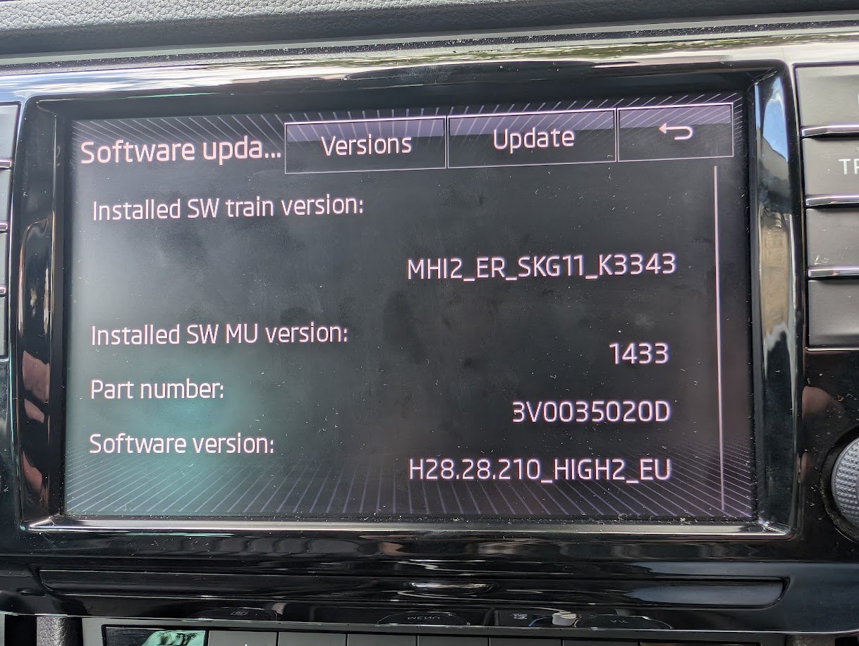

Was the old screen bad well? I managed to get mine done remotely with a lot of hacking and me buying a UART board and a very helpful bloke in Telegram. I spent a few days beforehand driving around listening to a Bluetooth speaker in the car and hoped I wouldn't have to access anything on the screen
How-to Guide to Upgrade MIB2 to MIB2.5
Long press on the power button, screen will go dark and then keep pressing to reset. I felt exactly the same when I messed mine up. There are many helpful people in the telegram group that can advise if still wonky.
they aren't both 8" though? One is 8" and the other has a 6" screen - it has a massive bezel around it. (also I sold my 3V0919606 for £40 on eBay so you can still get something for them)
I really like mine. I pretty much only use Android Auto so don't miss the physical buttons. Just make sure you use a good SD card. Pretty sure mine was a fake and didn't have the capacity it claimed so the installation files weren't actually on it.

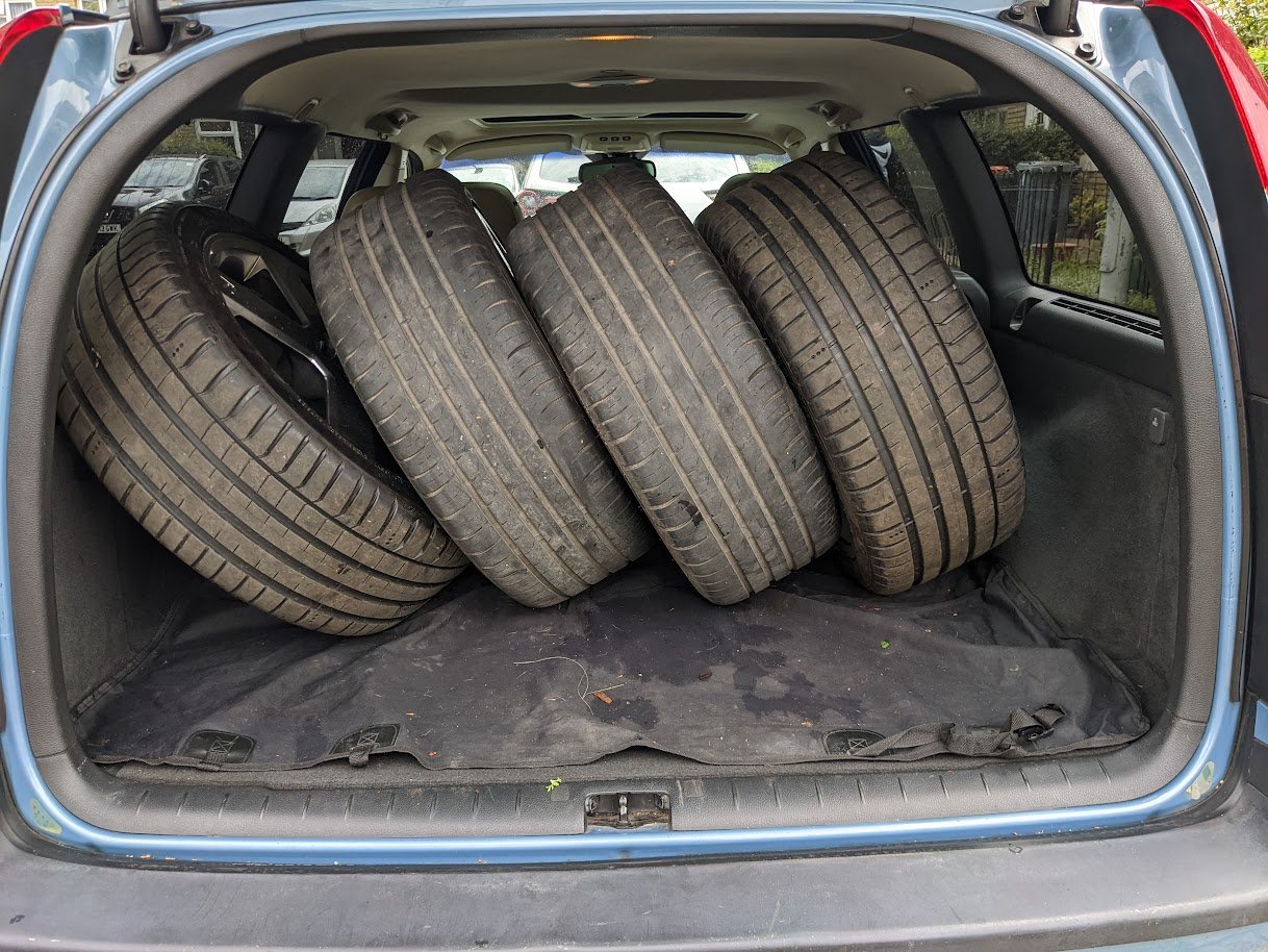

I do miss the ability to drop the passenger seat from my old V70R. Also miss the boxiness of the boot - not sure the Superb could get 4 * 18" wheels + tyres without dropping the seats. (I do not miss the fuel bills or the funny looks I'd get when trying to navigate tight car parks)
