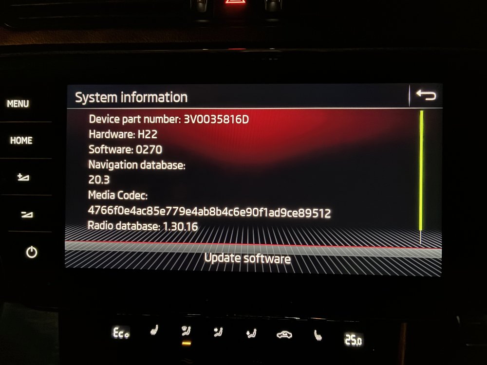

I’ve just purchased a 21 plate 1.4 tsi iV. Does anyone know what code/number the up to date system update is? Mine is on 0270 as you can see from the picture.

Thanks, but that’s all a bit above me. Just trying to find out if it’s out of date and what it should be now.
It is out of date.
It should be 332 now.
It goes: 270,276,278,306,308,324,330,332.
If I were you I’d download 308 and 332 and update them in turn. Everything is in the post I linked to.

Shouldn’t take long at all. 10mins for each update. Extract them to the root of the USB but just do one at a time just to avoid any issues.
So 308 on first. Put the usb stick in the car. Press and hold menu button until it asks you to update software and reboot to engineering mode.
It will reboot with a black screen and red text. It’s touchscreen (and some will be double tap) and should be intuitive.
When 308 has finished, it’ll reboot back to normal mode.
Then remove the stick, format it and copy on 332 and then follow the same process. I’d say you could be done within about half hour for everything.

Success!! I managed to get it done with the assistance of my daughter. Thank you very much for all your help.
