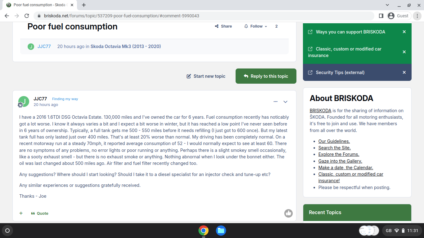

The weather has been cold for the last two weeks, though I don't think that alone can make such a huge difference.
