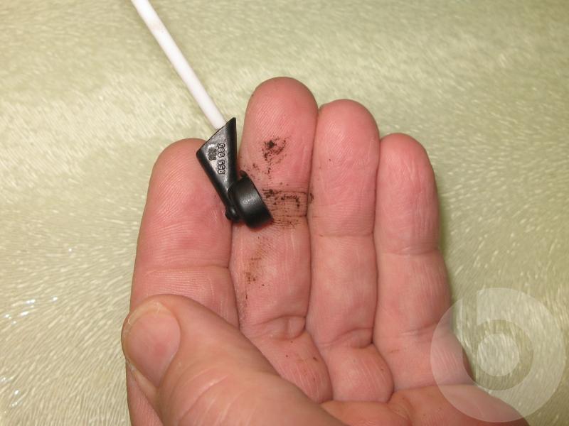

How to clean out the rear washer jets
Thanks to this site for the tips! A good soak in piping hot water & detergent, a poke with a pin and a blast out with a can of compressed air and hey presto! works as good as new :D Even with cheap Asda washer fluid tee hee.
