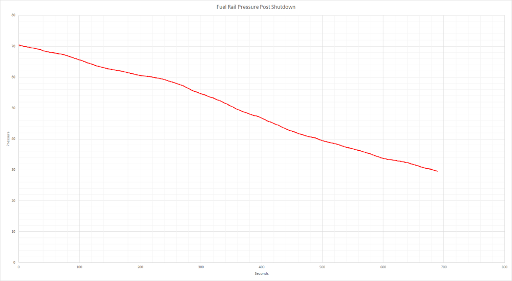

1.4 TSI new injector - was running great........
Hey all, Have previously posted regarding misfires and rough running / poor acceleration on a 1.4 tsi (122 caxa) octavia. We ordered a new injector, and whilst fitting it elected to clean out as much as possible of the carbon buildup in the intake. The car had done 86k miles at that point, and the state of the intake valves was pretty horrific. I've attached a few photos, which aren't the clearest but came from a cheap endoscope camera - it may tempt some of you to check yours! Whilst we couldn't reach all of the valves due to the fixed runners, the valves had significantly less build up afterwards. The car since has accelerated significantly better, fuel economy seems to have improved and it's just generally a nicer drive.... or it was. Now there is a loud ticking injector like noise when on the throttle, which vanishes once you take your foot off the accelerator and the ecu cuts fuel due to overrun. What I can't fathom is, where the noise is coming from, whether it's a new injector that's decided it has had enough or if there is some other issue. If anyone has any ideas I'd really appreciate it, unfortunately I have a feeling I'll need to replace the other three injectors which a friend insisted, but at £130 each they aren't a cheap outlay to potentially fix the issue. Maybe worth noting, when I used the screwdriver-stethoscope on the hpfp it's very noisy but I don't think that's the ticking noise that has appeared. Car has done 2000 miles since injector replacement without issue before this ticking started. Any help would be much appreciated, Thank you.
