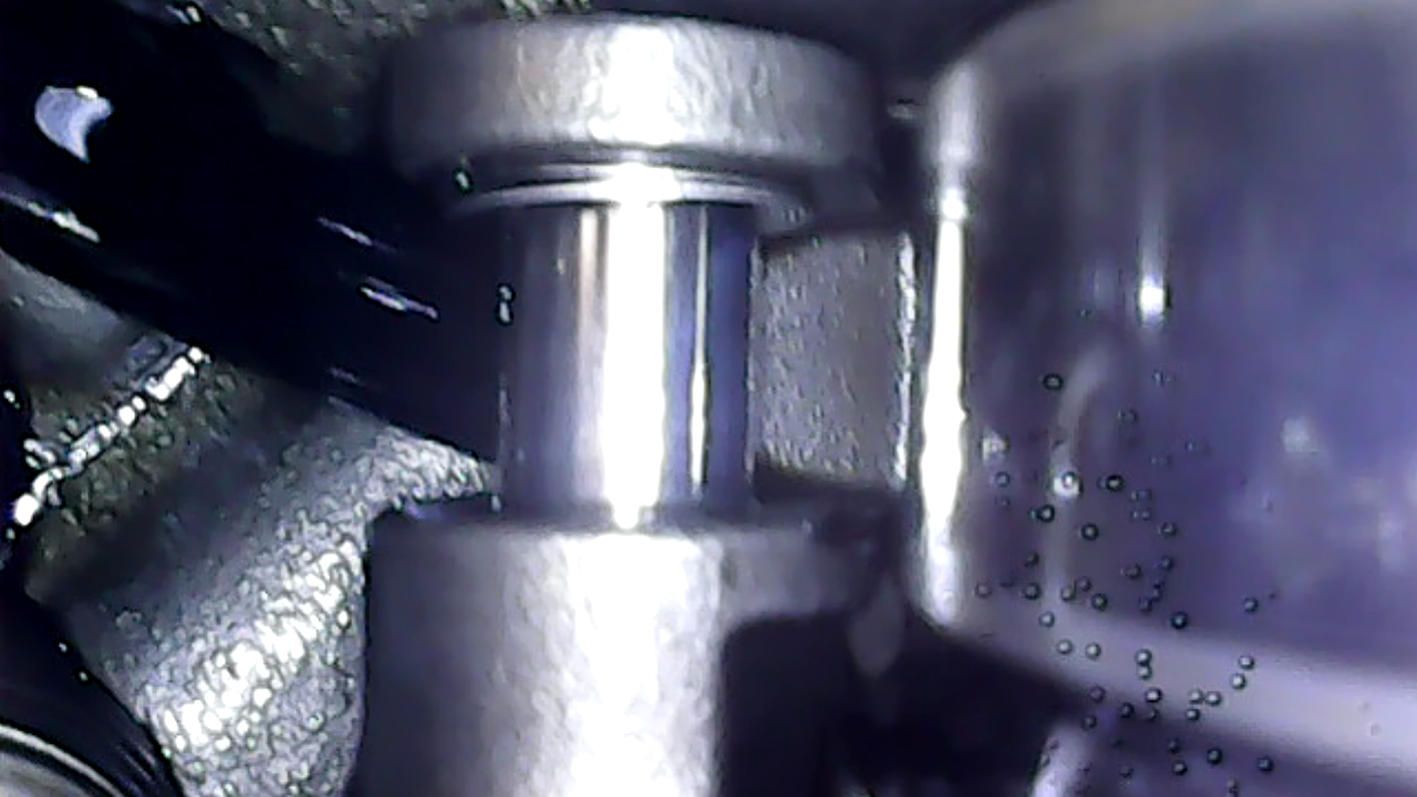

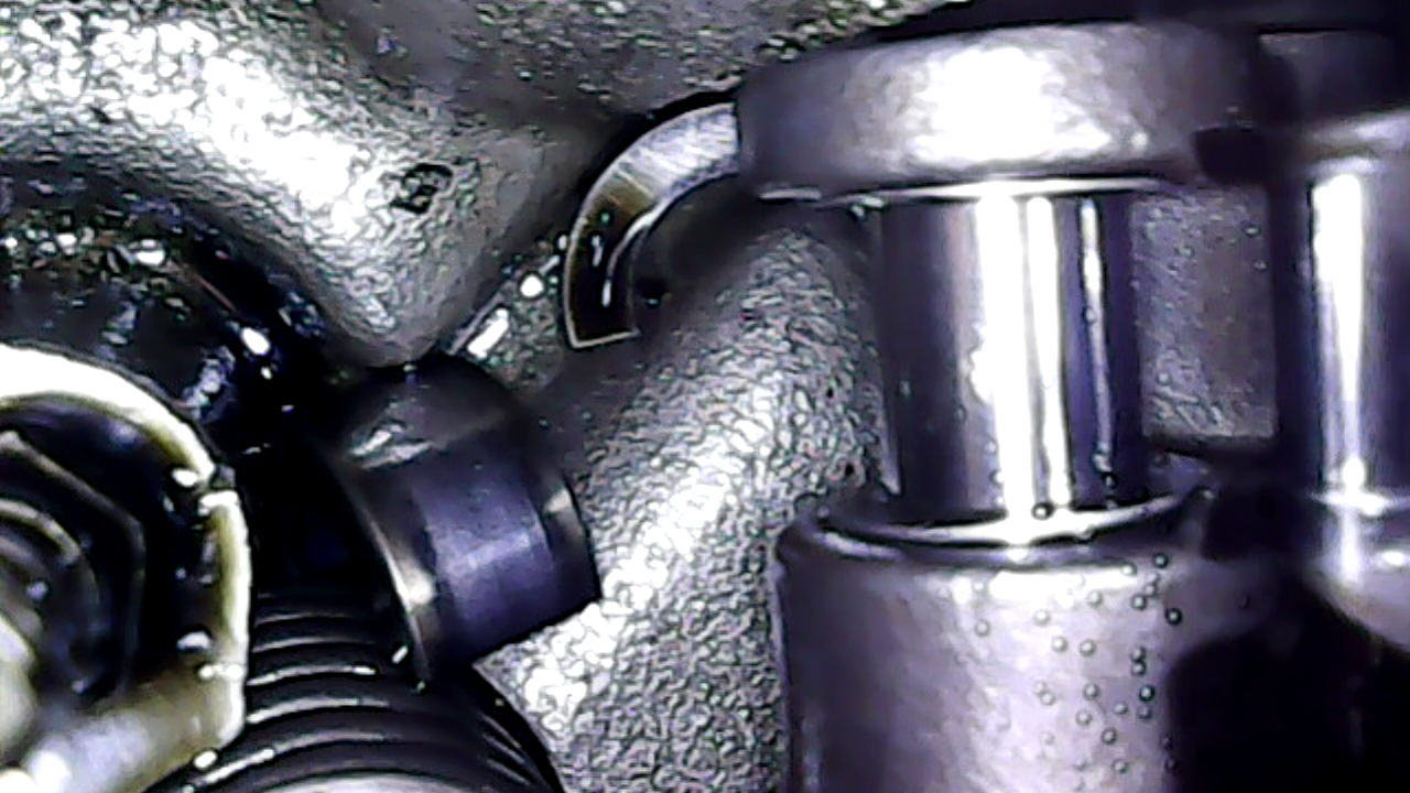

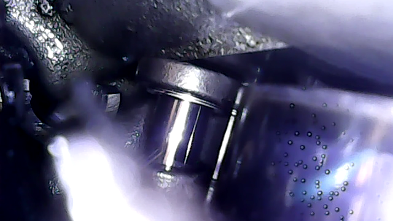

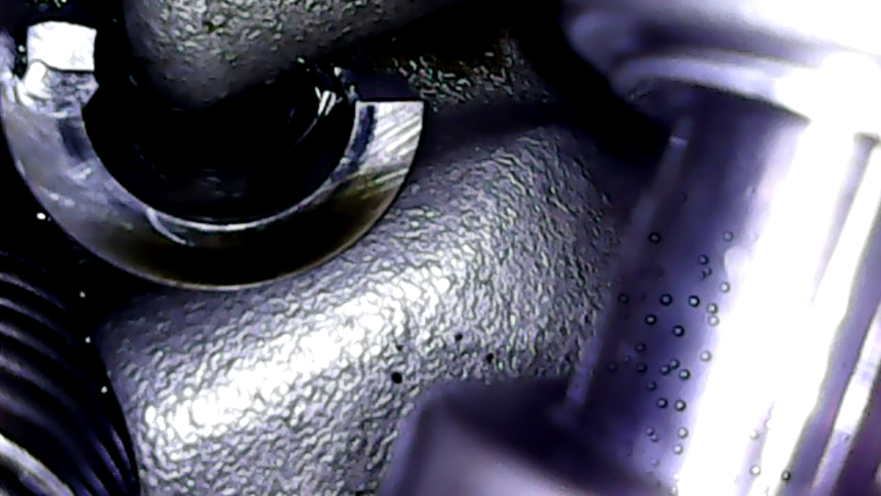

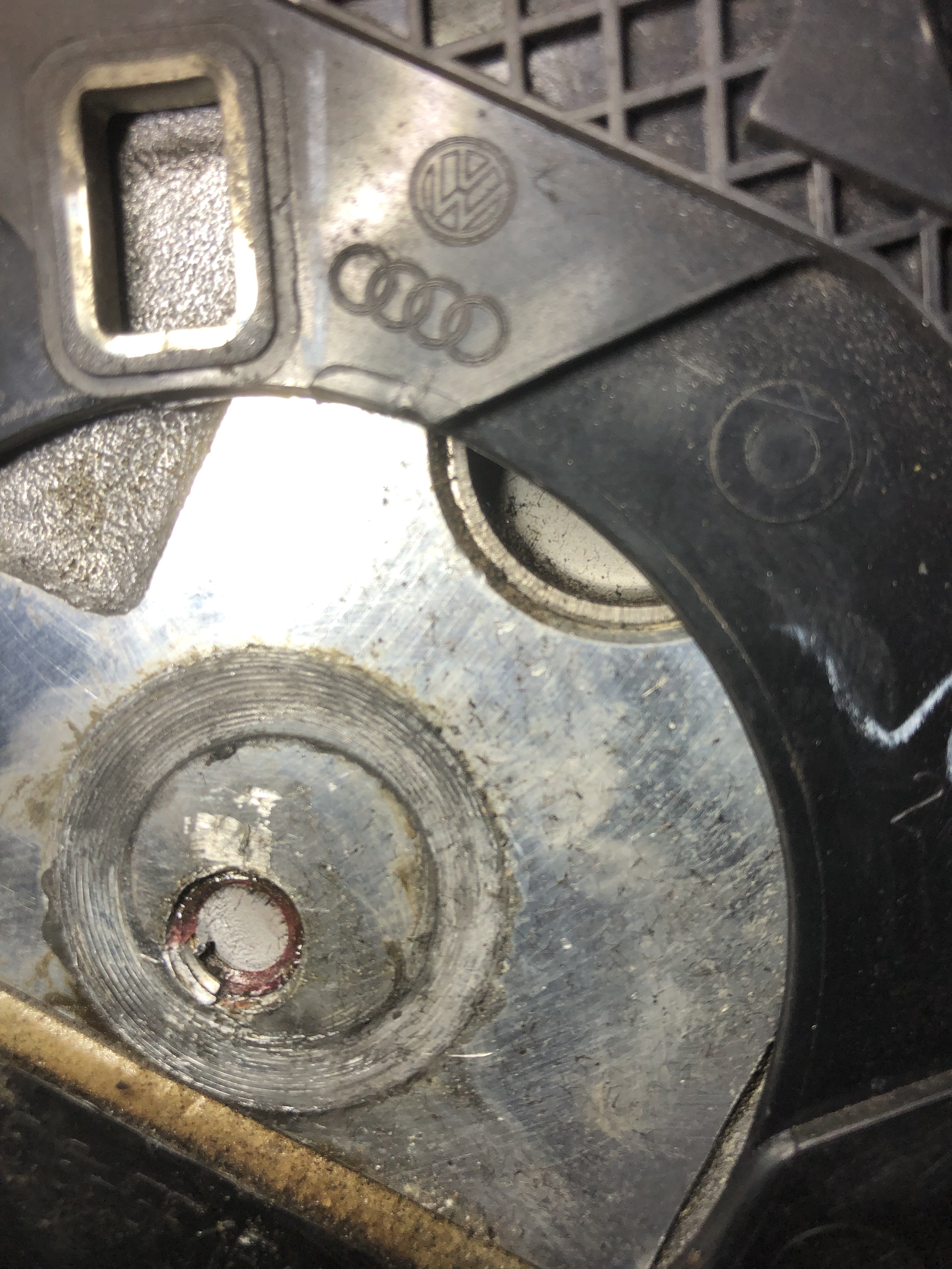

Sorry to post again, I've just looked at the images I took again, and I a) can see what I believe is some damage to the ring in this image but more concerning b) Is that a crack between the metalwork there or is it just the way I took the photo? Sorry to be a pain, thanks again.
Rear left brake dust shield escaped, killed abs sensor?
Hi all, Wondering if any of you could offer any advice? My partner on her return home from a night shift heard a noise and then was greeted by the traction control and abs lights on the dashboard. When I went out and removed the wheel to take a look, the brake dust shield (or what was left of it) had wrapped itself in around the disc. I've removed this and tried to clear the fault but it returns after a short while so I believe the ABS sensor is at fault (or at least I hope, because I guess the only other thing could be the reluctor ring being damaged), I've checked the voltage at the connector and it stays at battery voltage no matter how much I wiggle on the loom so I think the loom is okay. I went out and logged the wheel speeds reported and the rear left wheel dipped or deviated every so often from the other three wheels, but not rhythmically which makes me believe the reluctor is probably okay? (Please see attached graph image). The green lines are for the rear left ABS sensor. If anyone could offer any advice, or let me know if my thinking is sound I'd really appreciate it. Thanks so much for your time.

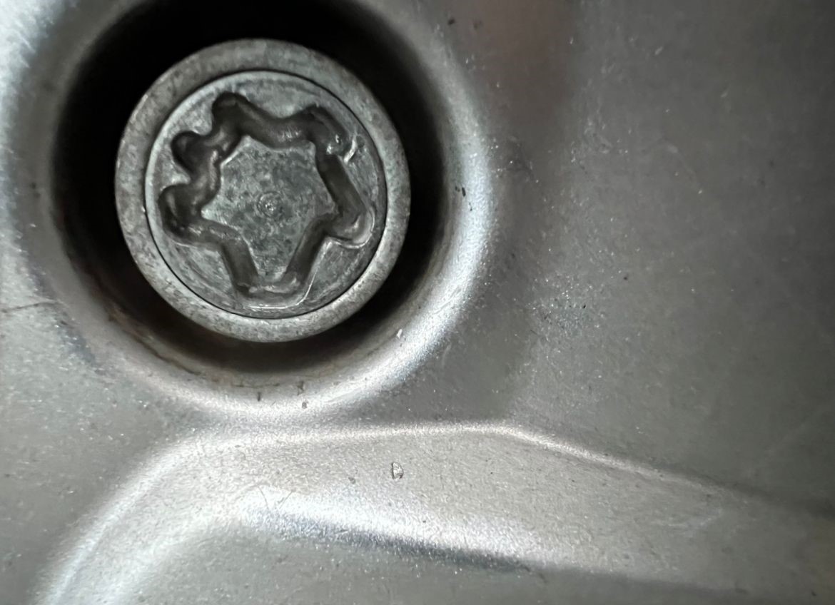

Hey all, Partners car is leaking brake fluid everywhere and I having gathered all my tools I went out to grab the locking wheel nut............ which is missing. After ripping her car to pieces I still can't find it, and am wondering if anyone here would know which code key I'd need to get the blasted bolt off! Have attached a picture in the hope that someone might recognise it... there are sellers on ebay that offer to match based on picture but I'd like to buy an OE one if possible. Thank you

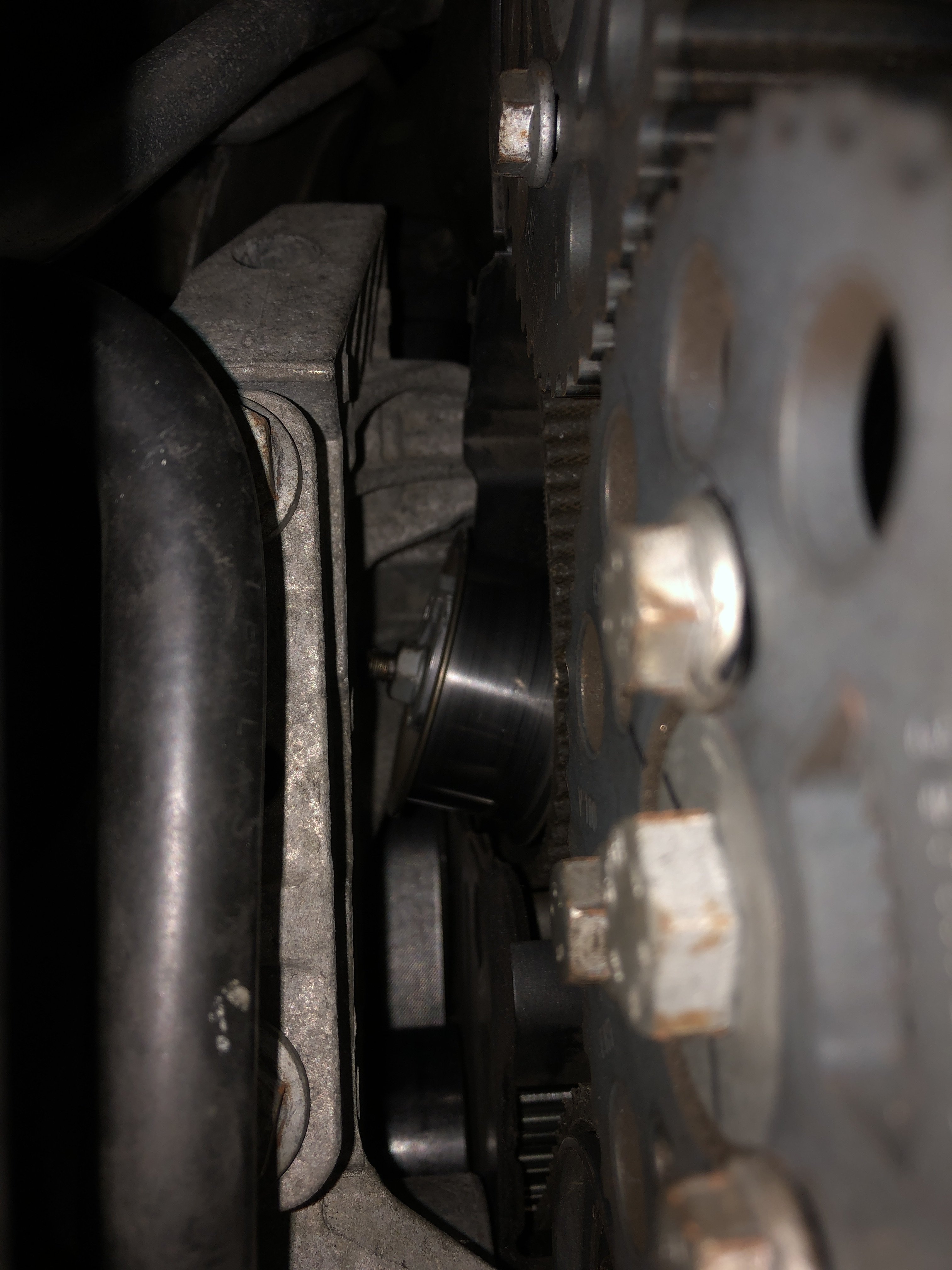

Dear all, Hopefully you won't mind this request for some advice - car is a 2.0 TDI with the BKD engine. Cambelt changed two years ago by (what was) a trusted garage. Inspection some time later under the bonnet made me realise it was a bit of a botch. The tensioner thread in the head stripped, so he had helicoiled the head (which I was aware of), but rather than use a typical stud, he elected to use a bolt which was too long........ so what does he do? Cut a slit in the cambelt cover to accommodate the bolt whilst putting the cover back on. Whilst driving my partner to work at the local hospital as she had laser eye surgery after her shift so couldn't drive (circa 70mph), I put my foot down to keep speed up a hill and there was nothing there.... no power nothing. Thinking it was limp mode and I needed to get off the dual carriageway I took the exit and upon coming to the roundabout and dipping the clutch the engine died. Having tried to restart it multiple times, eventually I gave up and called for recovery. Upon inspection at home, the bolt that he used has sheared off in the head which obviously means lost cambelt tension and after removing the cam cover, damage to what I believe are rockers / rollers. My question to you all is - Do I fix this? I've been advised by the local machine shop that the head is perfectly repairable and may need a few parts replacing. Car has just rolled over 100k and has been serviced well throughout its life. Second question, do I have any comeback with the garage that did the repair? I don't really want the confrontation, but because of his 'repair' I now either need to front up the cash for this or replace the car. Neither is preferable, and with the price of used cars still stupidly high, I think repair is the only option. Final question - I'm handy with spanners, have haynes (ha) manual, would you attempt this yourselves or get a garage to do it? Will try and attach some photos! Head rebuild would be done by engine centre, I don't have the tools or expertise to do that for sure! Thank you all
