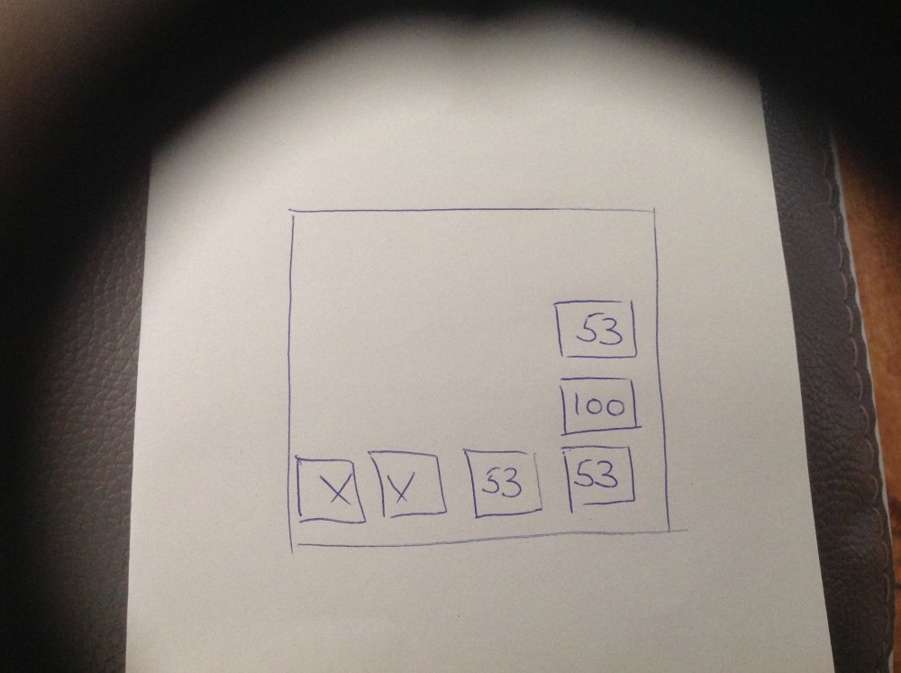

  9. Can someone tell me which relay is it for the fuel pump. This diagram is one I posted earlier on this page ofnthe relays under the steering wheel. Having some problems with the engine cutting out whilst driving after it's taken a wee bit longer to start. It's done it a few times so while trawling through the posts on here someone suggested it could be the fuel pump relay at fault. Putting the key to the off position and leaving it for a minute or so it starts again no problem when switched on. Someone suggested it this may reset the fuel pump relay. Someone very kindly tried to help when it cut out yesterday - he was a recovery driver - suggested the problem was fuel related. No faults have been recorded when attached to diagnostics.
