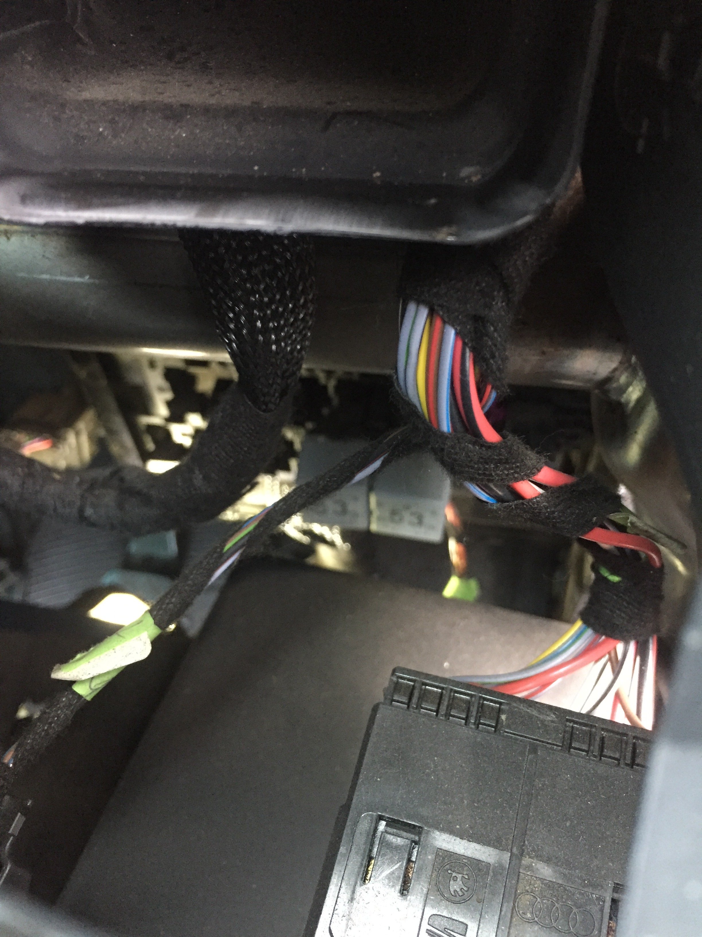

Ok he's not dismantled anymore of the dashboard than necessary as he managed to get behind it and pull the 100. attached is a diagram of what our relay board looks like. The 100 relay does appear not to be working however. Theses are the only relays on the board.- relay number 100 - is this the relay for glow plugs
hes just had a look and the relays dont appear to be set out as per your diagram - the 53s seem to be on the lower edge and the 100 was above this. is he looking in the wrong place?- relay number 100 - is this the relay for glow plugs
We don't seem to have relays like your diagram - unless they're located elsewhere? These ones on my picture are behind the steering wheel.- relay number 100 - is this the relay for glow plugs
Sorry are those the fuses? Attached is the relays he got - 2 no. 53 in a row and the 100 relay was above.- Intermittent Starting Problem
